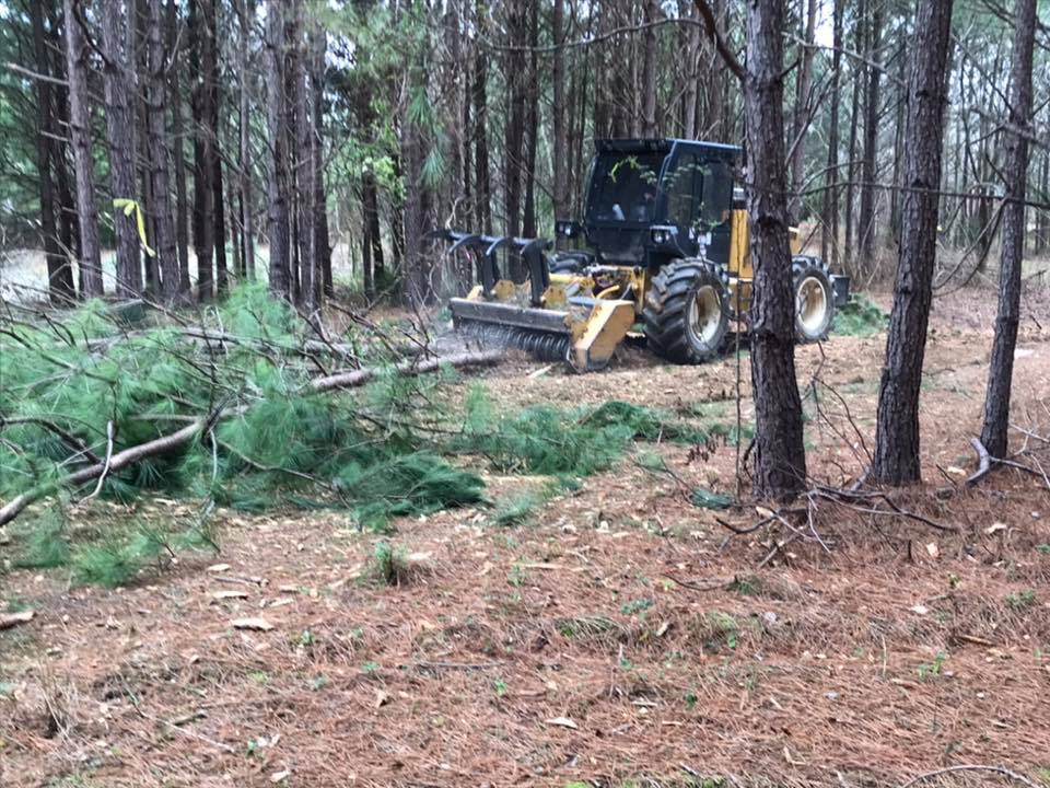

If you really don't want to disturb the topsoil much I think a larger forestry mulcher is the way to go for 50 acres. Doing that with skid steer mounted mulcher will take hundreds of hours. Likely 1-200 hours in ideal conditions. If conditions are poor much longer.
It would also be reasonable to do it with a 20 ton excavator and then stack and burn everything you can't use but again 50 acres is going to take much more than a large mulcher and you then have to deal with a HUGE amount of trees to chip, burn or truck off.
Agreed. They did acreage for me with one. Stumps are ground right to about ground level. If you arent going to be tilling the soil I wouldnt worry about digging stumps up. Lots of time involved there.
These are who did mine. they are probably a couple of hours from you.
i have access to trackhoes and dozers and can run them myself but I choose them to come mulch it instead.
