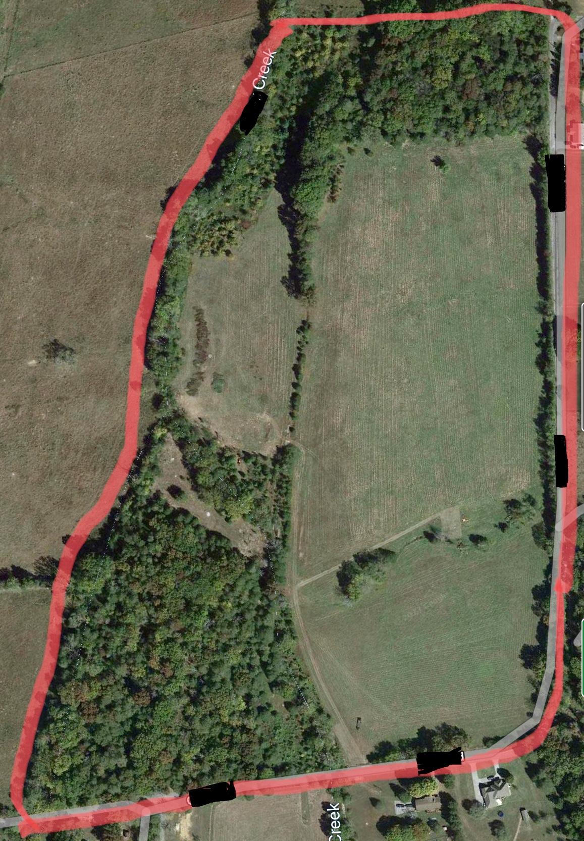

It's been very long since I posted an update. Fifty acres; about 35 acres of pastures and 15 acres of woods. The 35 acres of pastures were not maintained for decades by the previous owner. We have the pastures cleared but are still waiting to build a house and barn (COVID, worst inflation in 40 years, ~7% mortgage rates). The attached photo is from September 2022.
