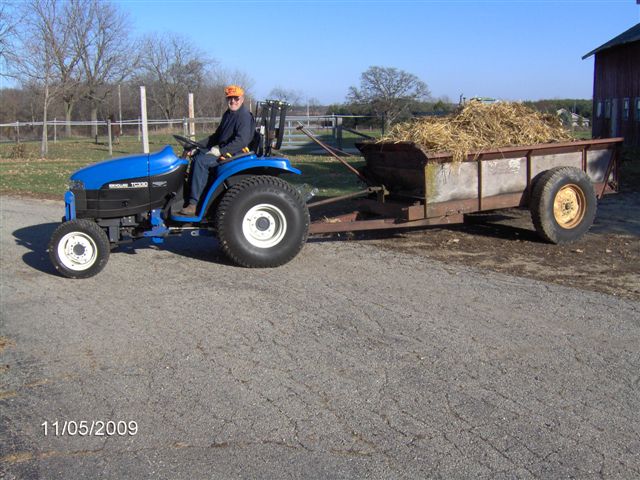

I went to an auction that also direct sells prior to the auction and picked up a JD, Model N as I recall, drag type poop slinger. Made for things like cleaning out dairy stalls with a FEL, dump the poop into it, haul it out where you want to disperse it and let it go.
It's a pto driven (turns the slinger) with ground drive, for running the chains and horizontal bars across the floor to move the poop to the rear so that the slinger can sling it. Paid like $700 for it. Put a "ladder" chain link (TSC supplied) on it and straightened a cross angle iron bar and that's been the upkeep for some 15 years.
