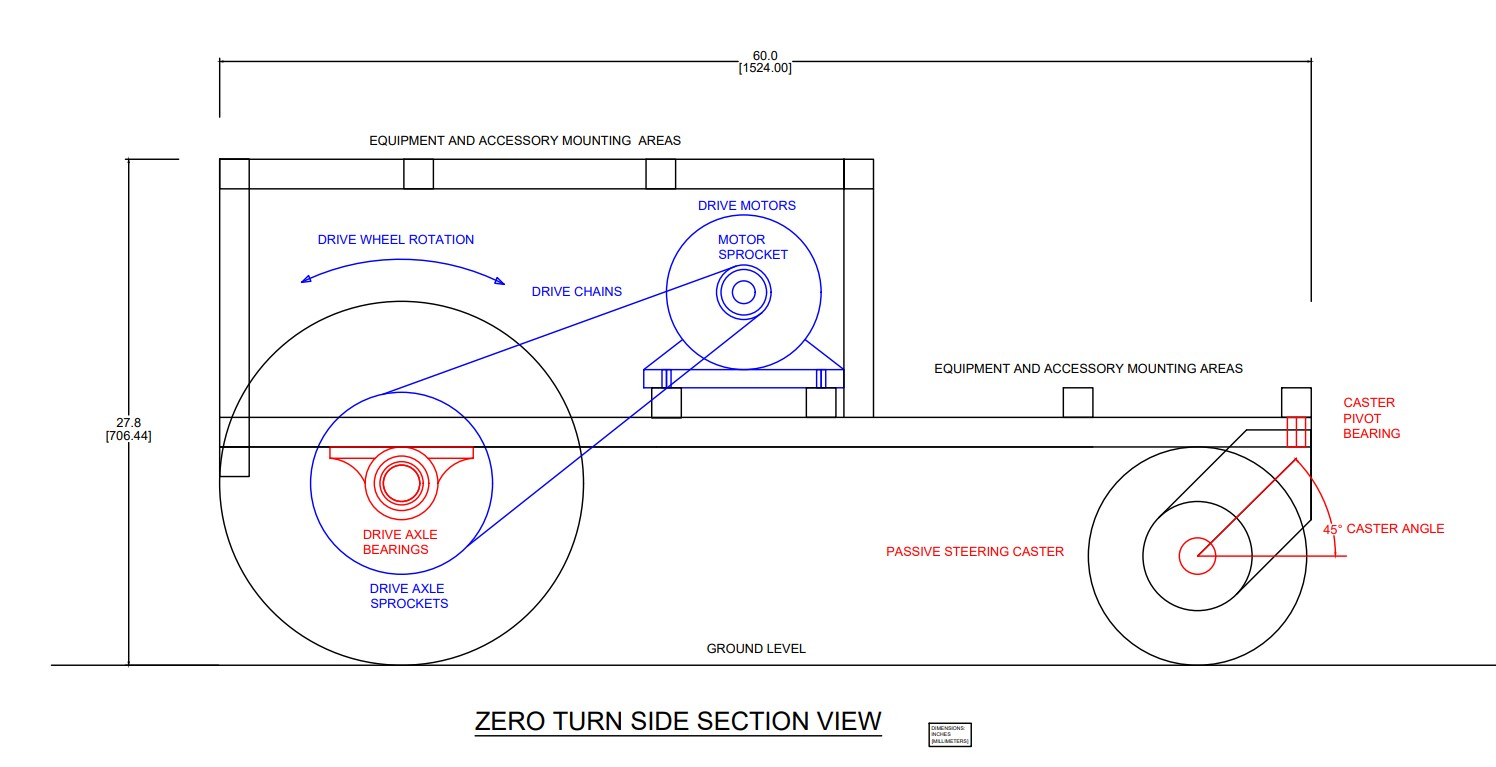

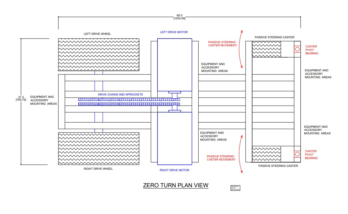

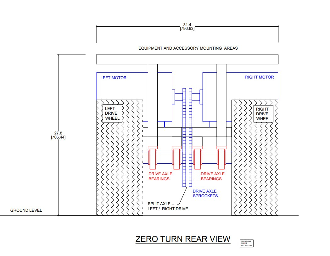

Here is the First Draft on Zero Turn.
Comments, Suggestions, OMGs all welcome.
Here are some notes ==
+ Steering Caster may be too much -- maybe more vertical?
+ Drawn with 20 inch tires. Frame is spaced to handle up to 24 inches.
+ Drawn with 1:5 Sprocket Ratio == motor nominal RPM is 1200 RPM.
+ Bigger tires may be better -- however, the larger the diameter, the more I have to gear down the sprockets.
+ Maybe the Drive Wheels should be "Front?" Lets it climb over things easier.
+ Over all dimensions are just what turned out. Trying to keep width under 3 feet to let it get through narrow paths, doorway, gates, etc. Could cut length down to 4 feet -- just trying to prevent it from flipping backwards with a pulling load.
Add on Edit -- Brakes. I am planning on using VFDs as load regeneration to stop either or both motors -- BUT -- I see I still need Emergency and Parking Brake(s). Looks like the left and right split axles may be the place to put those.

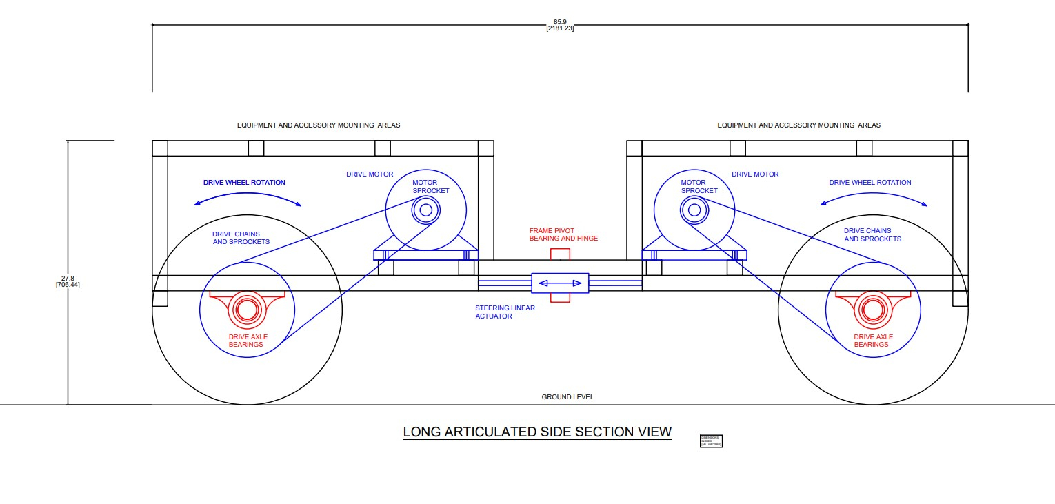

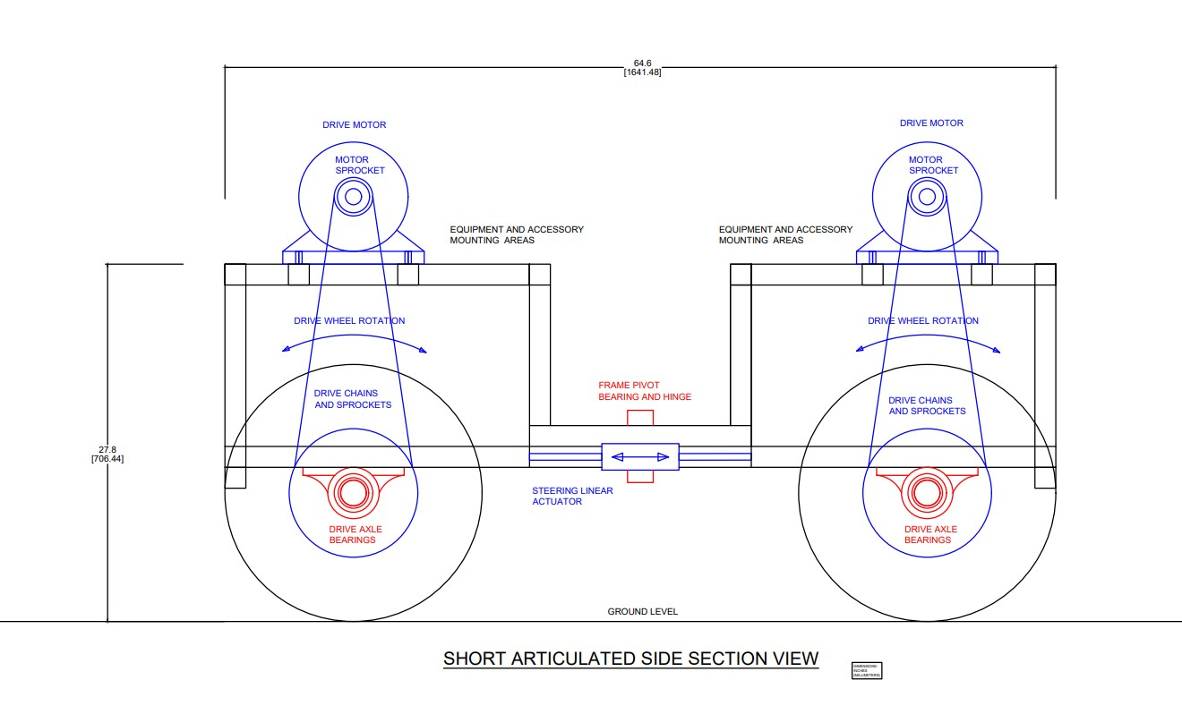

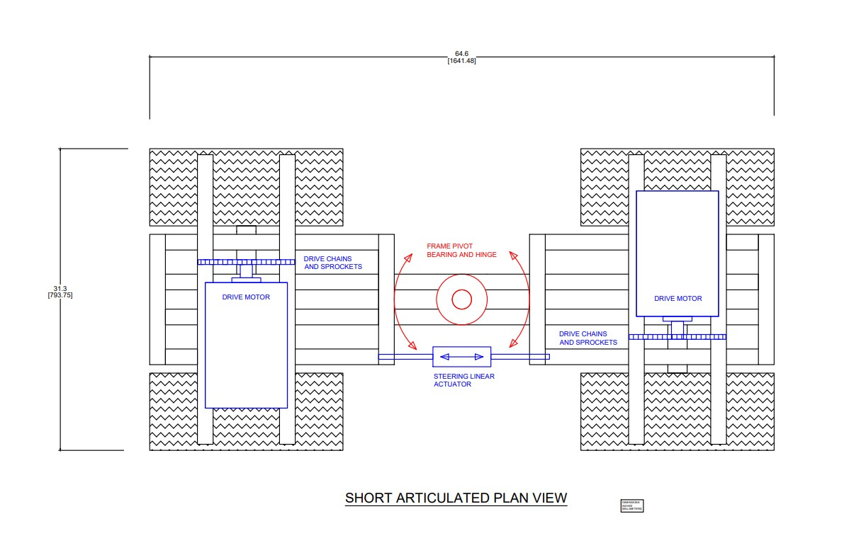

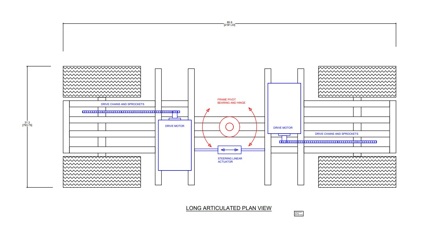

Next up . . . .
So that last one was the Zero Turn.
This one is the Articulated (Folding or Hinged) Frame.
Still has (2) Drive Motors -- but now is 4 Wheel Drive. That seems like quite a productive improvement.
Adds a Steering Linear Actuator -- sort of works like a two-way piston -- but that also means I can lose the Steering Casters.
Did two rough designs -- a sort of "long" one, based on a portion of the Zero Turn frame and motor mount, and a "short" design that comes closer to a model of a mini-front-end-loader.
As with the Zero Turn, I need to add Emergency and Parking Brakes, which can mount on the solid side-to-side drive axles -- which have more room to work than with Zero Turn split axles.
The center pivot and bearings, I have not done any real details on yet, and the same lack with the Steering Linear Actuator. I think some designs use (2) single action pistons (?). Dunno, will have to study the State of the Art and Best Practices a bit more.
Again, any comments, edits, suggest, or cautions are welcome.

   / Best Steering / Frame / Tractor Combo -- for Robotic-Electric. #20
What about differentials on the articulated design?
