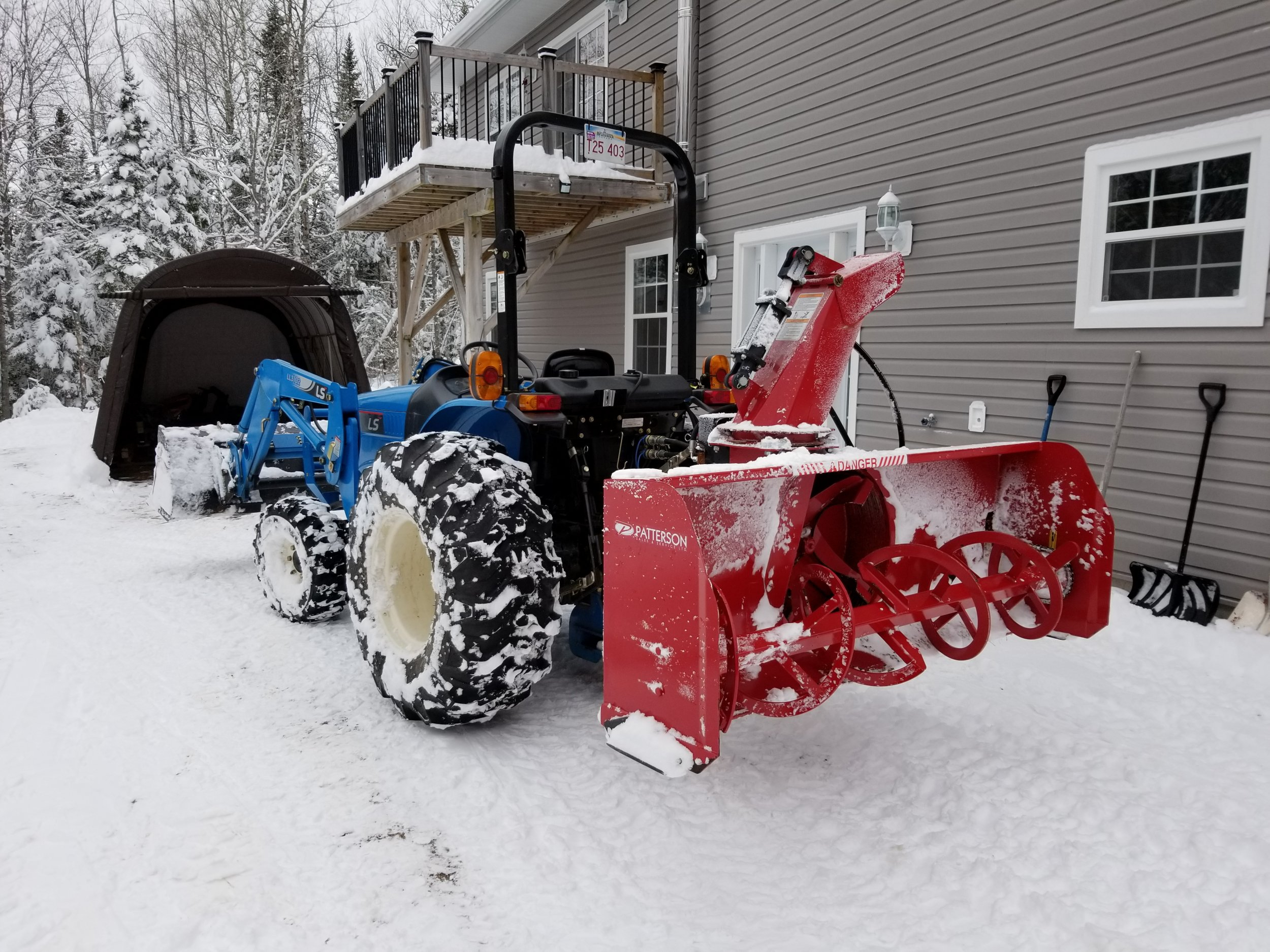

72 inch fully hydraulic Normand blower from Pattersons on my 33 hp HST LS tractor . zero issues , never bogs me down and throws snow pretty far. Your tractor should handle this with ease .

You have guts...lol snow blowing on a cabless unit is tantamount to snowmobiling.

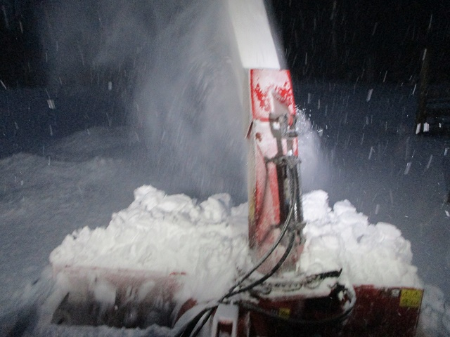

The hyd spout tip makes a world of difference on an open station. My old blower didn't have it, new one does.
I have open station as well, huge reduction in snowman effect with the spout tip, helps control the snow much better and lowering it even keeps the snow below your seating position on the tractor.
