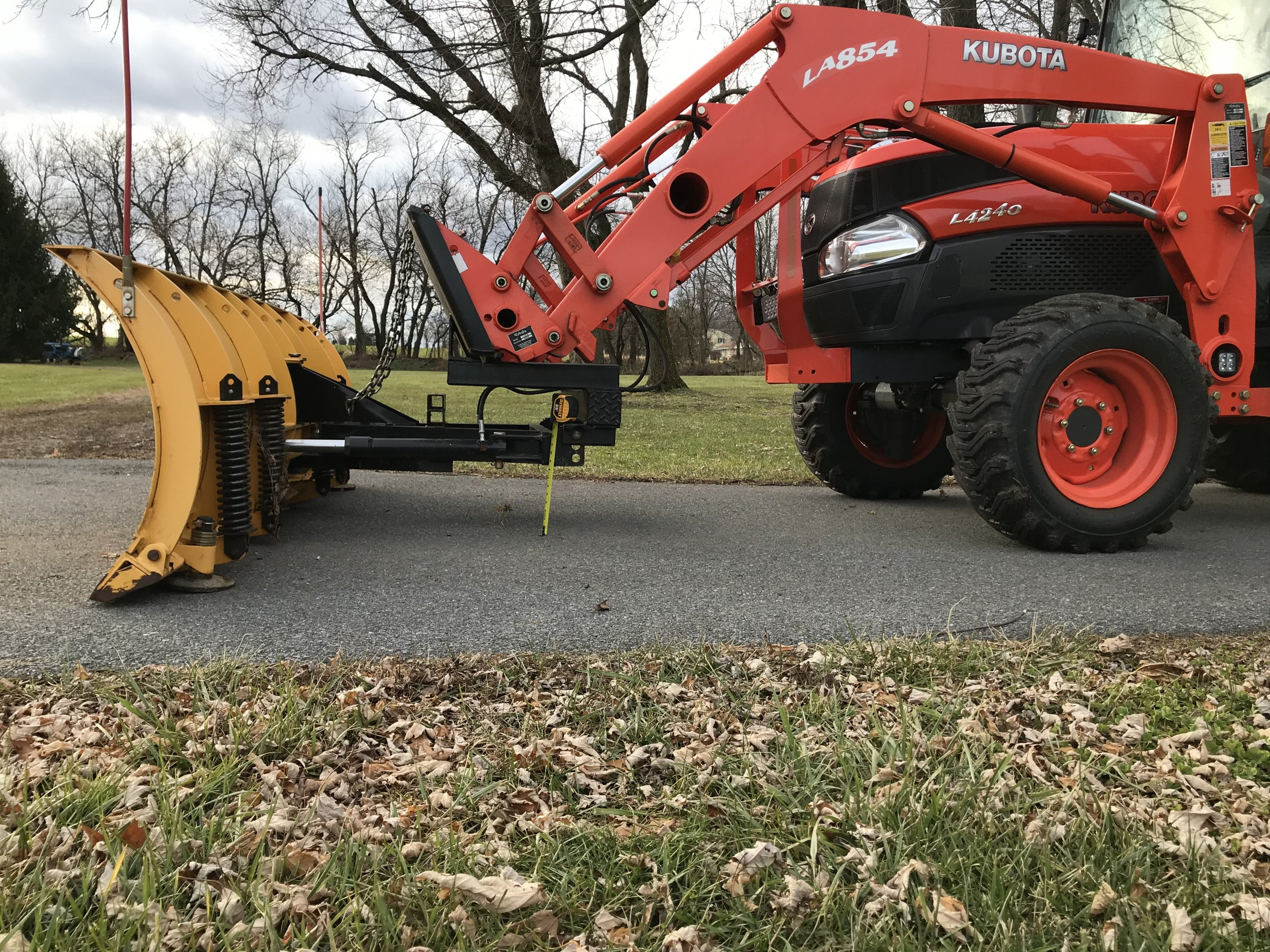

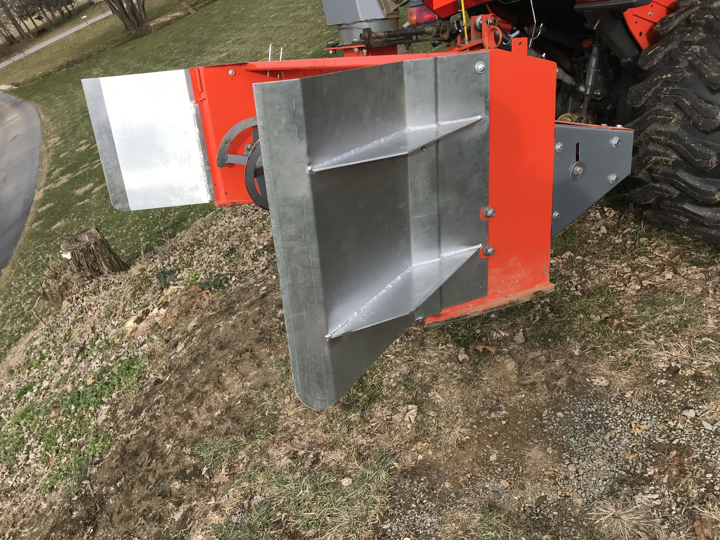

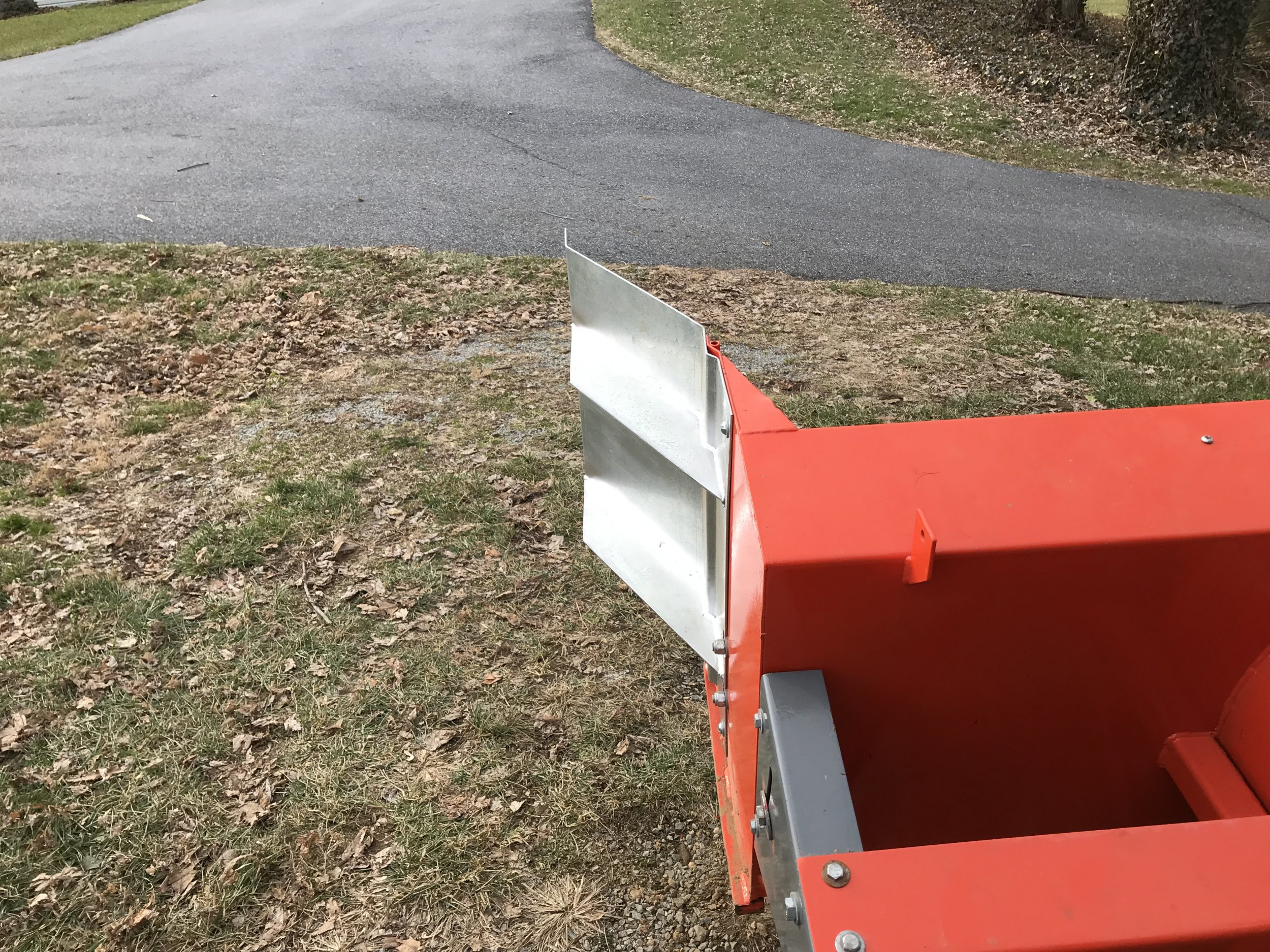

I had a Provovost Puma 64" that worked well. To get a wider path, I fabbed a pair of reinforced bolt-on wings. For the areas I clear, the blower wasn't the answer. It was replaced with an "underslung" mounted 8' Fisher plow from a truck.
Chim -
Can you explain what the advantage of an "underslung" plow is (as opposed to just mounting the frame directly on the SSQA)? Is it just that it lets the blade float more easily than if it were mounted directly on the FEL arms?
I've been debating getting a plow for my tractor fro years now, but never made the jump.
   / Best snowblower width for 35hp, 62" wide tractor #16
. . . the advantage . . . Is it just that it [an "underslung" plow] lets the blade float more easily than if it were mounted directly on the FEL arms?
Exactly. For a more thorough discussion of the geometry, listen to this guy:
Admittedly, it is a sales pitch, and I bought into it. With the blade floating I can steer without playing with the FEL; with the blade locked, I can steer only by lifting the blade enough to transfer weight to the tractor front wheels. DIY fabricators can achieve the float with the "underslung" method using a pick up truck plow frame as Chim did.

Chim -
Underslung results in a straight line push while mounting onto the FEL arms tends to create a lifting action as the pivot point is high up and that takes weight off of your steering.
You'll observe that on plow truck blades they always provide 3-4 mounting holes provide adjustment.
Old time tractor plows often had long pusher rods/tubes that clamped onto the rear axle housings which solved that straight push geometry.

Just fab up a set of wings for the blower from 1/4" steel with gussets. Issue solved.
