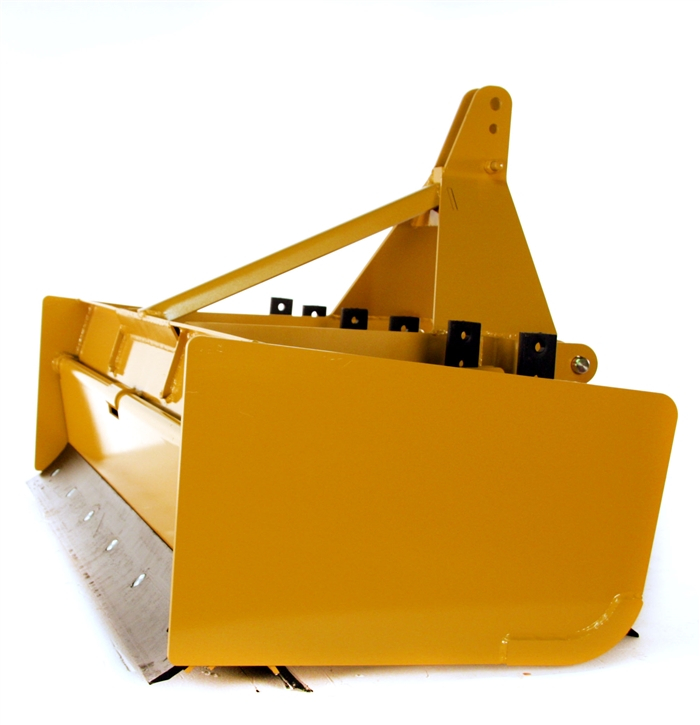

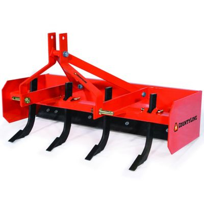

Also consider the style.
Basic:
Floating or Hinged Back
