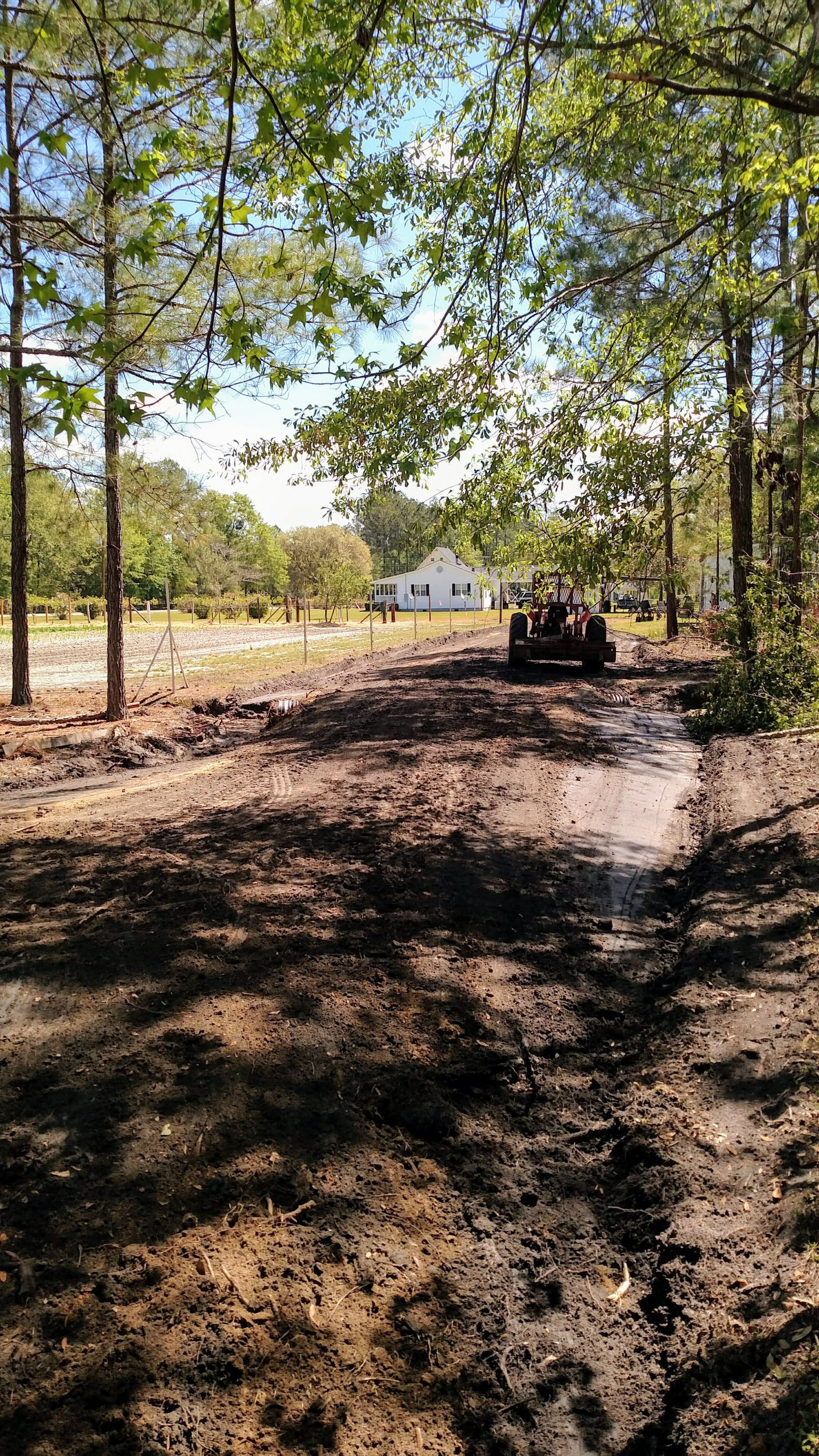

Little drive I cut in and crowned.. with rear scrape blade

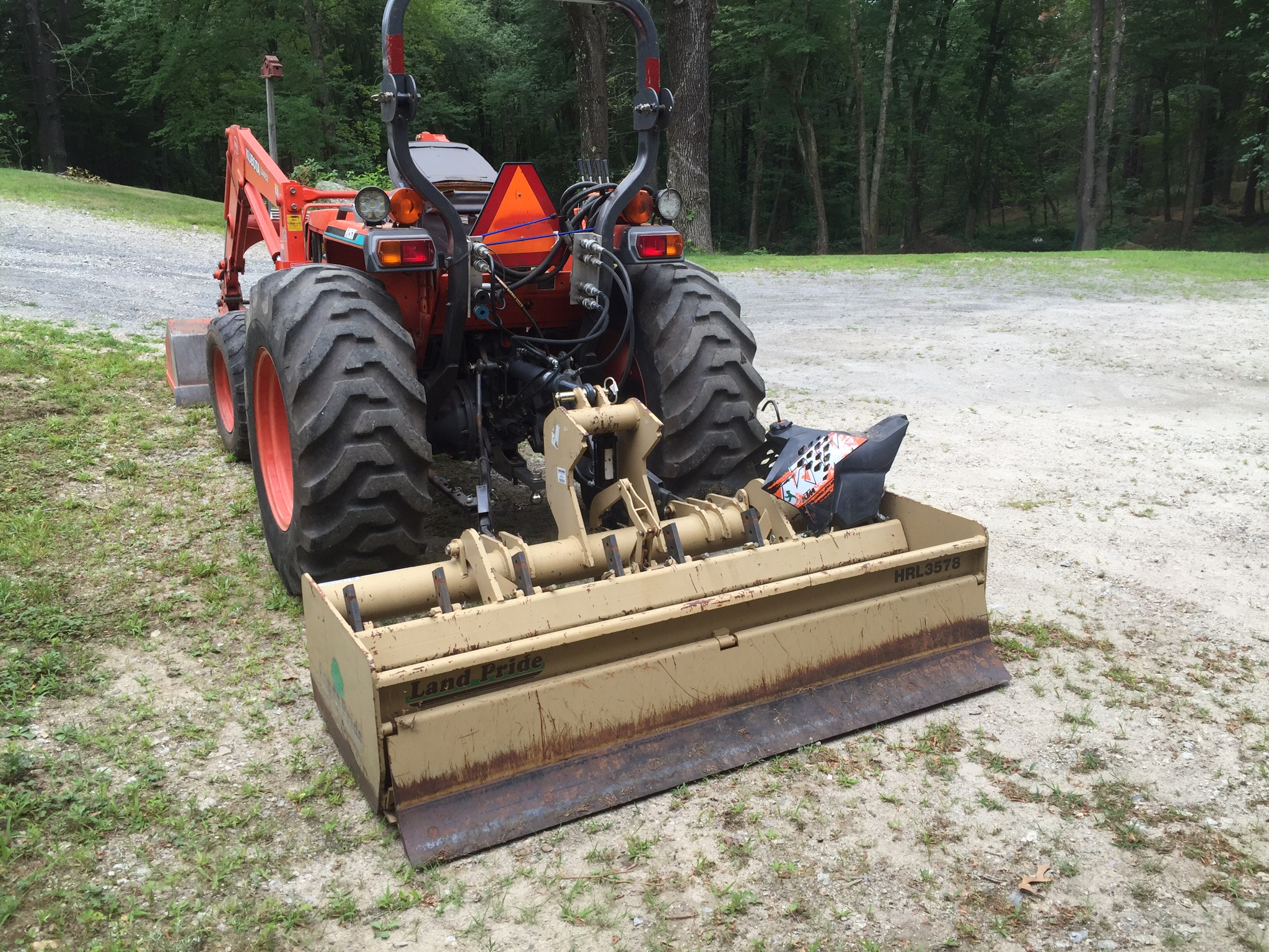

That is a good question lol. I started with a Landpride HRL3578. That was a GREAT box blade and I had no legitimate reason to upgrade.
After doing some pretty extensive land clearing with it, and building basic roads, I did wonder if more weight per foot would work better.

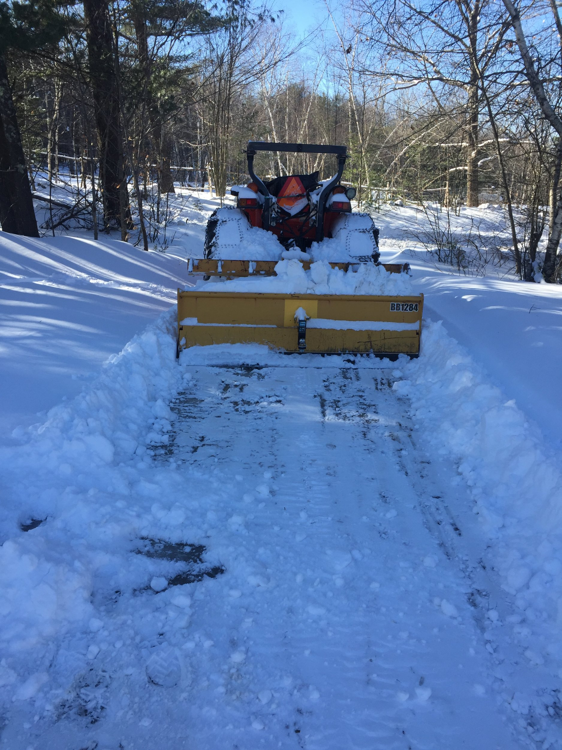

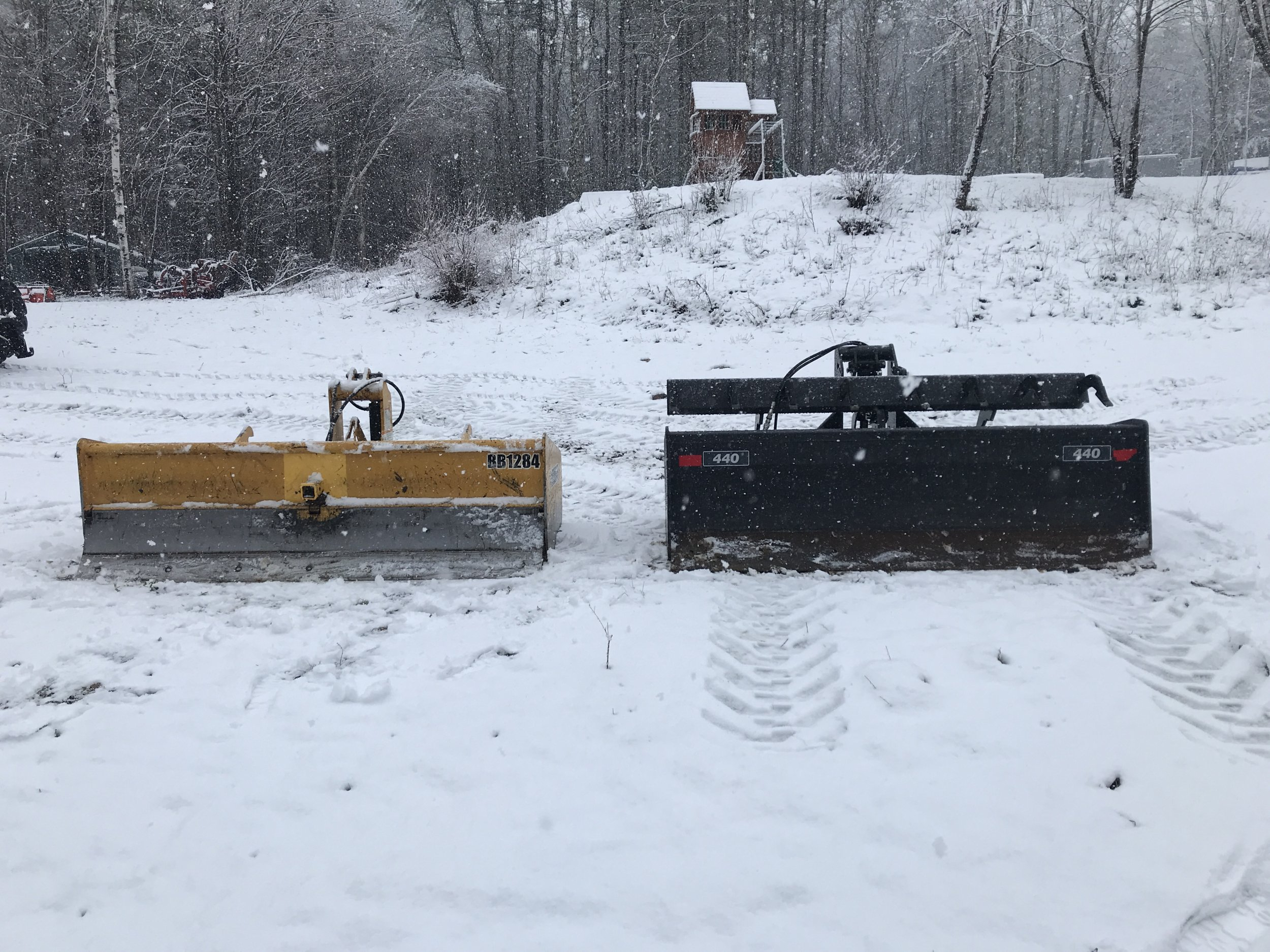

I ended up finding a very low priced Frontier BB1284 which was 6” wider and about 300 pounds heavier.
It just so happened that the same guy had a 72” rollover box blade for cheap as well.
So I bought them both.
Then I tried out the rollover box blade and hated it (to be fair, I only bought it to flip) and then sold the Landpride and rollover and made a decent profit.

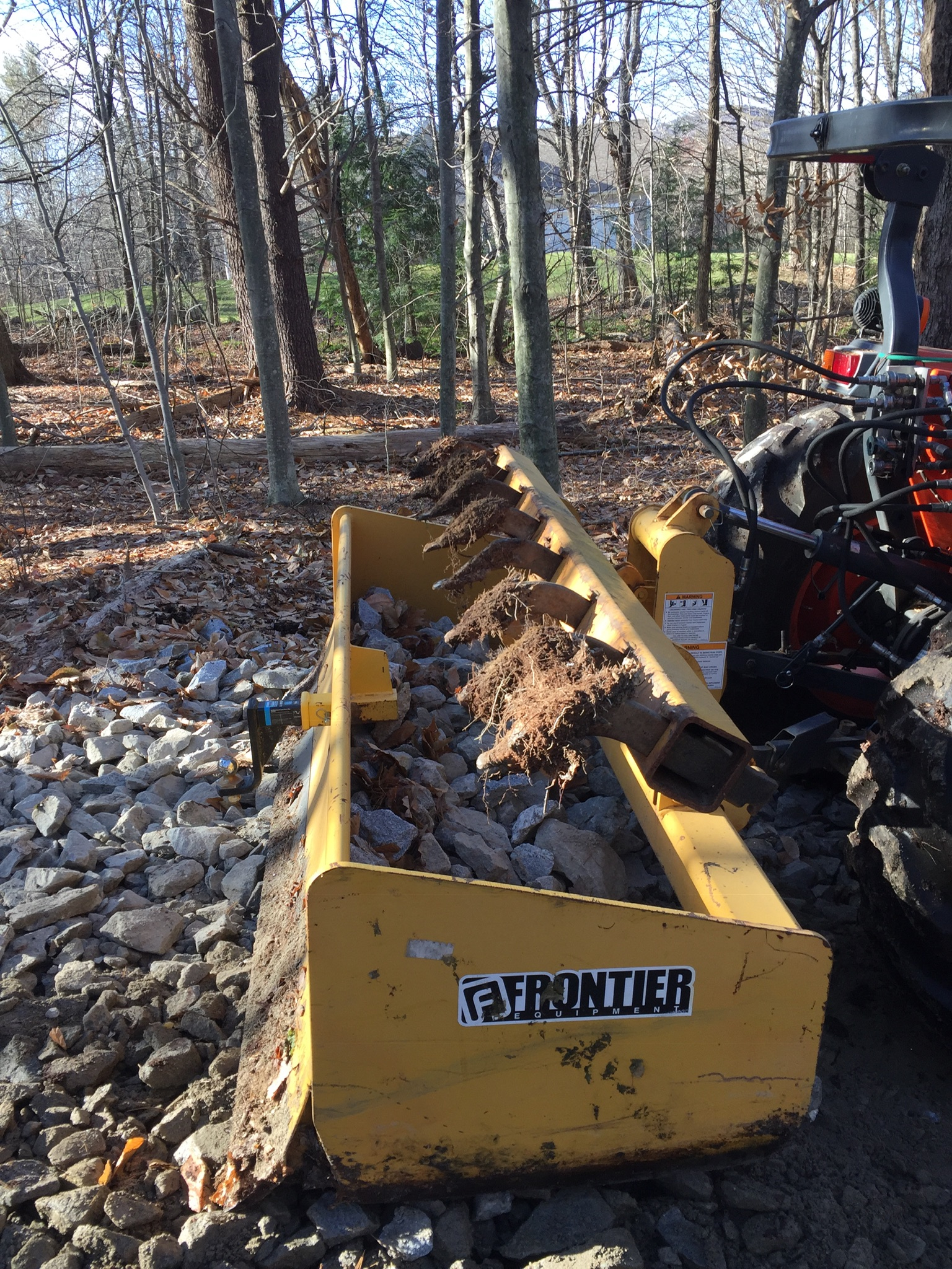

I was perfectly happy with the Frontier. It is the perfect match for my tractor and it weighed enough to be very useful in every situation I used it for. I added a rear hitch to it and moved around empty trailers often. I loved it, and I only had a few hundred dollars of my own money into it.
The ONLY thing I REALLY disliked about it, was that it wasn’t quick hitch compatible and during some major dirt work project I had going on, I found myself changing between the box blade, power rake, and rear blade very often. The BB was a PIA since the others were QH comparable. (First world problems here).

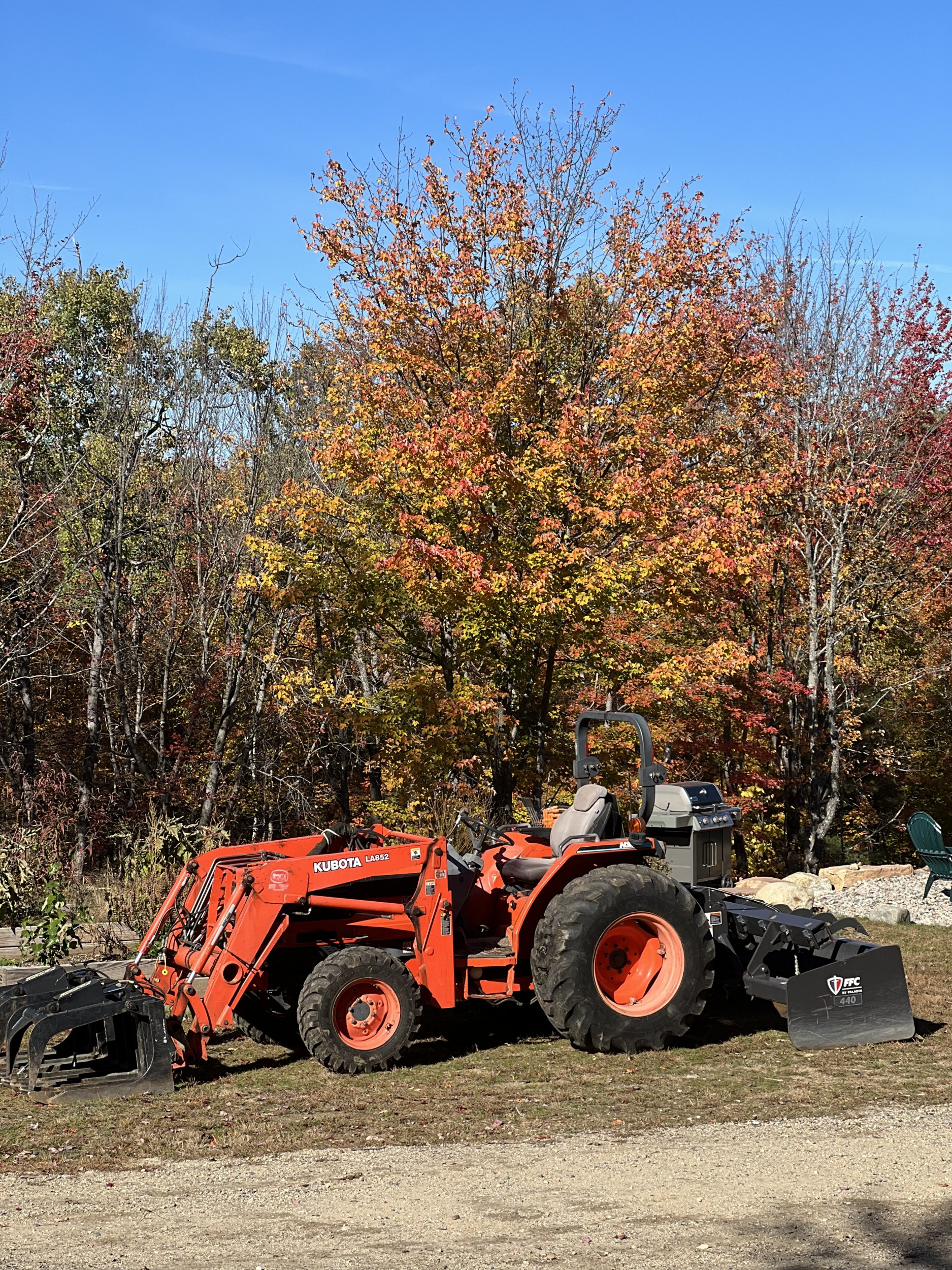

Then I just happened to come across another very good price on an even heavier box blade (at that point I didn’t know there was anything heavier). So I picked that up because it was quick hitch compatible. This one is a Paladin FFC 440 at 1,600lbs.
It is, as you can imagine, a beast of a box blade, and really is designed for a larger tractor than mine, obviously.
If the Frontier was QH compatible I would still have it. It is the sweet spot of perfection for my size tractor.
