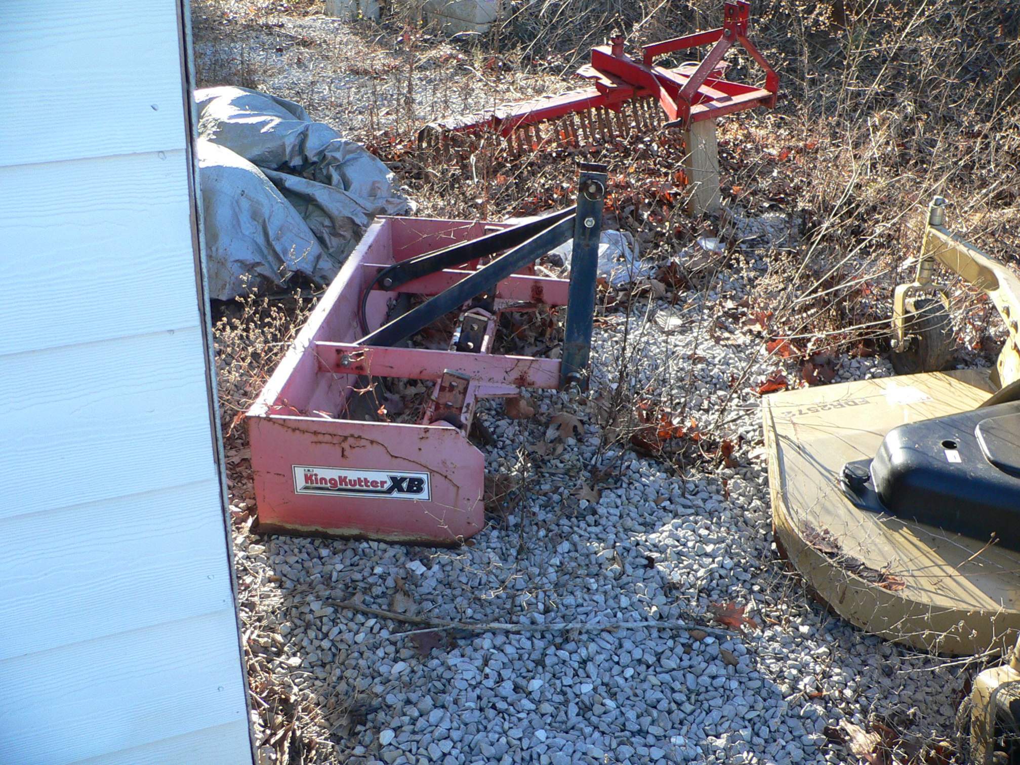

Here's what I've used on a B7800 and BX2660 and my nephew has used it on his BX2360. Yes, it's been outside for 5 years. I guess it's 48".

I use a KK XB 48 behind my BX2660. As stated earlier, if you hook a large root, the front end will come off the ground. I made a weight rack on it, but never was in hard enough ground to need to add weight. I use it on the trails in the woods. I also remove the teeth and use it as rear weight and a scraper blade in winter. It works awesome for this. It is slightly narrower than the snowblower, so it cleans up any packed snow and carries it instead of just spilling off the sides.
