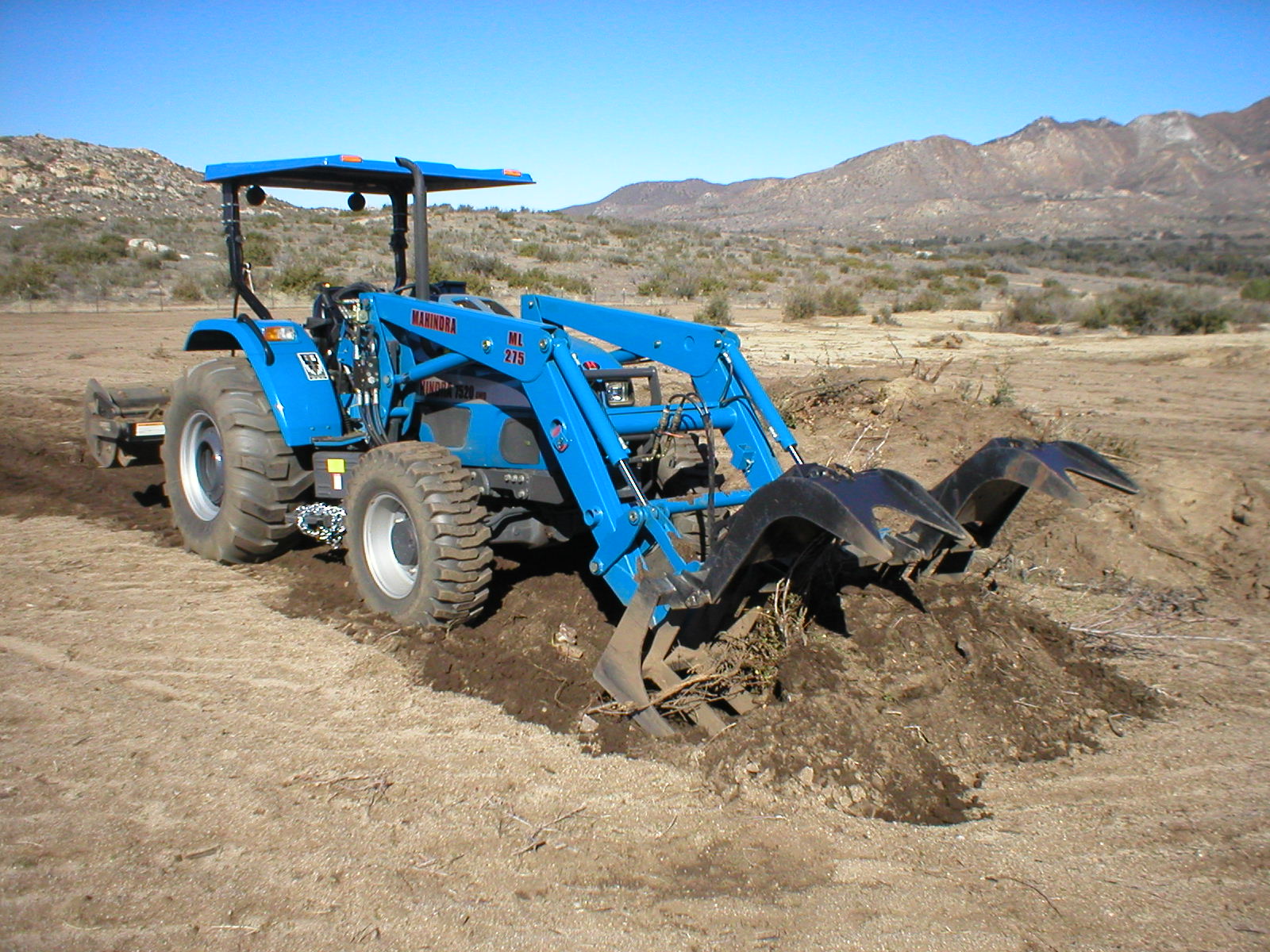

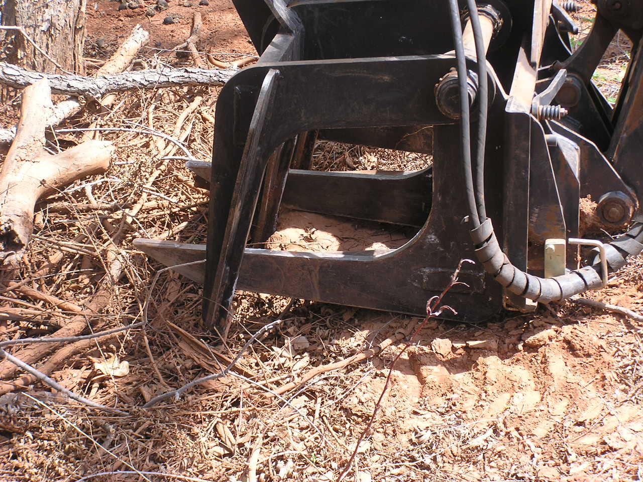

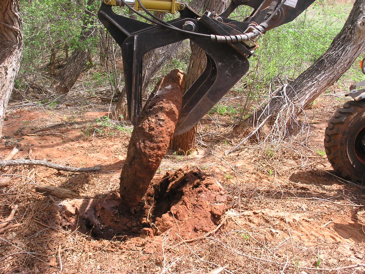

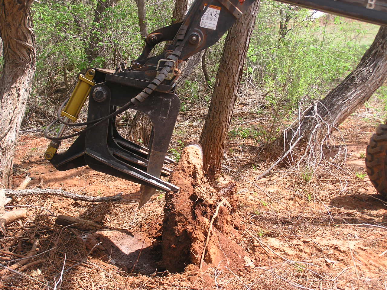

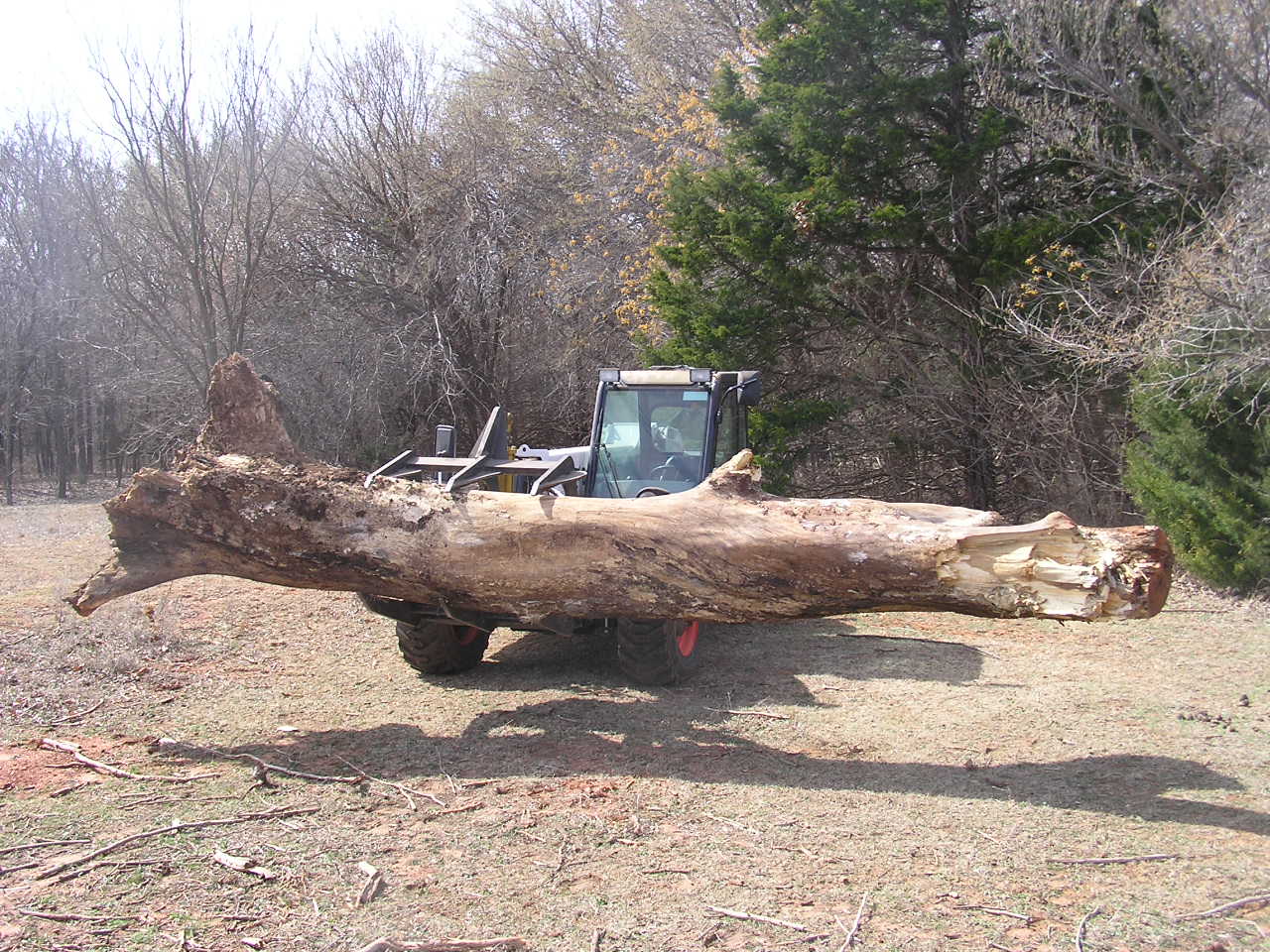

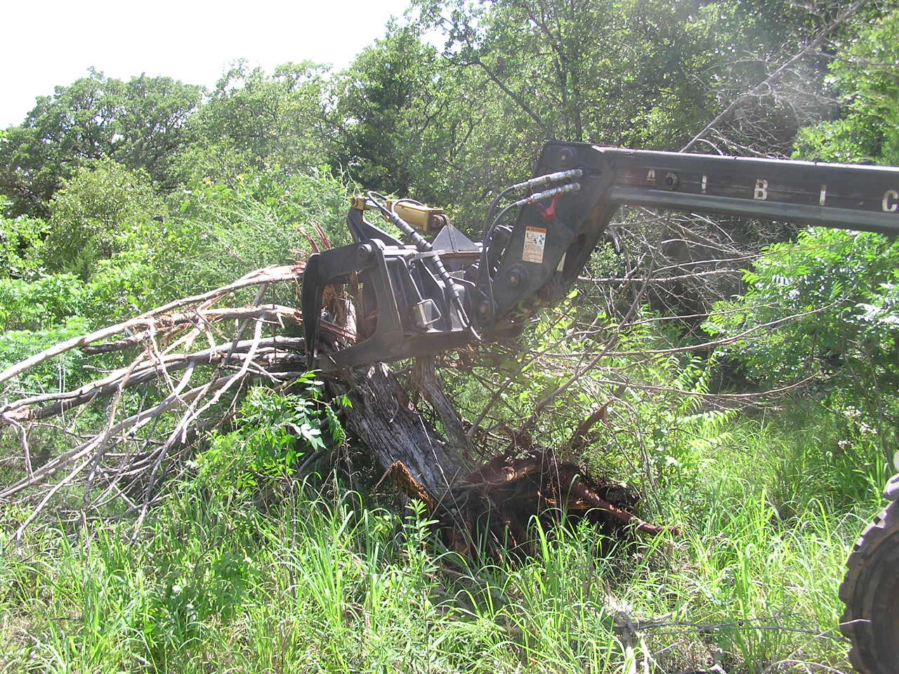

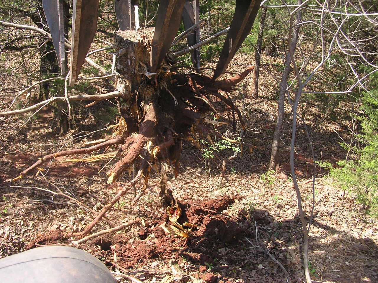

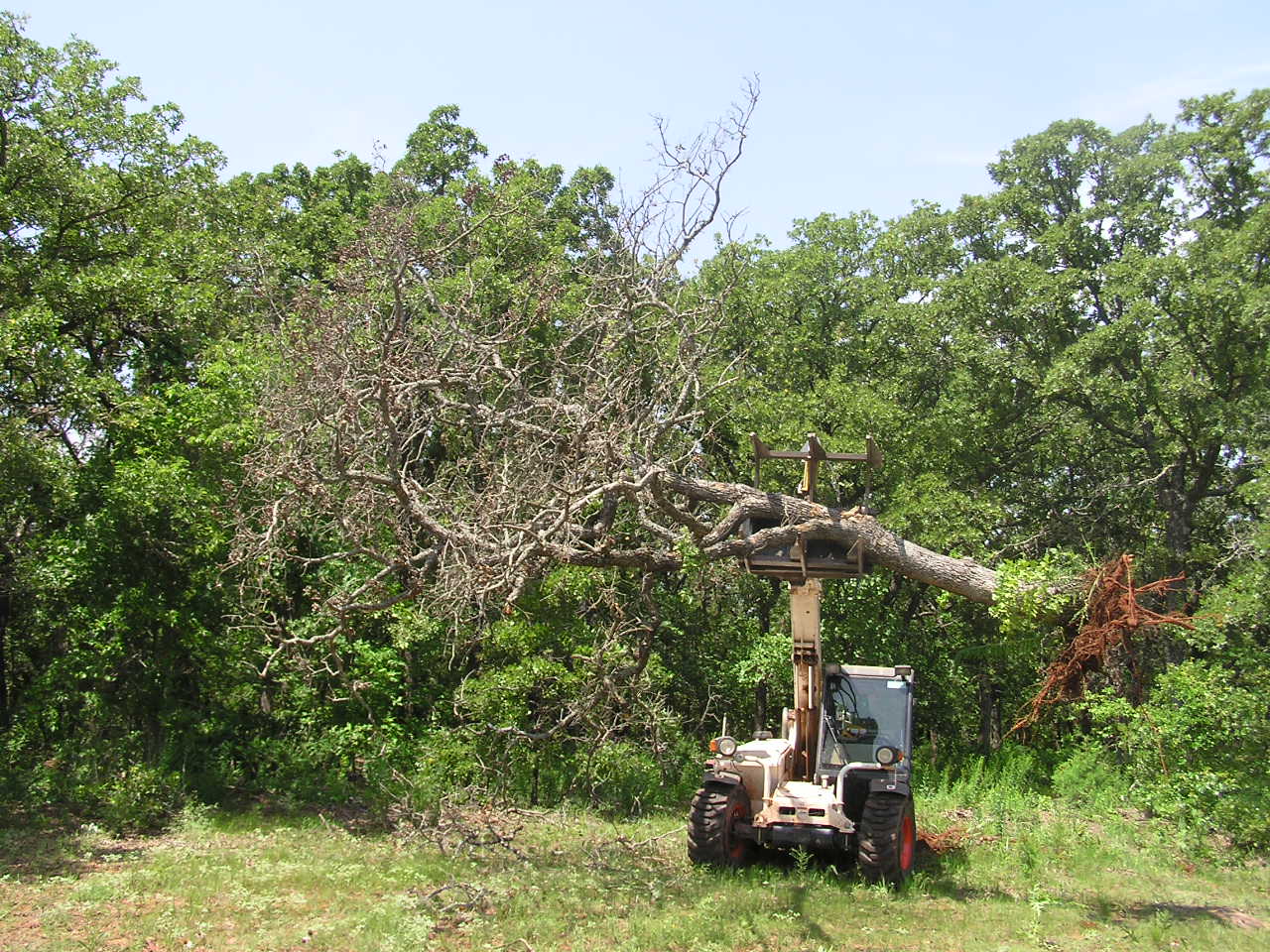

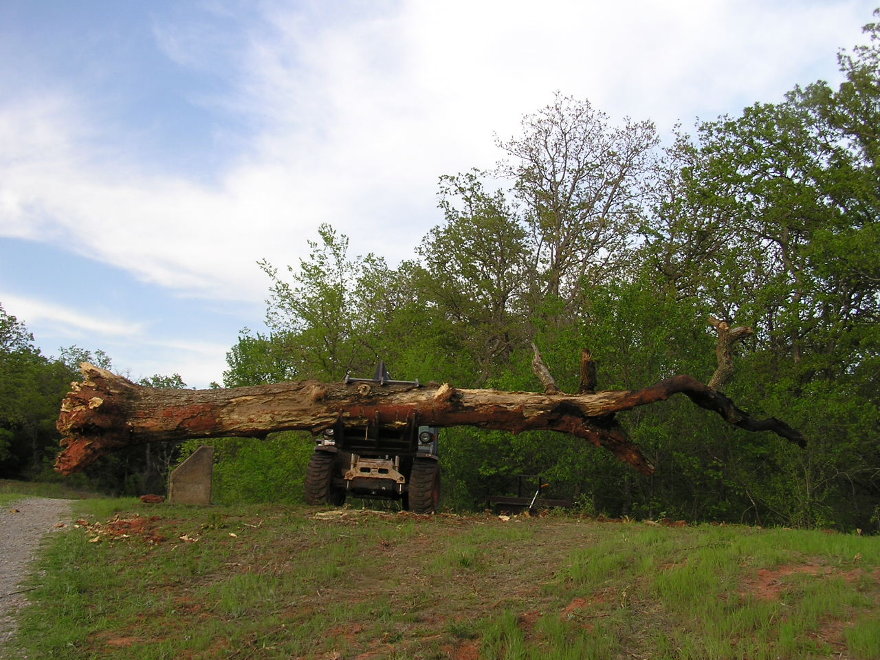

This is the one that I have. The 81" unit. They did not have the extreme duty unit 10 years ago. The heavy duty unit has worked fine for me and my tractor is 12,000lbs and has a lift capacity of 3900lbs to full height. If I remember correctly, the grapple weighs about 900-1000lbs.
Many people say to go with a narrow unit, my thinking is that it really depends on what you are doing and of course the capability of the machine that it is going on.
I've cleared roots from several acres by moving along with the tips in the dirt about 8" down.
They all seem to work pretty good, but prices are at a very wide range.
Good luck with your final decision. ;)

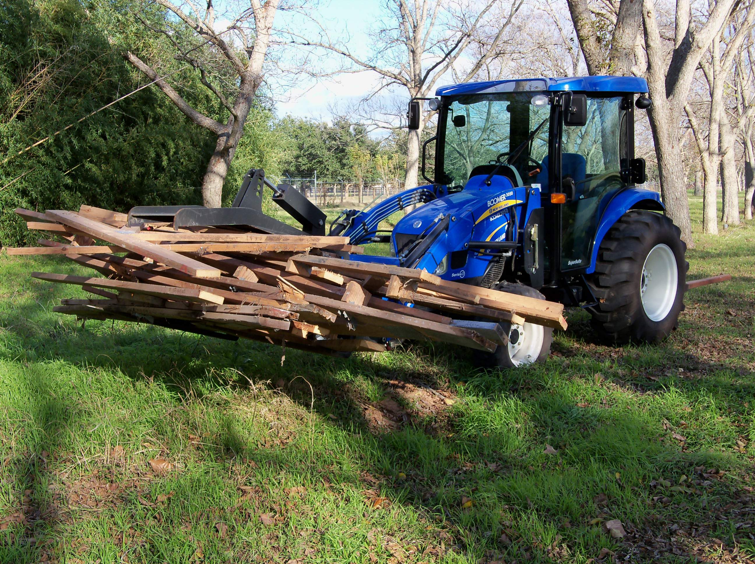

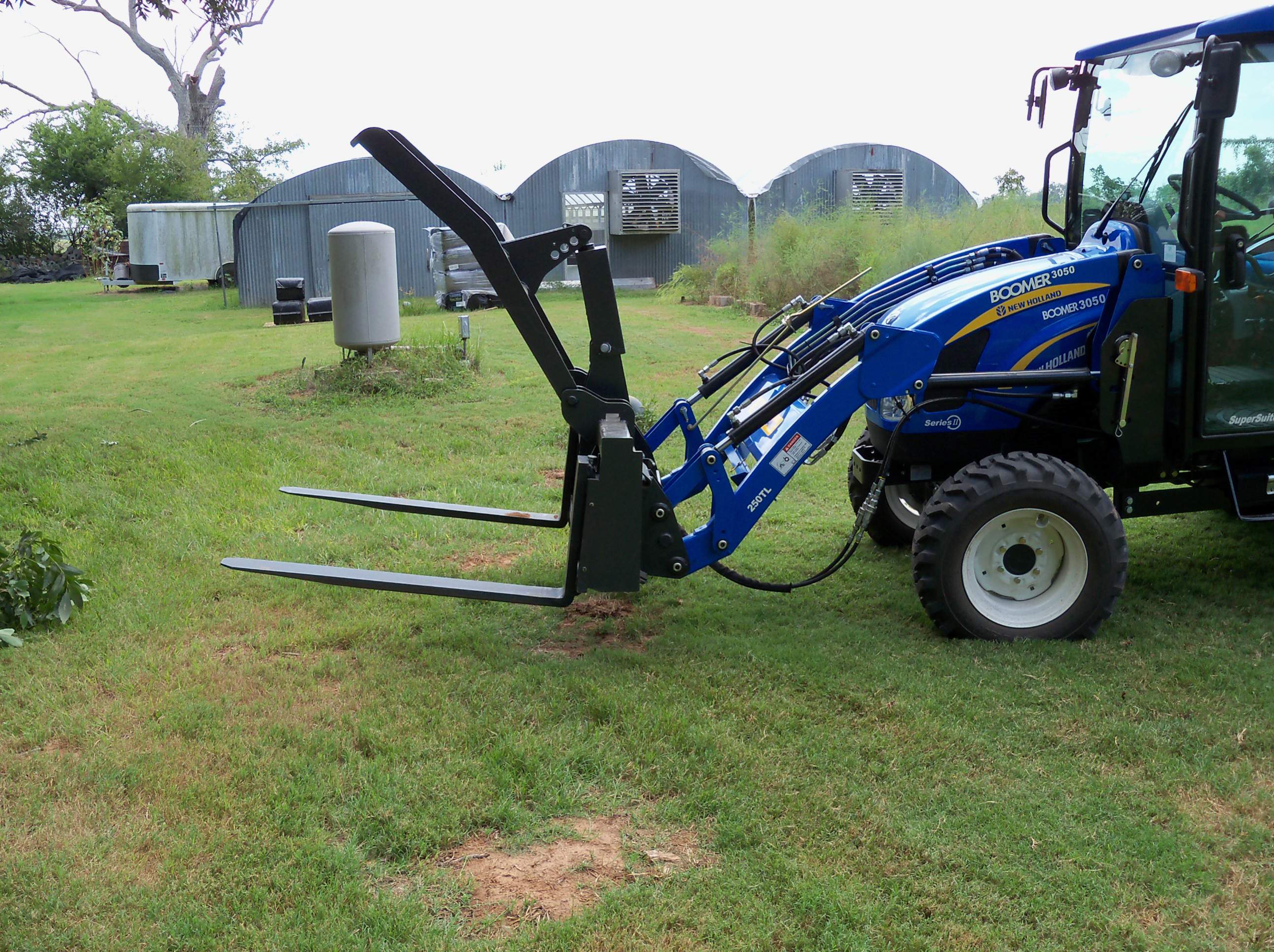

My farm has a large Pecan tree orchard where I move hundreds of downed large limbs to burn piles and I also move a lot on pallets so I opted not to get a root grapple. Instead I bought a combo adjustable pallet fork with hydraulic hand. This way I can move tree limbs and many items on pallets with the same unit. A root grapple for me would not be useful. In the pictures below the unit is on a Boomer 3050 but I have since sold it and now use these forks on a T4.75. The unit weighs in at around 650 pounds empty.

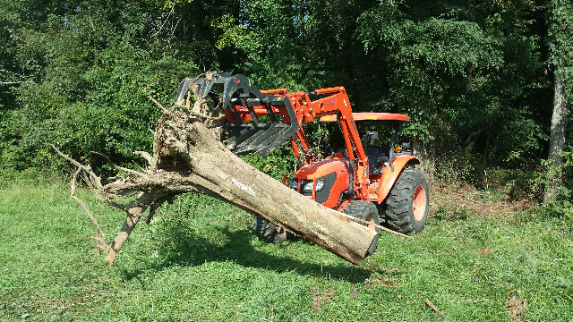

I have a Land Pride SGC 1560. Its 60" wide and weighs 820 lbs. I got this very heavy duty grapple because I have a history of being able to break an anvil with a feather. So far its done everything I want and I've caused no damage to it.View attachment 415786 I went with the "theory" of a narrow grapple - - I use the grapple to pick & move large rocks and cut sections of large pine trees. It will never be used to pick or move brush as I have very little on my property.

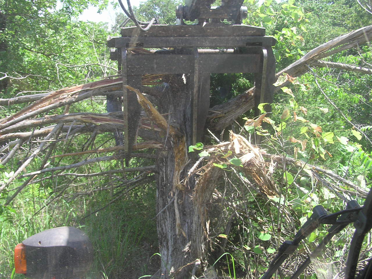

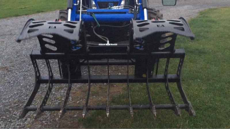

NAI light duty beefed up with extra steel plus going to 1/2 steel. On M7040. Has single lid.

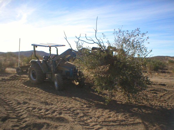

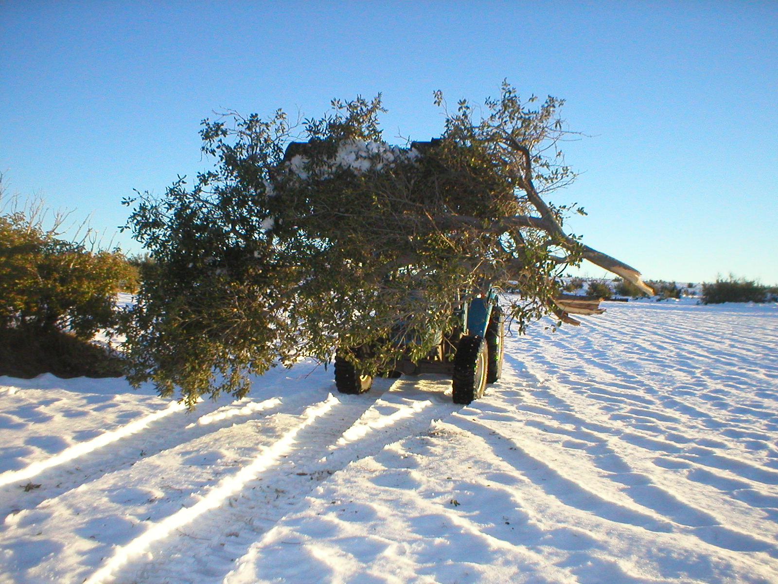

Here is my wicked root grapple by EA. They have since increased they lid opening height. If you buy one make sure you get the new one.

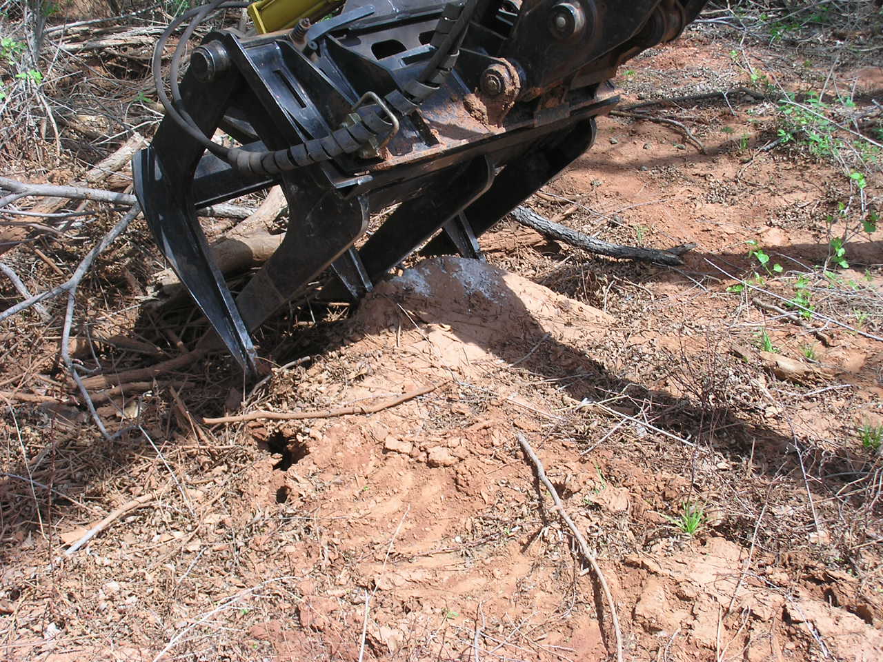

I looked at the rake shops online. The light duty ones look very weak to me. I know how I use mine, and I guarantee that I would bend those long unsupported tines. Their trash grapple version looks better. As far as digging, I really don't think having tines connected really limits depth, as frankly, about a foot or so deep is all you're going to get with a tractor, each pass. But having them splinted together really adds strength. I would also be afraid of wedging a log or limb between those tines, requiring a lot of work to pull it or cut it out. That's just my opinion. Never seen in person, but that EA X treme looks like a Mac daddy grapple.

I have not heard of the Rake Shop grapple tines bending. I have a different brand with long tines and have not had a problem. I like the penetrating ability into tree branches, etc. That dang cross tube stops the tines from penetrating.
