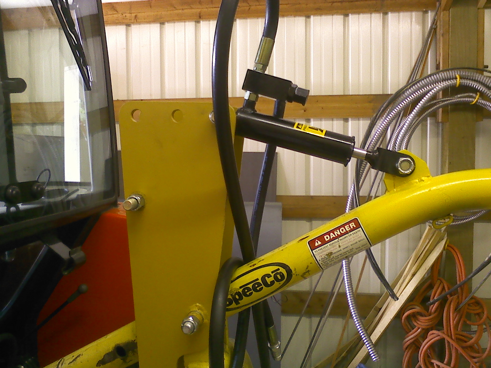

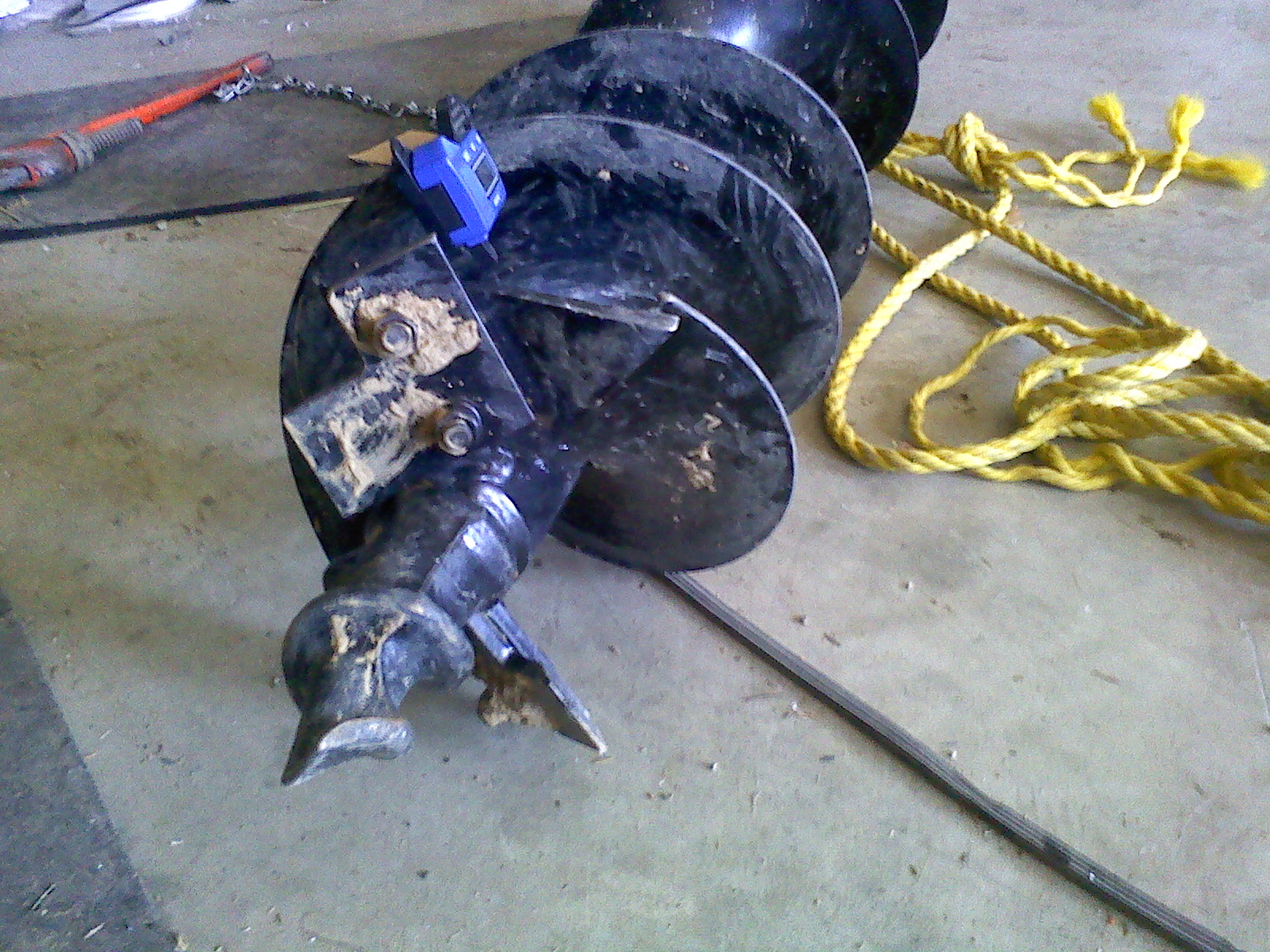

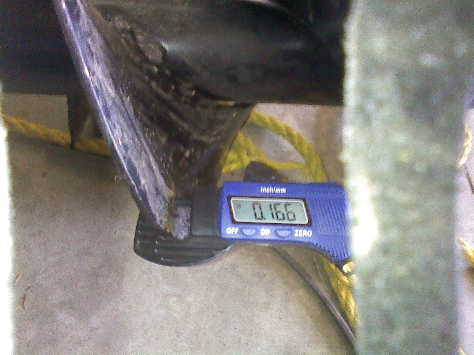

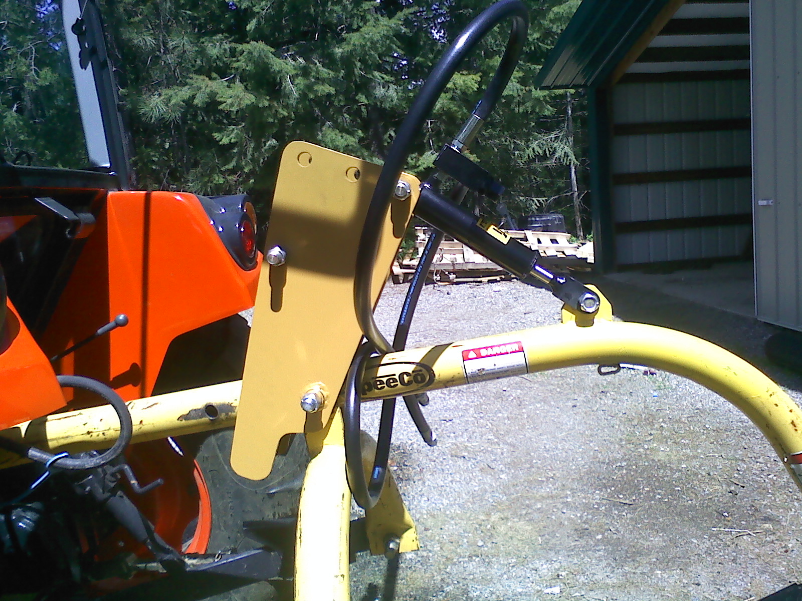

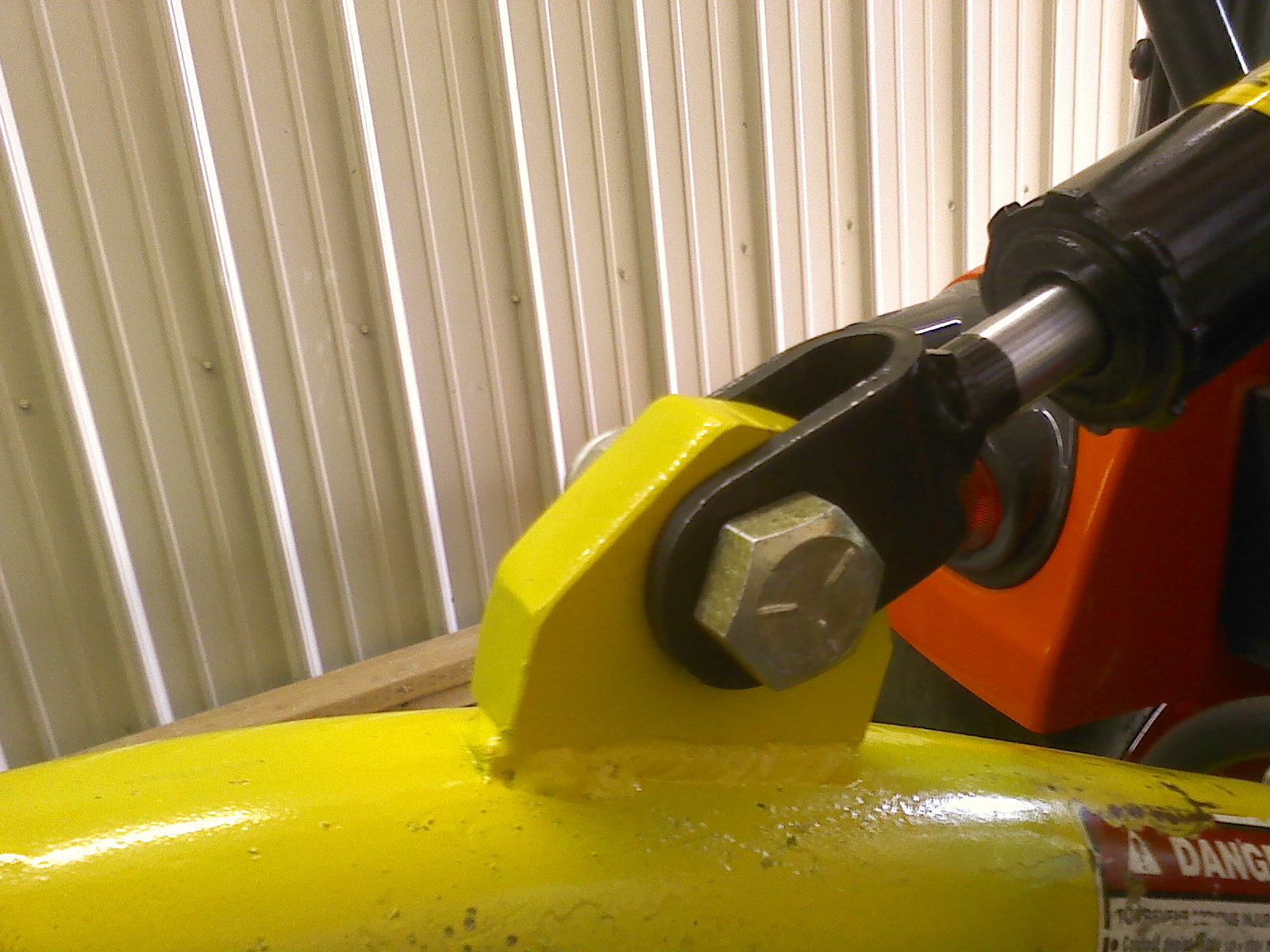

ok...now i have to defend my poor little Speeco post hole digger...shes all riled up.
hehe
i placed a metal thickness Guage on the metal and it reads at 0.166 inch..thats thicker then 1/8" (which would be 0.125). its actually 6 gage metal thickness. I also have double cutting edges and very strong teeth. i have attached some pics.
maybe its just the one you had looked at?? maybe my supply house sells a better version?? not sure. they do have different tooth styles available i know that. I can also use other brand augers if i wanted to.
I finally got the hydraulic assist unit installed, but im waiting for the tank dump valve to arrive from my Kioti dealer. So i wont be able to play with the thing for a few days yet.

Hey, now I know why mine has that hole in it, and the tab with the hole in it........... :ashamed:
