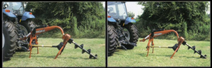

I have a Bush Hog 2102 with the optional parking stand. I can back up to it, slide in three pins, hook up the PTO, lift it, and go. No wrestling. The augers have the "Bear Claw" replaceable teeth. These teeth don't walk as bad when starting the hole in sod. They also take less power to dig the hole than other diggers I have used.

Comparing the Land Pride PD15 to my Bush Hog 2102 PHD:
1)The staggered auger cutting teeth that comes with the PD15 with are the way to go. These are the same that came on my 2102.
2) If the parking stand is a consideration I think the Bush Hog set up is a bit better than the Land Pride.
3) If adding a hydraulic down pressure to the PHD is a consideration the Bush Hog 2102 has a much beefier set up built in to it for this.
And last, but not least, is the price. I paid $1250.00 for my 2102 three years ago. I don't know what you have priced the Land Pride PD15 at.
