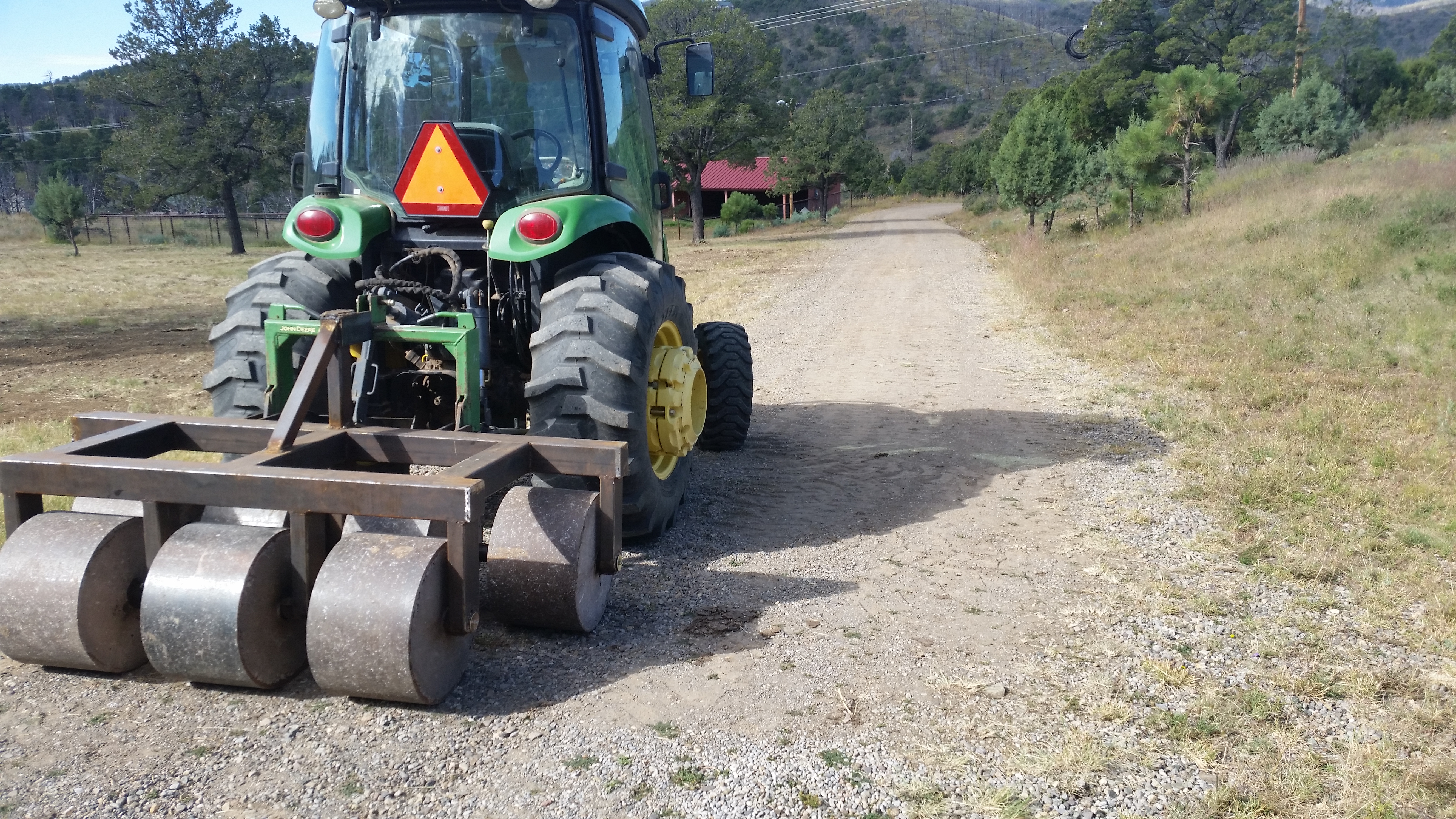

I agree with this 100%^^^^^
That said after building my new roller below which is about 2,600 lbs. I now have a better idea of what I can handle on the rear of my 4520. My current lpgs is about 950 lbs. and 8' wide, I can see building one about double this weight in the near future. Combine longer skids, hydraulic tail board and more clearance. Not going to bother with rippers.
Hydraulic tail gate would be great. I have been thinking about adding that to mine. A person could move a LOT of dirt with that, (over 3 1/2 CY for me) but I currently just don't have the time. :(
