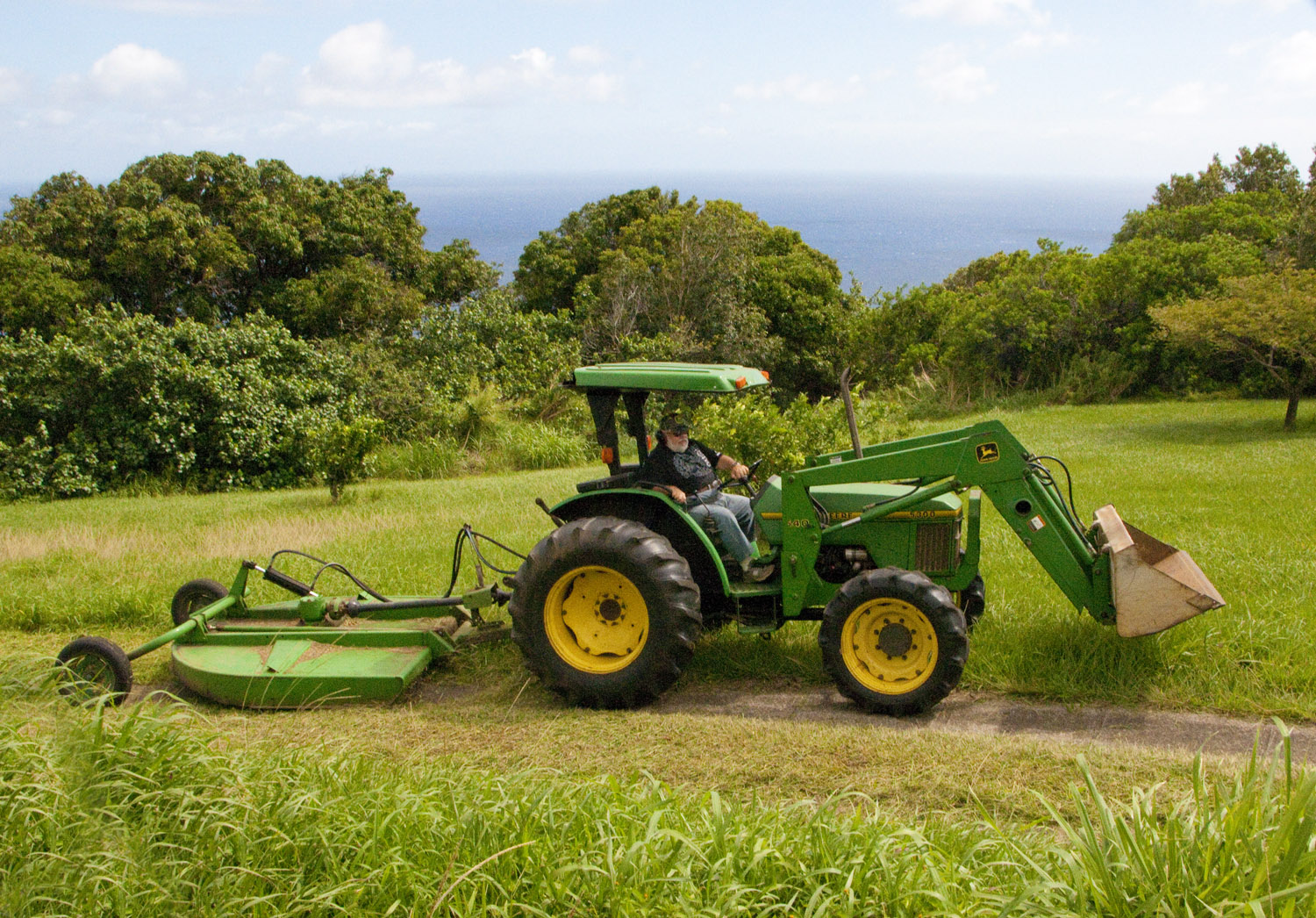

709 is a great deck. Battleship. Works well for pioneering areas that have been taken over by forest. Our 709 is very old, very heavy. Got it from a friend who found it in a long unused meadow. Still ticking, easy to maintain. We have the tow-behind model with the two wheels; large turning radius is the main negative. For us, it's a perfect complement to our Rears Pak-Flail.

Hi LD. I'm just going by the couple of thousand hours I've spent with both the 717 and my 709 dual wheel. They are the only rotary cutters I've ever owned. The 717 I bought new, along with my 5300 MFWD in '94. My gear lives in a quonset; never spends a night outdoors. It just always felt too light for our conditions and the tough sword grass that grows like crazy. There's plenty of basalt lava rock chunks that come up over time, and they would dent the deck and skirt of the 717 so it looked lumpy from early on. Rust through started after about 5 years, after 7 it was toast. Blade holder bent, gearbox shaft had to be replaced. It was the wrong tool for the job & place. This is pretty rough terrain and a rocky, severely sloping marine environment.
The 709 is still a joy and looks fresh after 18 years here. When I got it it had been set up to run off some kind of track machine, 10,000 RPM and the driveline extended and the angles modified, which was a hassle to get it modified and dialed in. Had to weld on new wear shoes and gussets on the skirt. Since then, just blade tips, hydraulic hoses and seals, touch-up green paint, a couple of u-joints and clutch plates. It is difficult for me to believe it is only a few hundred pounds heavier than that old 717. Regards.
