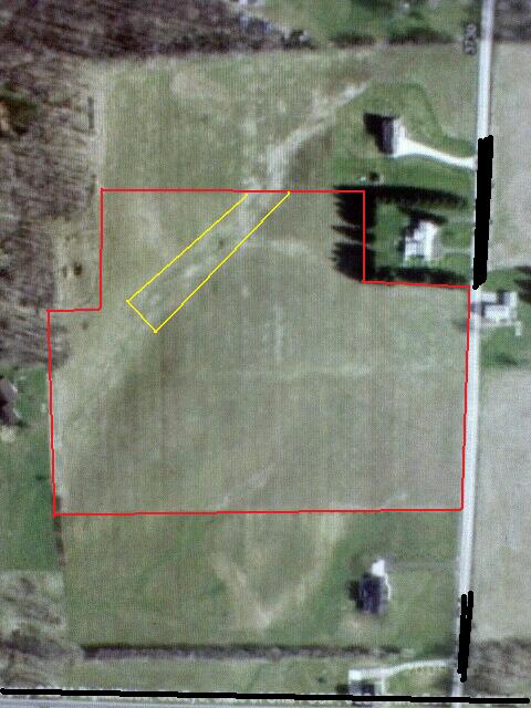

Heres the pic of the lot outlined in red.
The part I outlined in yellow was an old sodway that was really dense, and full of holes. Insetead of crossing it EVERY pass and slowing down, I just bit the bullet, and mowed everything in the yellow in 4L(3.5MPH gear). About 5 passes down and back the sodway. Once that was done, I nocked off that upper left corner, and then continued on the rest

If your tires are narrower than your bushhog, then I suspect that you had a lot more overlap than needed. That likely accounted for a lot of your extra time.

That is why I find it hard to believe that FWJ was able to mow @ 90% efficency:confused2:
I am not disputing his numbers, but unless the field was perfectally round, that is near impossible to to. I was just a bit disappointed because I was hoping for at least closer to 80% instead of 67%.:mad:
I did however spend about an extra 15 minutes doing a tad bit on the other side of the property line for a neighbor that flagged me down. I forgot about that in my calculations. Kinda a funny story in itself.....
The guy that hired me said mow EVERYTHING until you come to a mowed path or someone elses yard. So thats what I was doing and this neighbor stopped me. He said that ~10' was his they use as a barrier to keep the dogs out and he didnt want me to cut it. I apologized and continued on.
A few hours later he comes out and tells me I can go ahead and do it, but there are a few pallets and bricks in there. I tell him sure it will be $20. He about flips out:D Says "well you were going to do it anyway if I didnt stop you? I said I am only getting paid to do THIS 13 acres, and you told me that wasnt part of it, so I am not going to do it for free. I kindly remind him who bought the equipment, pays to maintain it, and pays to repair it when it breaks. He said just forget about it then.
Then I see him get his little riding tractor out and try to tackle it.About an hour later, after burning the deck belt off, he flags me down again with $20 and said do it.:D
So anyways, if I take off that ~.3 hours, That puts me @ 5 hours for 13 acres. And a little better effeciency of almost 72%.
And That is being a little optimisitc @ my 5mph average. Because I bet it was probabally closer to 4.5 with the having to slow down in areas plus that large briar patch.

Well....I guess I can believe the 90% on a rectangle now that I put the #'s to it. I guess it was just this od field I was in with 6 outside corners and 2 inside corners that really diminished my performance.
But for your 10.5 acres to be about 2x's longer than wide, would but it somewhere in the 480' x 960' range. And if you are mowing the length 960 and taking a 40' turn, 40/960 = about 4% lost on the turns. And 66-68 out of a 72" cutter is another 6%-9%, so if you are getting closer to the 68", I can see the 90% now.:thumbsup:
