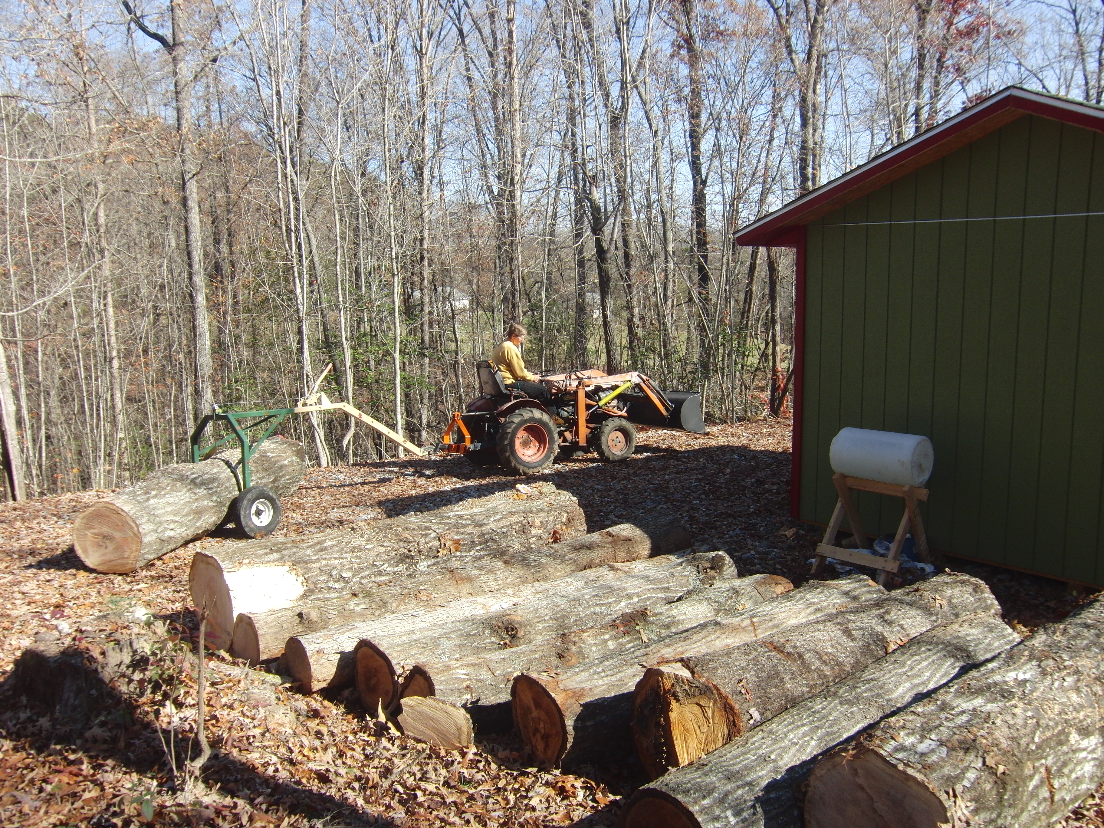

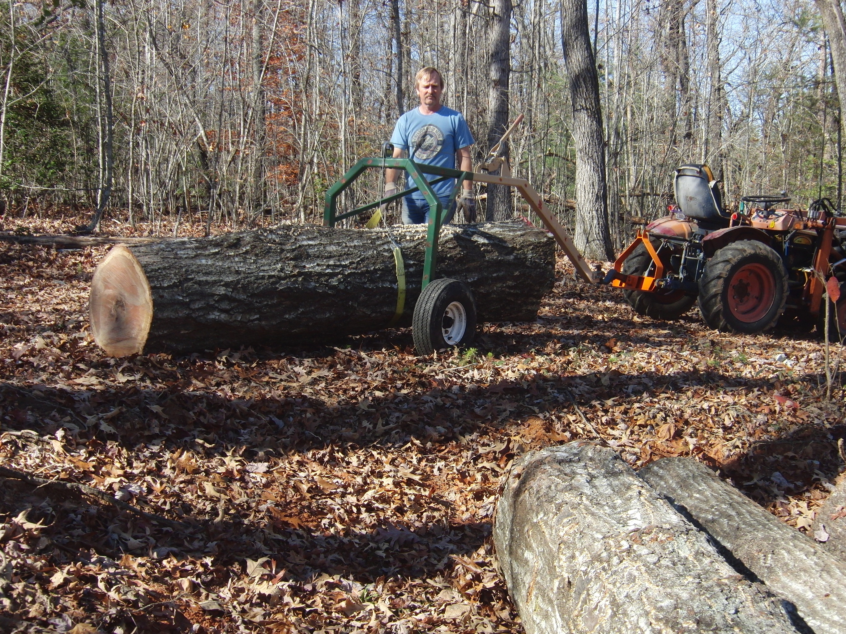

This is what I used to move logs. These are white and red oak logs. The largest is 27 inch and around 9 foot. fresh cut and approximately 1 ton. I moved these from my woods in about 4 hours with a little Kubota B7100.

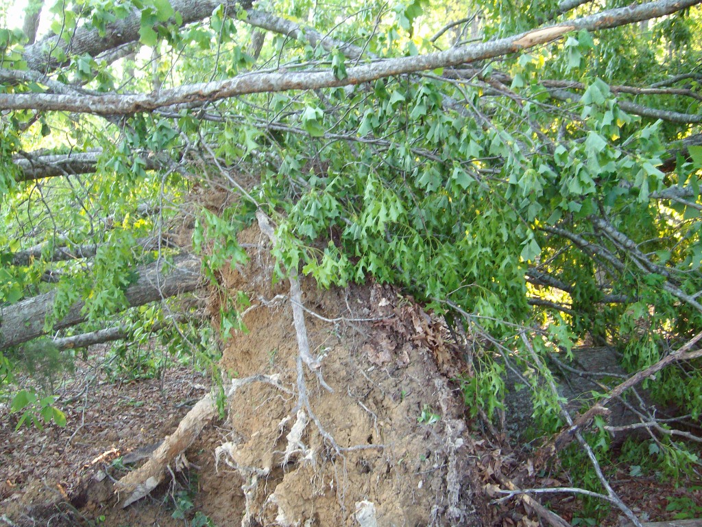

Here's a small sample of what I was dealing with.
Maybe similar to Plowhog's, but hopefully no root balls?
The only way to realistically access any of this was to pull out one "stem" at a time. The only way to do that with a tractor is to take advantage of its TRACTION to pull, either with a choker and chain or a winch. Even so, no way the root balls from blown-down trees were going to be moved without being able to get to them to cut the "stem" loose first.
No way to get in and do any of that with a grapple. An excavator with a grapple to do it from over head, maybe. But not from tractor level.
