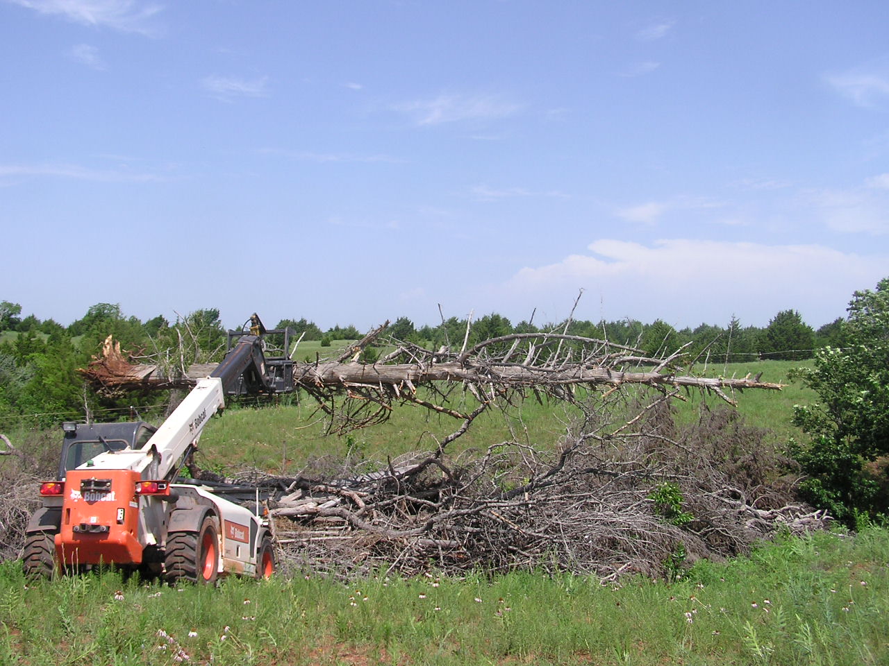

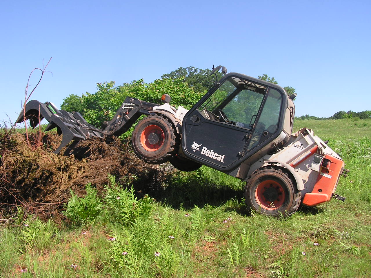

What are you planning on doing with the wood once you have it captured in the field?
2' diameter wood only takes a couple of minutes to make a cut in: cut in half and your issue is more manageable- cut more times until its totally manageable. THEN, as LD1 says, grapple it (into a low trailer so you can take it back out with the tractor+grapple).
But, if it's really only a one-time need (you wouldn't require any further use of say a grapple on your tractor) then rent something and be done with it.

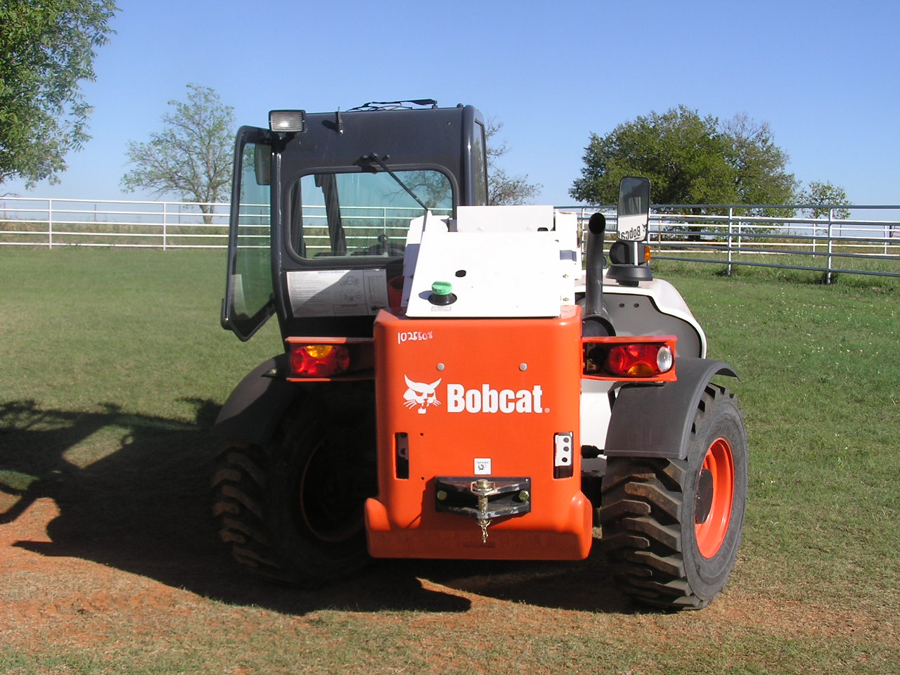

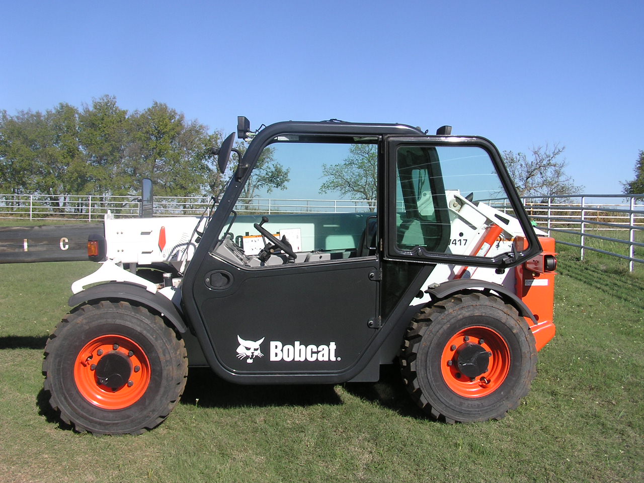

If you gots lots of money check out Xfaxman's setup (Bobcat V417 is awesome!).
Thanks, for those that haven't seen it: http://www.tractorbynet.com/forums/...mpact-telehandler.html?highlight=#post3243370

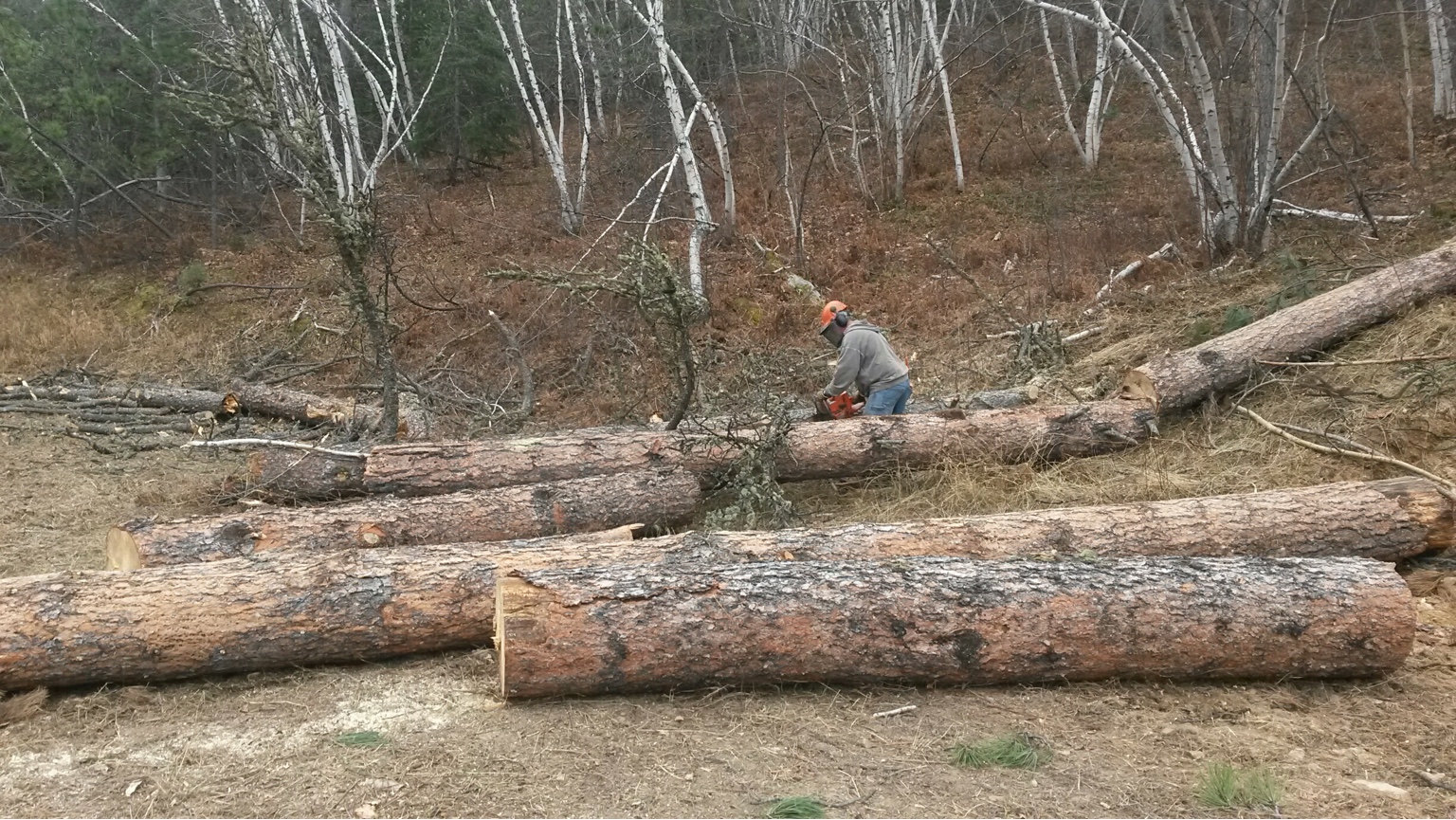

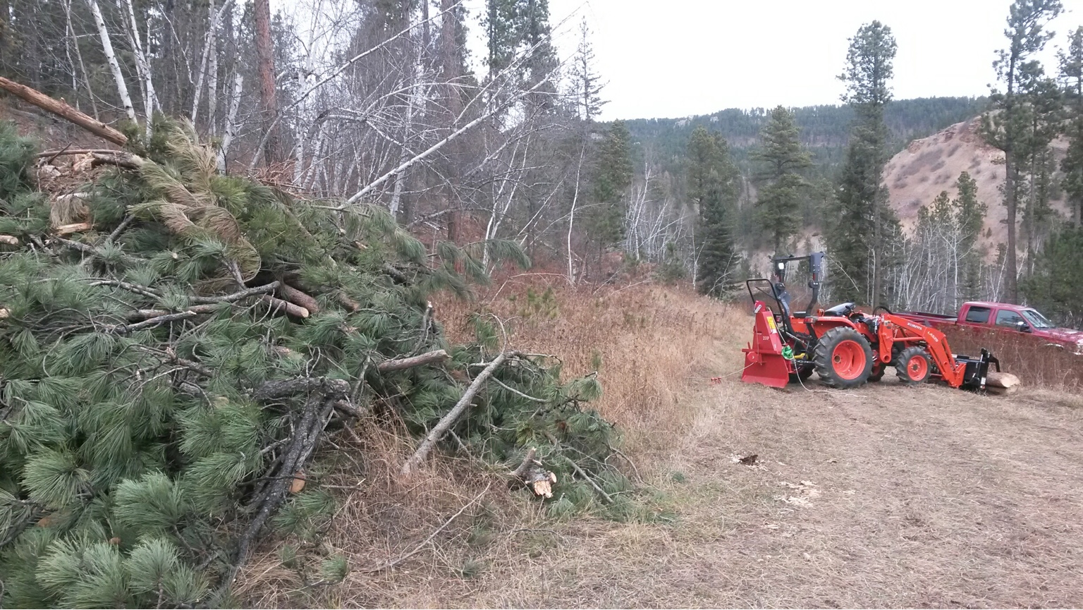

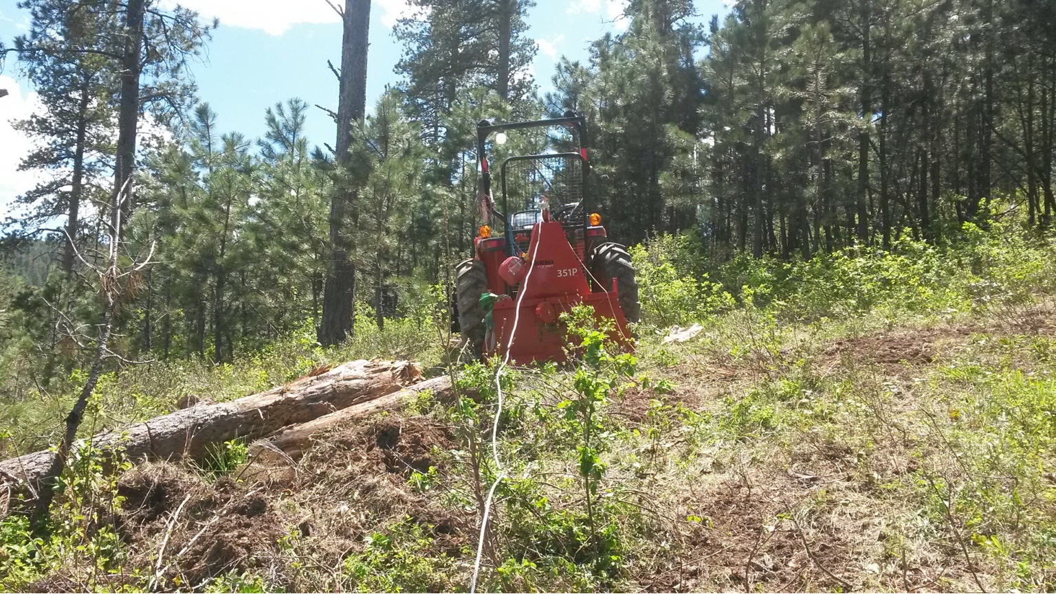

I maintain 23 acres with a Kubota L2501, Farmi skidding winch and Landpride grapple. Does everything I need.
ImageUploadedByTractorByNet1476230428.070549.jpgImageUploadedByTractorByNet1476230457.155312.jpgImageUploadedByTractorByNet1476230479.506185.jpg
