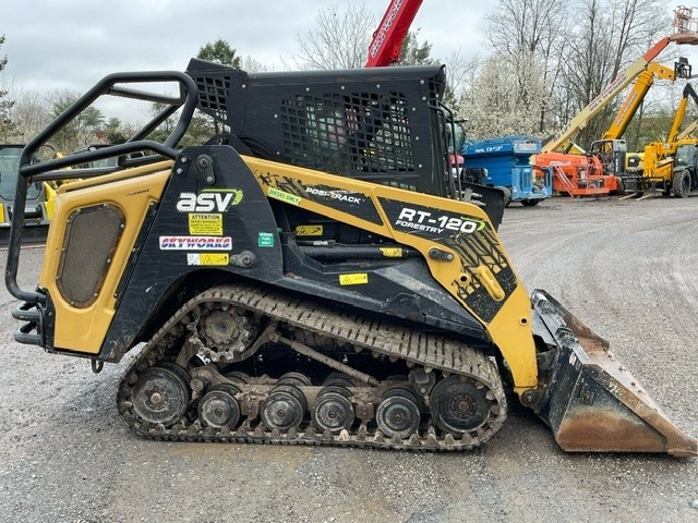

Here’s an ASV-120 with forestry package I am going to rent to own for a week

Some say the ASV’s lack dump height for dumping into dump trucks.
