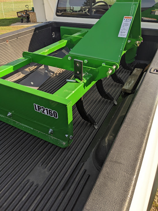

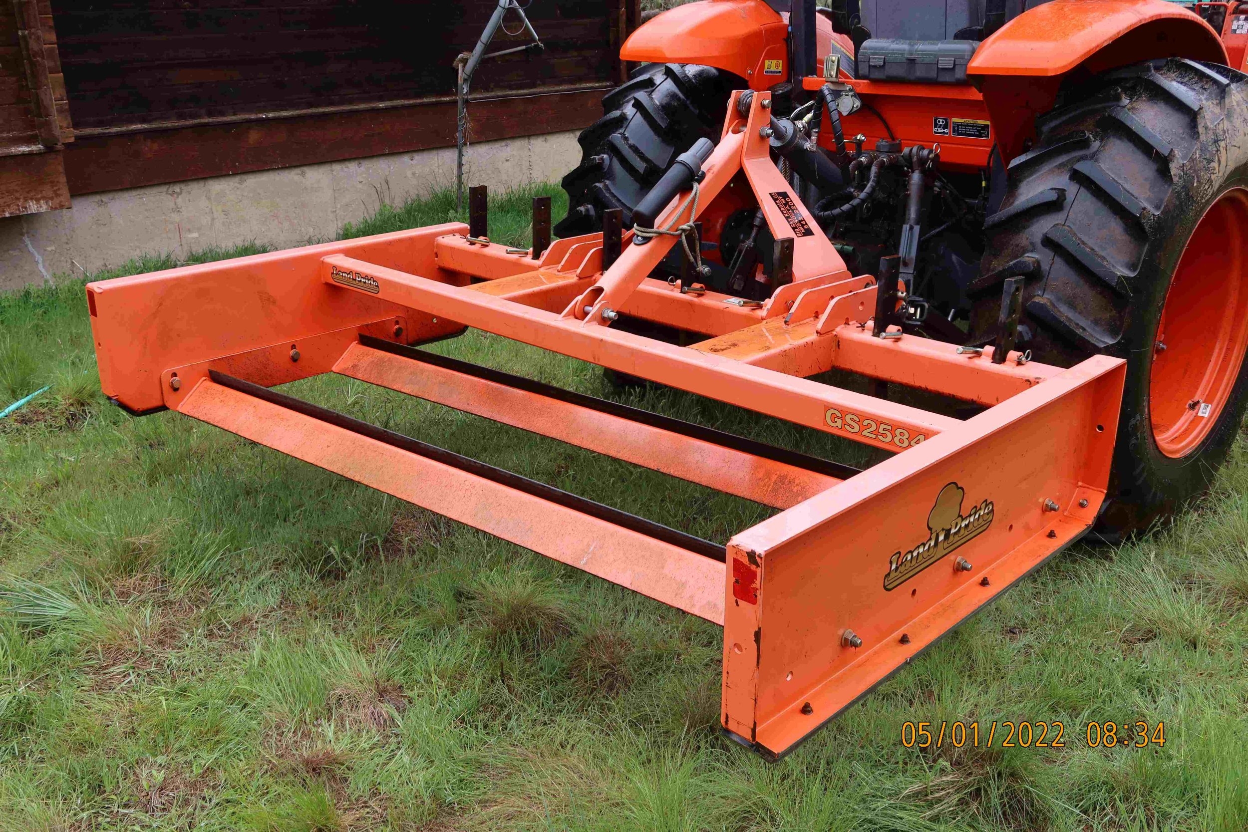

I would suggest any purchase be from a local dealer. I have ground engagement implements from - Land Pride, Bush Hog, Pittsburg & Rhino. All have functioned well with my next to sever use and have withstood the test of time.
My LPGS - Land Pride GS2584. 84" wide & 800 pounds. It has scarifiers and height adjustable blades. The cutting blades are reversible also.
I have a mile long gravel driveway. The surface "crust" is a mix of gravel, sand, silt & volcanic ash. In the summer it is hard as concrete. That's why I got one with scarifiers.
If your blades are adjustable - try lowering them, below the side frame, just an inch or so. Going lower does not seem to improve performance and CERTAINLY requires increased Hp.
My blades are 1 1/4 inches below the side frame. My scarifiers will be lowered 2 1/2 inches below the side frames. I run the LPGS in this manner until the "crust" is completely broken. Then raise the scarifers and use just the blades. My Kubota M6040 has 64 Hp and it DOES notice the drag created by the LPGS in the "scarifier down" mode.
I never have to "do" the entire driveway. Just a couple or three areas that get soft and rutted with the spring weather. I go very slow when using the LPGS. Never more than 2 or 3 mph. DEFINITELY in 4WD when using the scarifiers.
Check your LPGS - I would recommend lowering the blades no more than 1 1/2 inches. Perhaps - just an inch. It could be that you are trying to cut too deep.
Hope this gives you some new ideas. Report back when you get the new tractor.
This is my LPGS. It's just had all the dirt washed off.

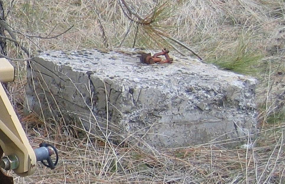

I have a 400# cast cement weight that could be set on the LPGS. If conditions ever get that bad - I'll have my neighbor bring over his ancient road grader. He uses it, every so often, on his LONG driveway. He pulls it with his dozer.
Here is a way to add 400# to any land engagement implement. Just be darn sure the frame of your implement is built to handle this added load.

Brian is correct. Heavier is better for land engagement implements. I could have, probably, got by with a 1200 - 1400 pound LPGS W/OUT scarifiers - if such an animal is even available.
However - my ruts get pretty deep and I DO want to reach clear to the bottom when I do my spring driveway maintenance.
I already have 420# in 70#suitcase weights on hangers I put on the sides of my quick hitch. While possibly not the best placement for a land plane it sure does make a huge improvement for my scraper blade. It virtually eliminates the popping up and over larger rocks That used to infuriate me when my entire load of materials got dumped in the middle of my road. I may look into a custom suitcase weight bracket mounted on the land plane. I have 8 42# and 6 70# weights and if I can figure out a system for mounting them then that may be a good way for me to go.
