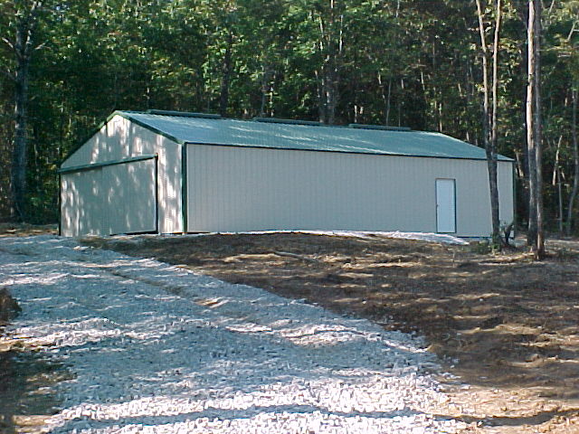

Soundguy, thanks i was leaning more toward the 4' BB for just that reason. I'll look around regarding the harrow and the cultivators too. Thanks for the idea on the scoop, I know that TSC has them if I don't find a used one somwhere. And yes the wife is really great about this, of course the apartment in the barn will be converted to her woodshop and woodcarving studio after the house is done. And she was a lot more willing after she saw the barn finished. Pic attached.

Very nice. I stayed with soem people once that had a pole barn.. the bottom was open.. and the top was actually modeled into a house on the inside. From the exterior.. it simply looked like a big barn.. inside was 'house'. With a few neat options. At one end, the wall (door) rolled away and you had a big 12' open area to look out. I stayed with them for a summer and helped out around the place when i was a kid. i kinda miss it.

Just saw that fabulous new barn. I'm orange with envy! John /forums/images/graemlins/grin.gif
