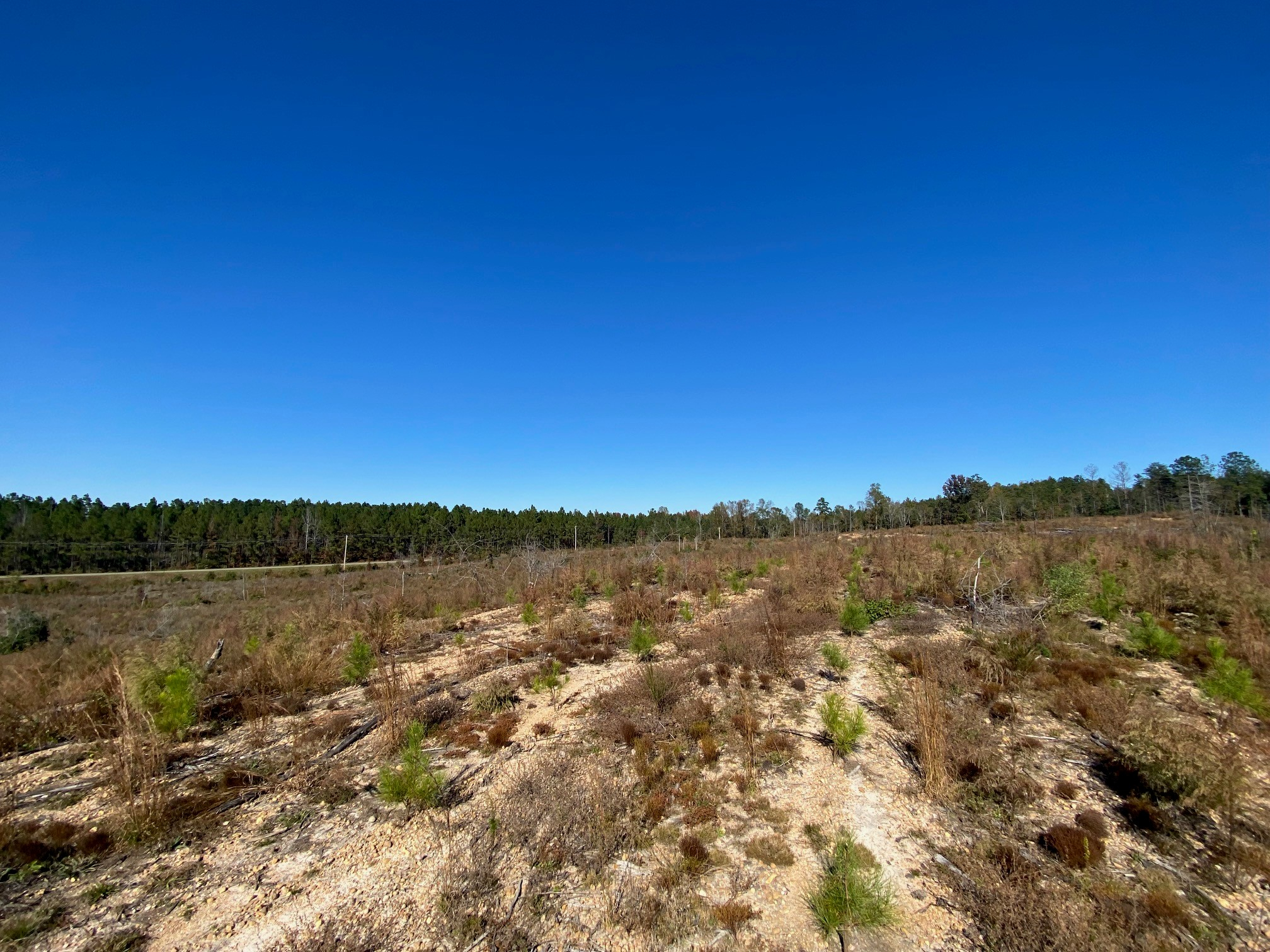

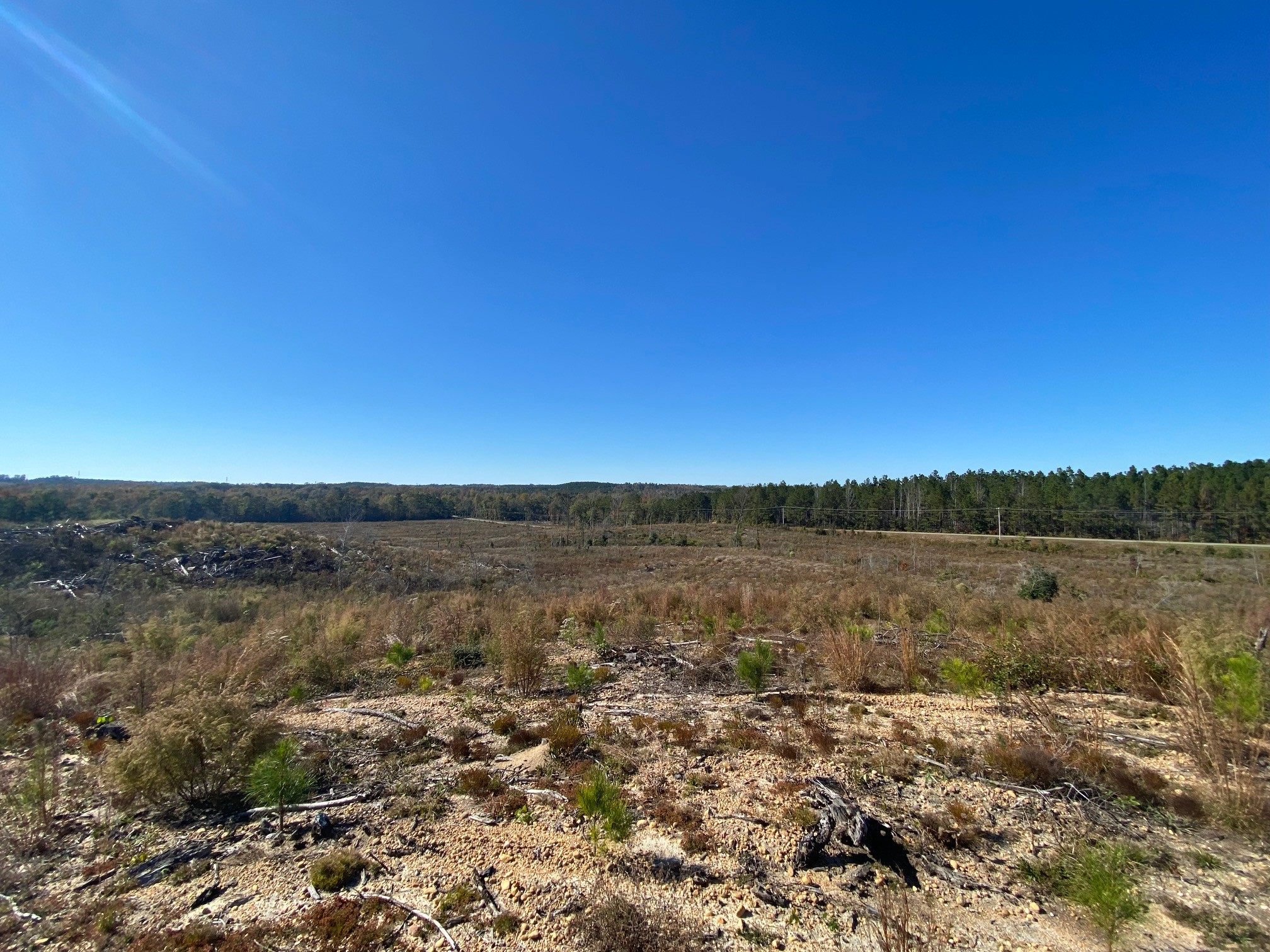

Instead of burning all the piles where they were left when they cut the land, I decided to find one spot and burn it all there. Which grapple (Root or Rake/Clamshell) would work best to pick up the left over timber? I haven't walked the entire land (48 acres), but doesn't seem like there is a lot of large logs to move. I have a Mahindra 4540 4WD.

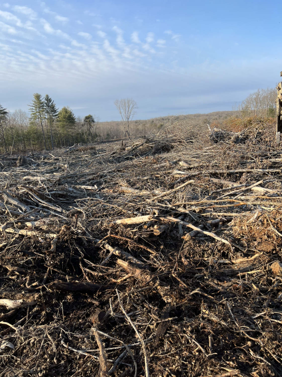

I’ve been working on a similar mess which appears to have more trash left behind than yours. I found a grapple on my CTL to be almost worthless. It’s too tangled to pick anything up with a grapple. All the stumps don’t help. I found an excavator with a thumb to be much better at picking up and burning brush. Your land already looks fairly clean but picking apart those piles is much harder than it might seem.

I’ve been working on a similar mess which appears to have more trash left behind than yours. I found a grapple on my CTL to be almost worthless. It’s too tangled to pick anything up with a grapple. All the stumps don’t help. I found an excavator with a thumb to be much better at picking up and burning brush. View attachment 732891

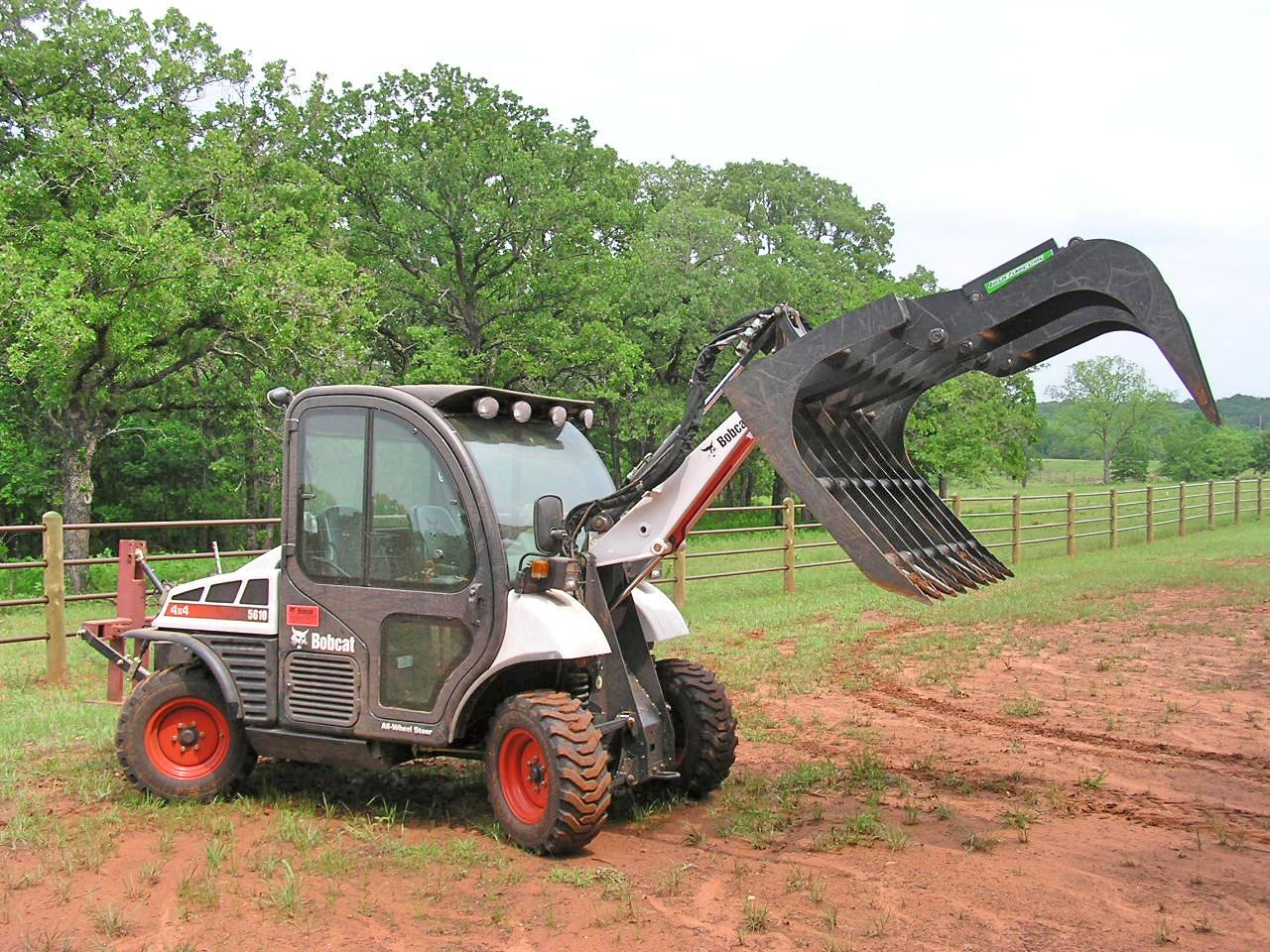

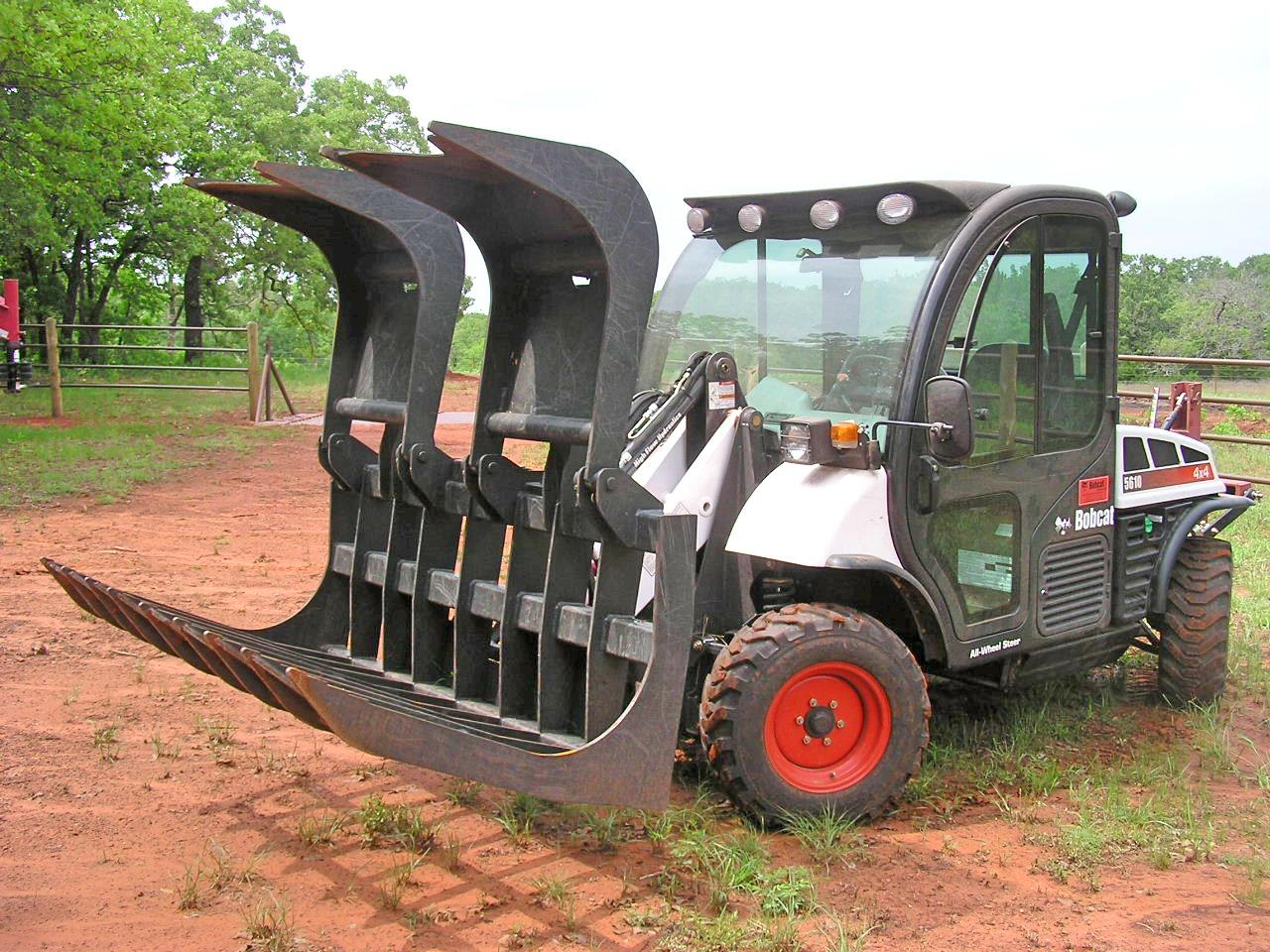

Do your research, all grapples are different. Be sure and get one that has the ability to float or depth guide. I've had both and prefer the L shape one too because it holds more debris. Mine has a pipe between the bottom teeth that serves as a depth guide

I use a wicked clamshell style on both of my tractors.

I have a clamshell, twin lid style. I like it because I can clamp smaller logs, raise them up, and buck them into 4-8' lengths standing up. Mine opens up to nearly 60" so I can grab a huge mouthful of brush.
