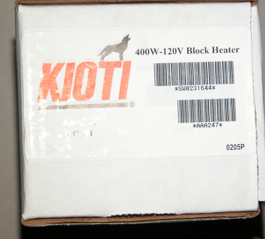

Just curious, what's your nearest Kioti dealer pricing out a block heater for?
   / Best choice for engine heater CK 30 (block, heater hose, magnetic?) #23
Mine still cant find it so I gave up. They say they only have a heater hose one.
   / Best choice for engine heater CK 30 (block, heater hose, magnetic?) #24
I can pm my dealer to you and he can drop ship it to you. It was $68 this past spring.
#26
The closest dealer to me is Moores Corners in New York State. They quoted me $130 for the part. I blanched.....if it is $68 I would put one in two shakes of a lamb's tail.

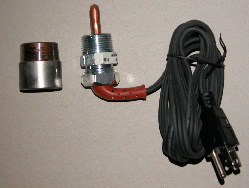

jabelding:
Please let me know how the install goes.
Do you use an adhesive on the bushing? I imagine a press fit is difficult to secure without an arbor press.....and really hard to secure on the tractor.
Mine is a CK 30....are the freeze plugs the same size?
DOC
   / Best choice for engine heater CK 30 (block, heater hose, magnetic?) #30

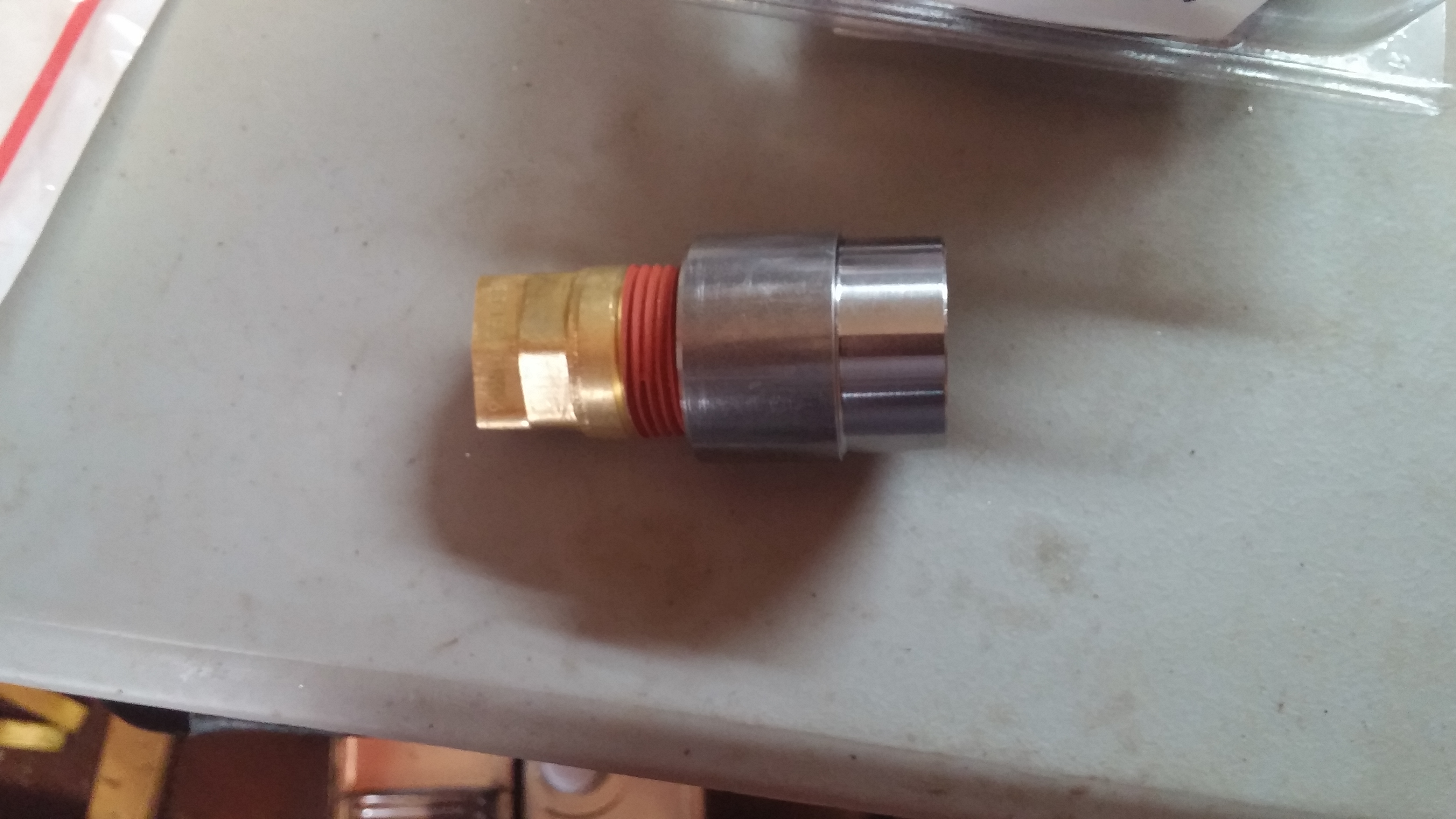

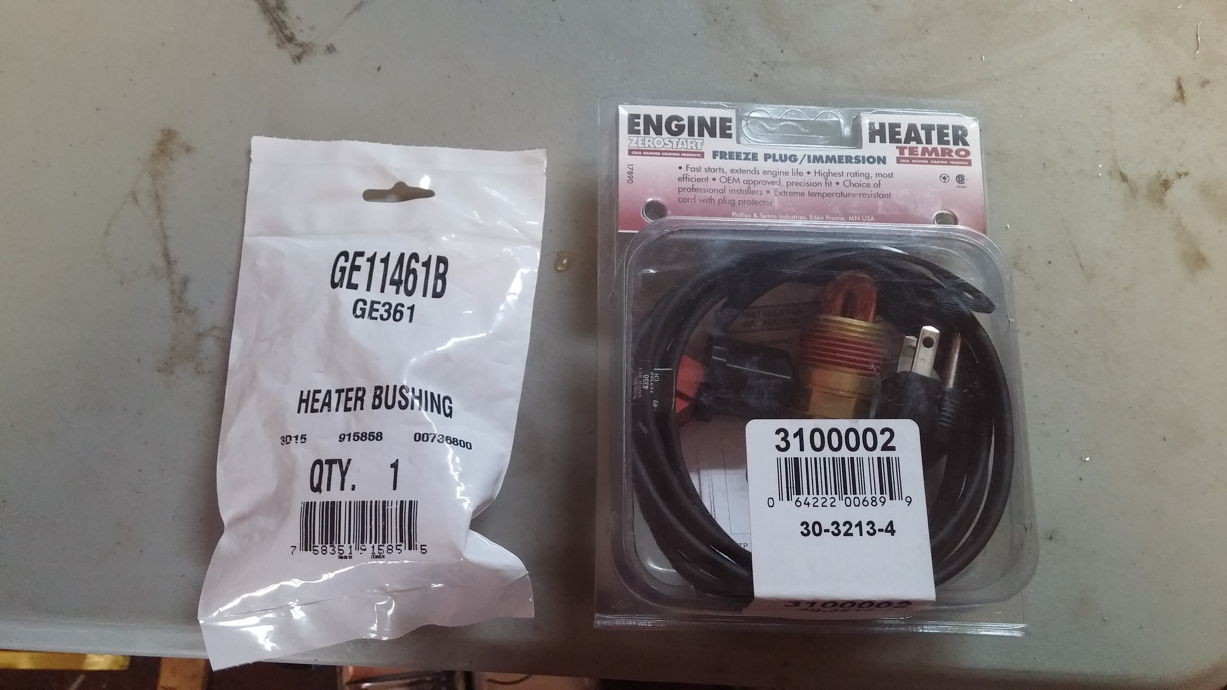

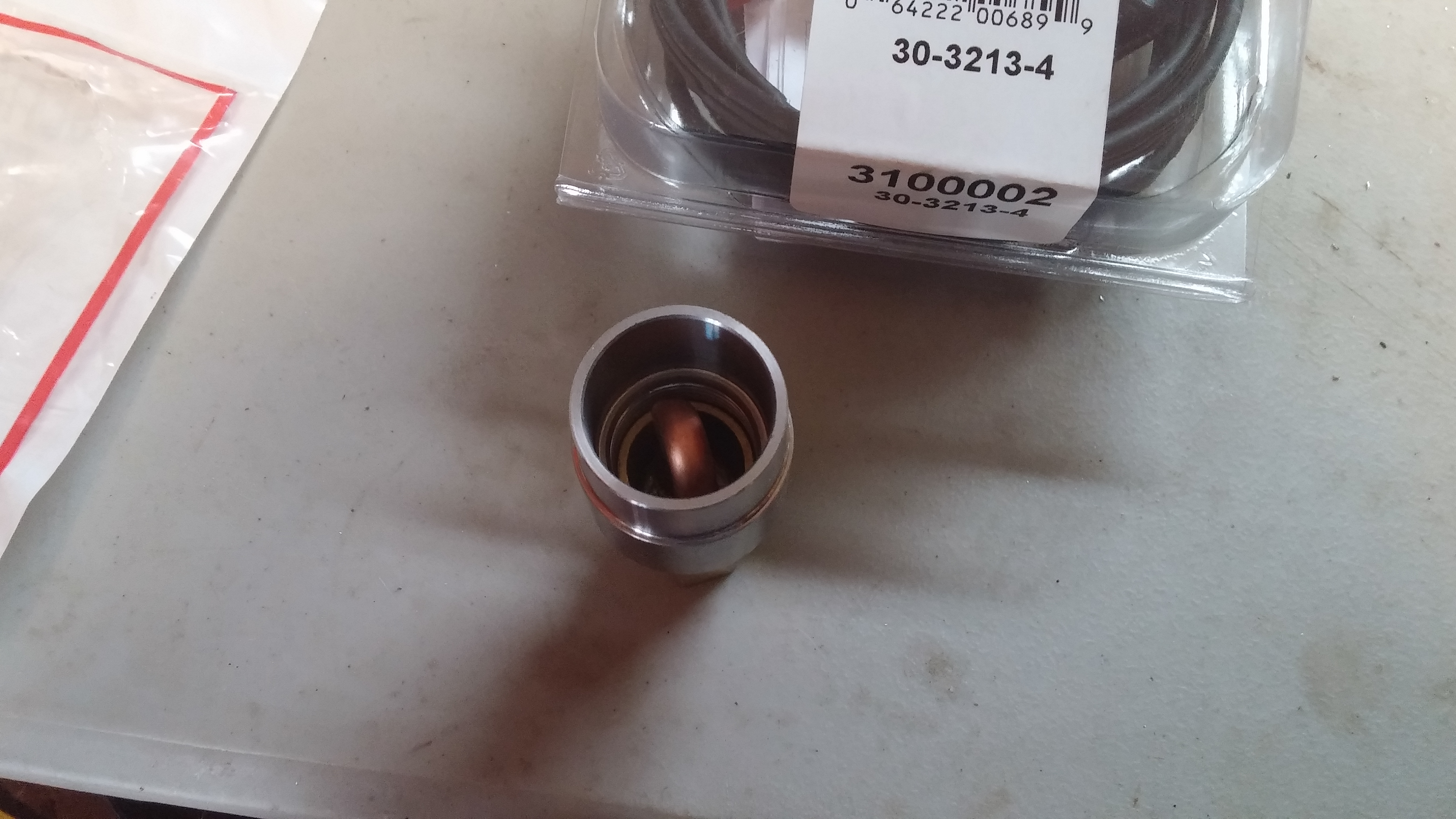

I will let you know how the install goes. I have a Toyota sealant that most people have recommended. Amazon.com: Genuine Toyota Fluid 00295-00103 Formed-in-Place Oil Pan Gasket - 3 oz. Tube: Automotive
It doesn't hold in the bushing the press fit does that, just will seal any small scratches that might leak. I will just tap it in with a long bar and hammer like the others have. Also i want to be sure at full press in depth there is not contact between the bushing and cylinder wall.
I think most of the Kioti engines over 25hp are 32mm freeze plugs.
