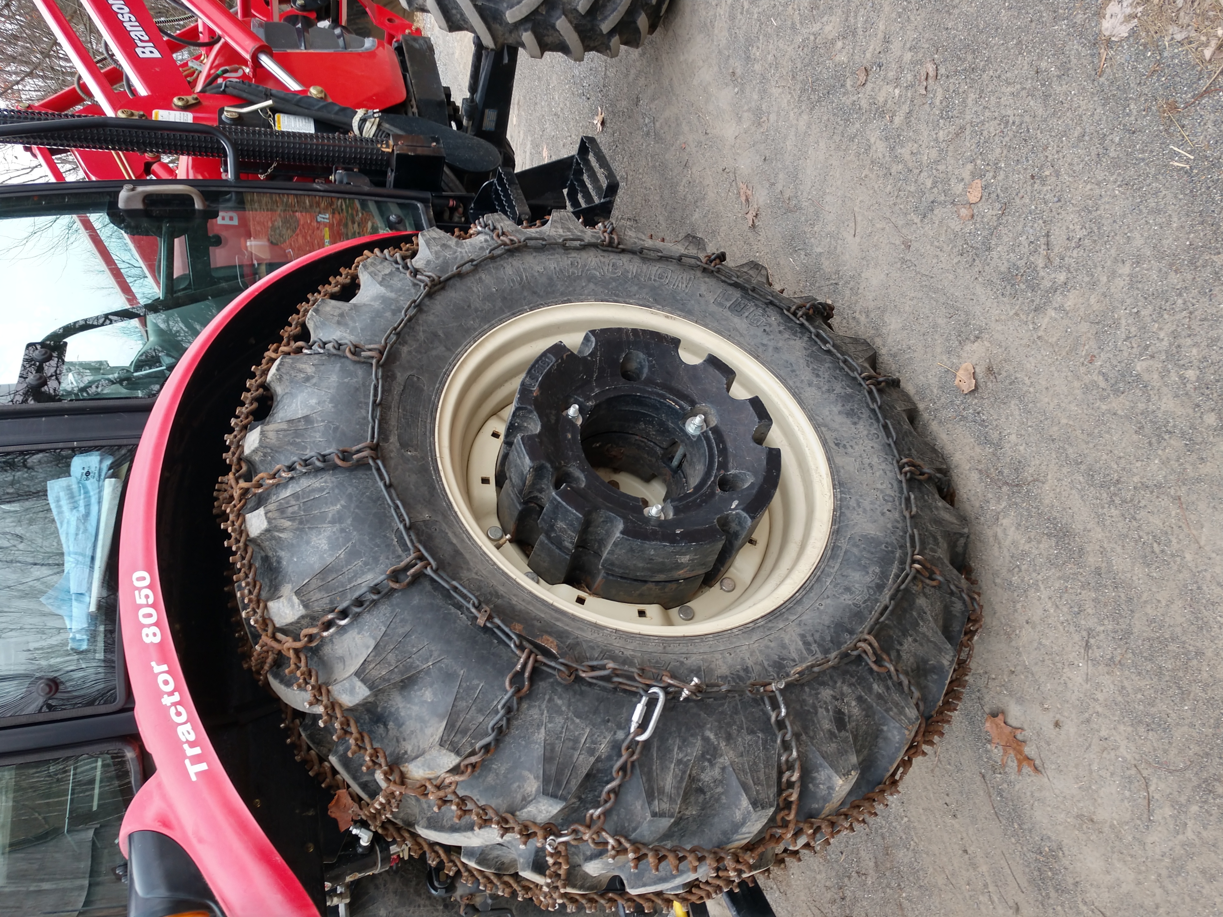

I would recommend the diamond pattern chains;
ATV Tire Chains | UTV Tire Chains | Free US Shipping
The diamond pattern studded or not will provide the most uniform traction with out the grab-slip of 2 or 4 link spaced chains.
Also most chains in low speed applications do not need to be super tight.
I have not used chains on a walk behind tractor, but I have used them on 2wd, 4wd trucks and tractors and cars and side by sides.
And I have used the old big double ring, 2 and 4 link spaced twisted street chains with and without V bar reinforcement, now I have gone with the square or diamond pattern studded chain for normal everyday use of chains nothing will come close to the traction they provide with a high ride comfort. No one that I know of that has tried them has any desire to go back to conventional chains.
