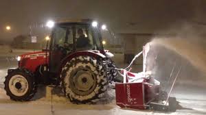

I'd suggest the Normand Inverted (pull style) blower. They have a Hardox steel frame that is stronger than the other brands. I know several guys using them on long driveways, and even more guys running them commercially.
Also just so everyone knows, the PXPL mentioned above is not a pull style blower, it only blows while moving in reverse. What it has is a pull back blade for getting up close to garage doors. It's a nice blower, but it's almost 2x the cost of an inverted blower. It's really more suited for a bi-directional tractor like a TV145. I know several contractors that used to use the PXPL that have switched to inverted blowers because they are easier to use, faster, cost less to buy, cost less to own, and don't need an expensive bi-directional tractor to use properly.

I would cast my vote for a Normand as well. VERY impressed with our Normand 92-280. Well built, durable and awesome to watch it work.
Image is the guy to get a hold of in the states, for help with selecting the right size and options.
