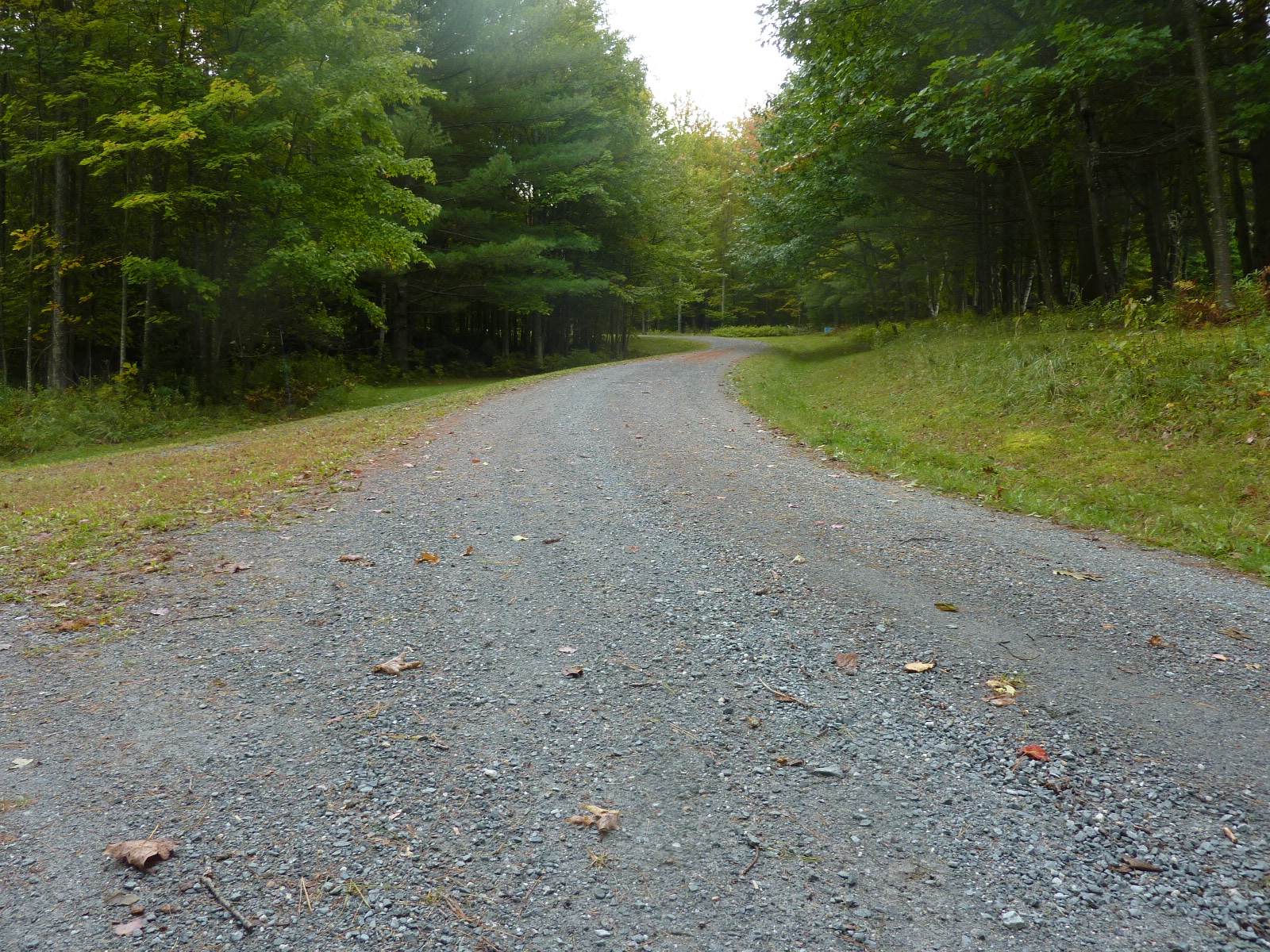

You have a pretty road, but not much of a crown from what I can see in this one photo. I'm not being critical...it just seems pretty flat/level straight across. Nothing wrong with that if that's the way you like it...except water will lay in the road instead of running off. Our house site is up a mountain, so we need a better crown to keep water running off the road instead of down the road. A really good crown solves most maintenance issues, especially with a solid rock base.
I do like my road the way it is - thank you. After all the main purpose of maintenance is to shape it so the water runs off w/o erosion and doesn't pool on the road. In my thinking there are a lot of good reasons why not to have a crown. As you noticed some parts of my road are flat - but they are not level. They are canted to one side so all the water goes to the down hill side. They are usually on a portion that is fairly level or w/o much grade change and the up hill side ditch is minimal because of ledge. Other places I have a normal crown. Especially on hills where you need to shed the water faster. I don't normally get those pot holes from pooled water except right after the winter thaw and mud season which is a northern thing you may not be familiar with.

That road looks perfect Gordon! I can see your crown better in this pic too. Very nicely done sides too....good drainage, not too steep, no wash outs, no ditches, can mow it. Well done!

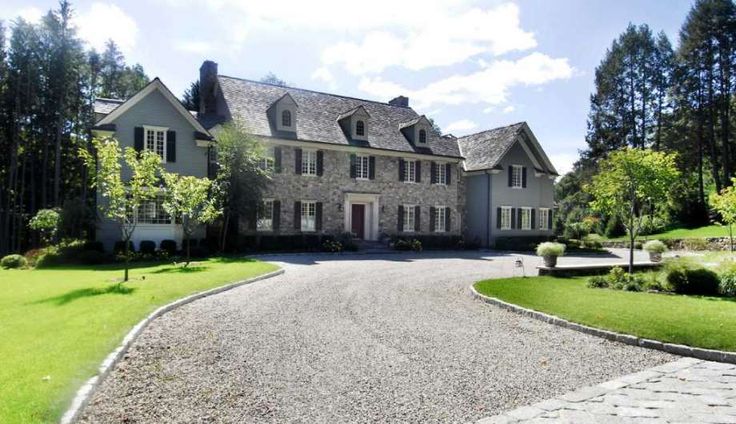

Like many here, I'd rather have a gravel driveway. Not everyone likes concrete. And these days, gravel is often considered an upgrade to concrete, especially in high end homes. View attachment 572951iu.jpg On really long driveways like you find on many farms here, using concrete would just be silly, not priceless.
