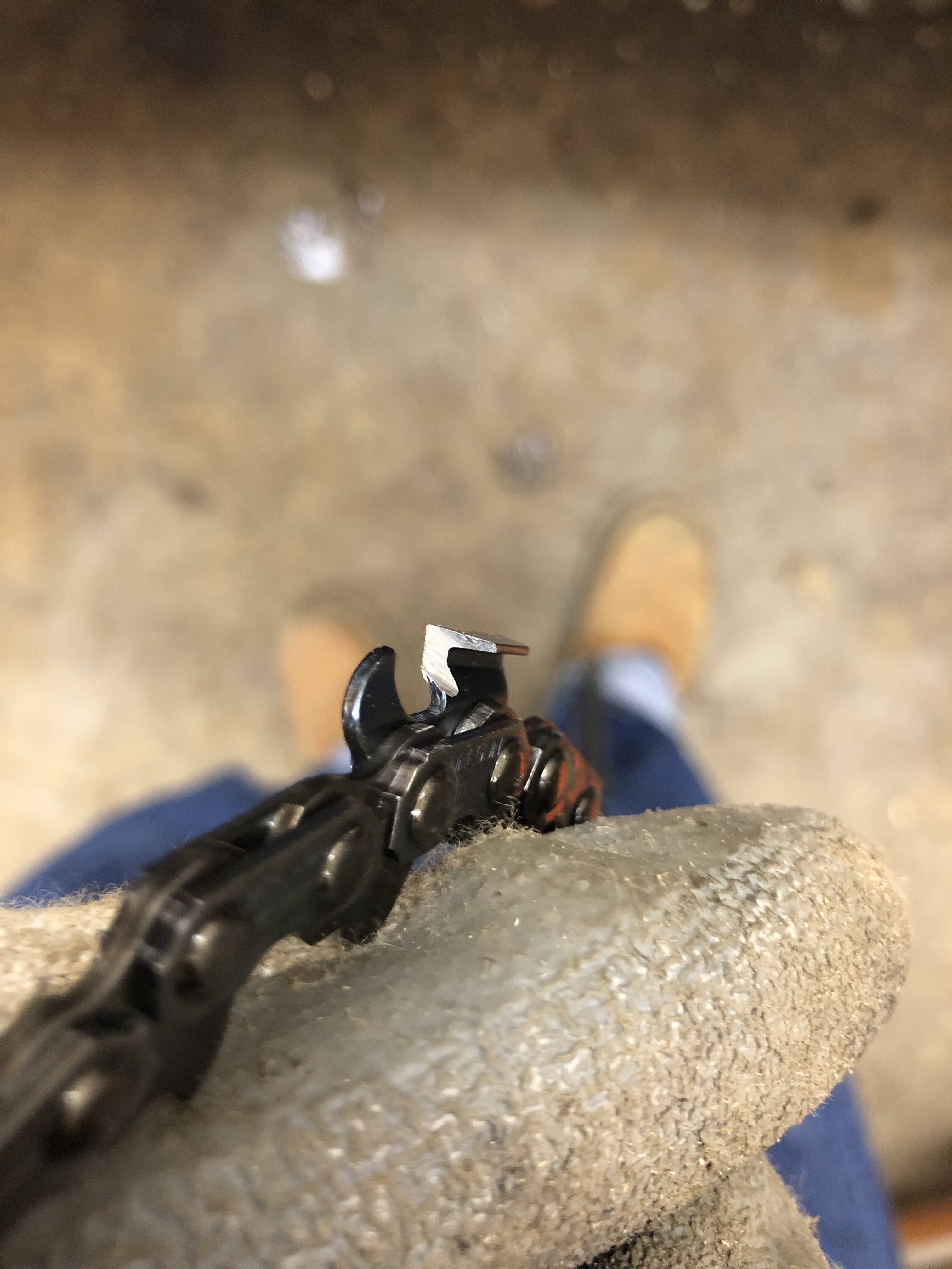

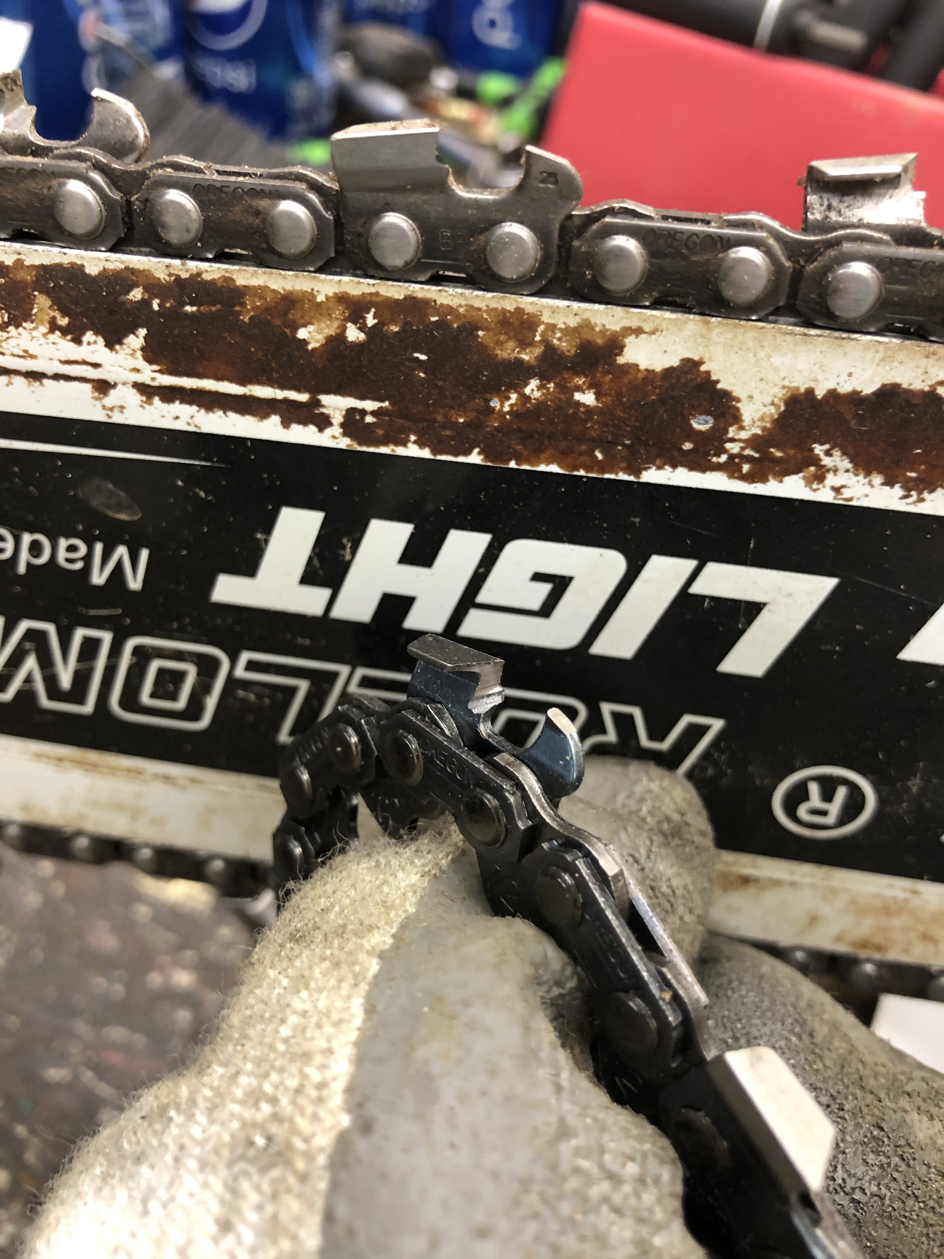

Have you ever seen a cutter like this?

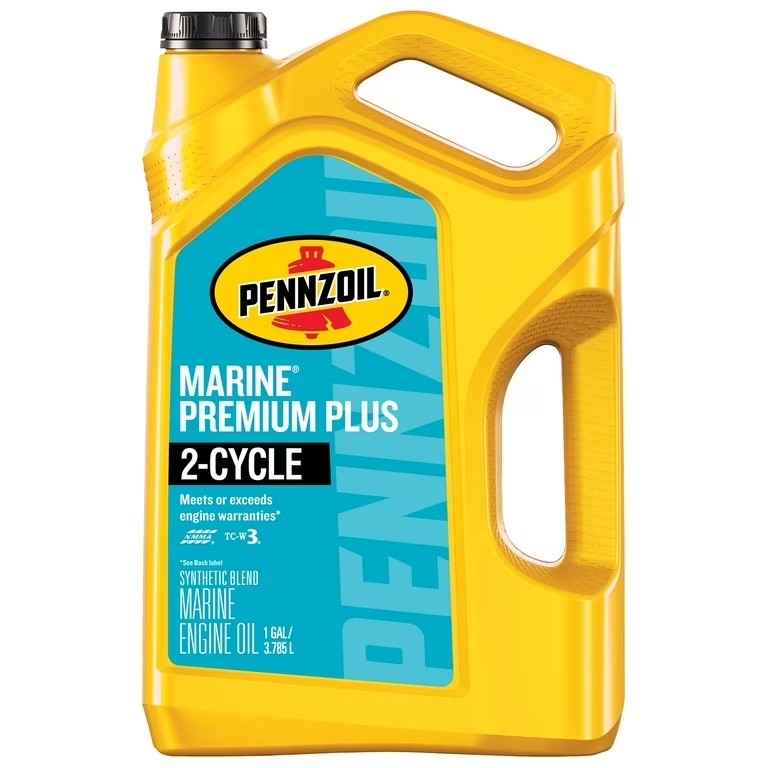

2 Cycle oils:
Stihl and Husqvarna make really awful oils that make tons of carbon/cokeing that kills engines. Even their synthetics don't show great improvement with this either. And who in their right mind would ever try 'bio-degradeable' oils - of course it toasted your engine!!!... Let this be a lesson to you, duhhh.
Go and buy 2 cycle marine oils or 2 cycle motorcycle oils. Stay far away from the OEM garbage. I'm running the cheaper Pennzoil
It's $22-24/gal at Wally world and I'm running it a tad richer at just shy of 40:1 (42-45ish)
Guess what, no coking! Clean and shiny motor interior and no plugged up muffler.

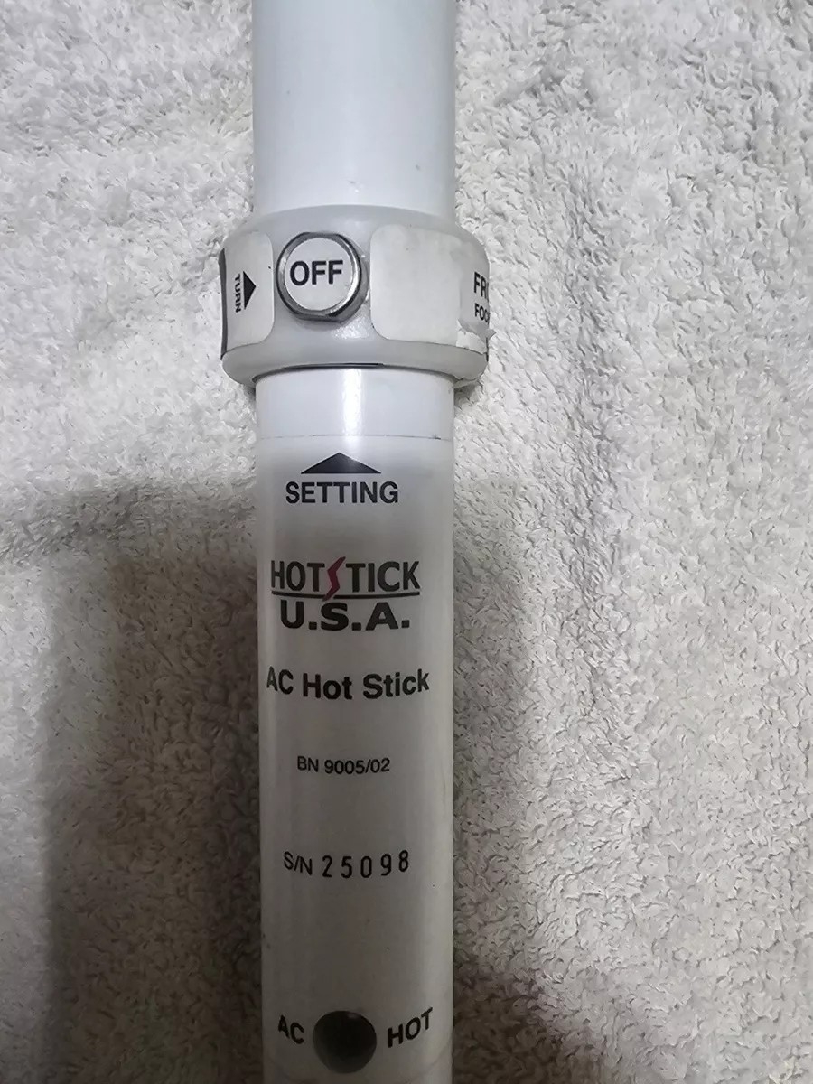

Finally get a Hot-Stick or similar - it can save your life.

2 Cycle oils:
Go and buy 2 cycle marine oils or 2 cycle motorcycle oils. Stay far away from the OEM garbage. I'm running the cheaper PennzoilView attachment 1664133
Although some oil bottles say it's okay, Marine 2-cycle oil (TCW rating et al.) is not recommended for every air-cooled engine and certainly not for prolonged use. The additives in marine oils and air-cooled oils are often different because air-cooled engines tend to run hotter. You may not see carbon in the P&C, but it can be harder on the bearings over time.
There are also special air-cooled engines that benefit from specific 2-cycle oils. The Stihl 4-Mix engine (on many pole saws, string trimmers, and combination equipment) uses 2-cycle mix, but it also has valves that don't like most mixes other than properly mixed Sthil Ultra.
