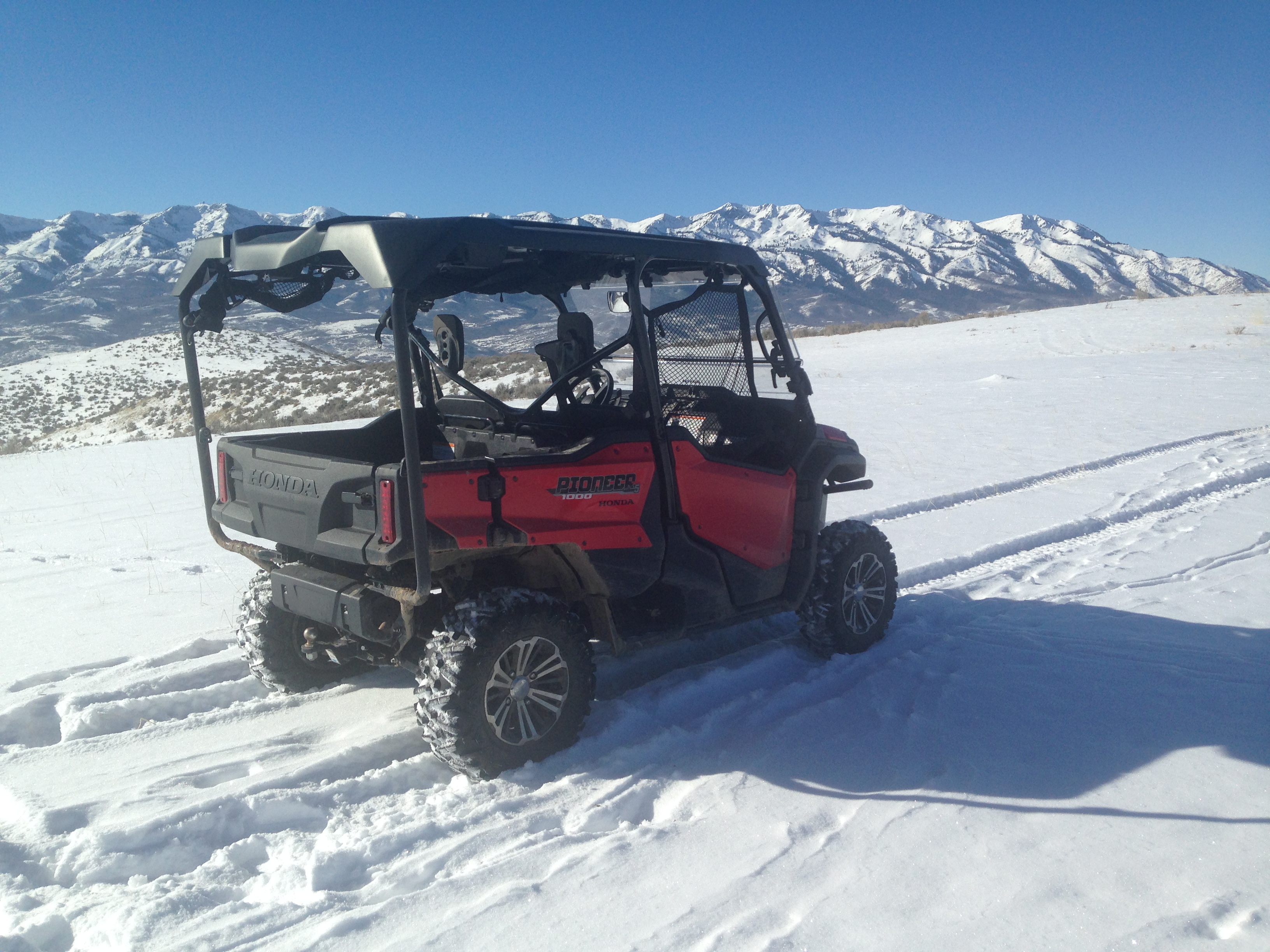

Just got this one on. I put the Warn #4500 provantage synthetic on. Not a fan of synthetic but we'll see. I did test it out by hooking up to the Kubota and locked up all the brakes and the winch pulled the sxs with ease. I'm going to get a snow plow for it, so the winch will get plenty of use.
Had a pioneer 700 which had a #4000 and it could pull me out and other sxs's but struggled a bit. I would recommend nothing smaller the #4500 on a sxs.

Yeah, I think you are right.
I've had both, rope/cable. I like rope best for handling, no metal in your hands, easy to freespool. I like cable best for durability, don't have to worry about what it drags across when in use.
