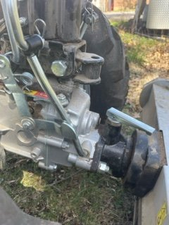

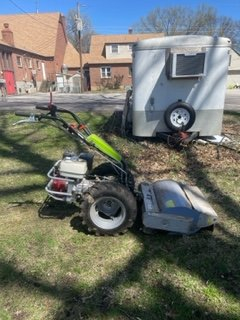

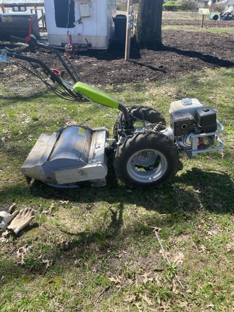

Got sidetracked! Finally got the mower out yesterday and played with it for a few minutes. I did not try this, but I will. I've felt that the mechanism you describe in the last paragraph was the issue, but I have the same issue on my old G85d as well as my new 107, and it was like that from day one, so I wouldn't think the mechanism would have been messed up on the new tractor. But the issue persists. I took some pictures. In the first picture, with the mower behind the engine, the mower engages and runs fine just like my tiller would. But, when the handlebars are reversed and the mower is on the front, nothing happens when I engage the PTO lever. Pic 3 is the PTO lever. To answer travisbb, about "engaging the PTO", I simply meant that I pull the lever until it stops. It seems like it goes all the way, I don't feel any friction and it doesn't seem to be stopping short of where its supposed to. But the mower doesn't run. I don't have any other front end implements to test it out on.
Since the issue persists on both tractors, old and new, seems like it would be a problem with the mower? But it runs just fine on the wrong end of the tractor. Could it be something to do with the angle of the implement on the tractor? I don't know! Thanks for all the help!
