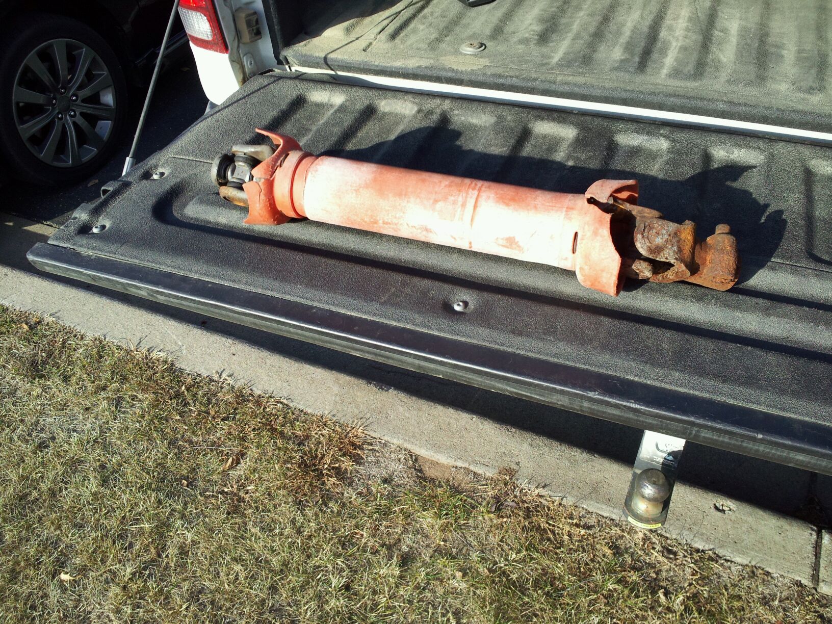

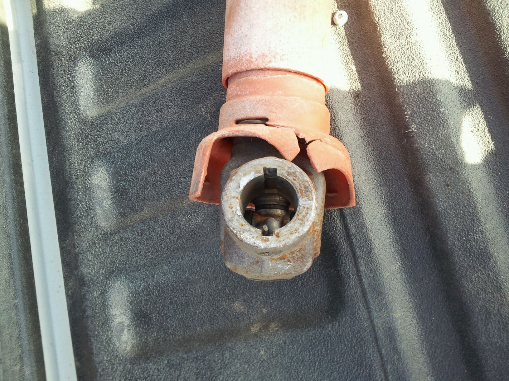

I bought this Ber Vac 60" snowblower last year at auction for a steal, however didn't do the research as much as I should have. It has a 1 1/8" double key PTO yoke to attach to the blower and my tractor has an 1 /3/8" 6 spline pto. The PTO Shaft that came with it is seized because it is all rusted up. Does anyone have a solution? I need a new pto that can attach to the snowblower with an 1 1/8" double key but then on the tractor end a 1 3/8 6 spline. See the pics of the PTO shaft and any help would be much appreciated. Thanks!!!

If the two sides will move (ie: extend), take it into a tractor (or driveline) shop and have them change out the "crosses" on the ends. That will replace the + shaped piece and all of the bearings at both ends.
If it wont extend, I would set it in a bucket of 50/50 diesel/ATF for a week or two to see if that will loosen it up enough to move.
Edit: Last time I had one done, it was $20-30/end to replace the "crosses"

You can get a new pto shaft at a a place that deals in drive lines if you are in a hurry. Otherwise, you have to remove the guards( look for a snap ring at the u-joint end)s and the use the "blue flame wrench" judiciously and a lot of penetrating oil to loosen the stuck shaft. There is usually a grease fitting on those shafts to allow greasing of the sliding joints.If there is pump a bumch of Grease in there can help.

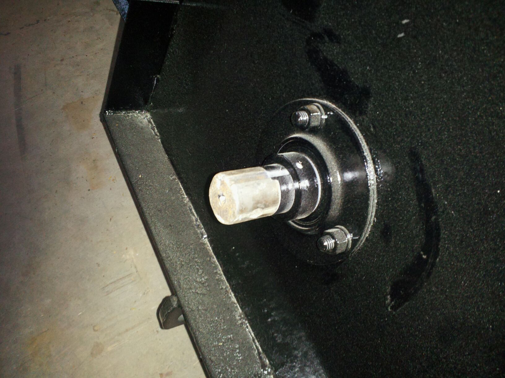

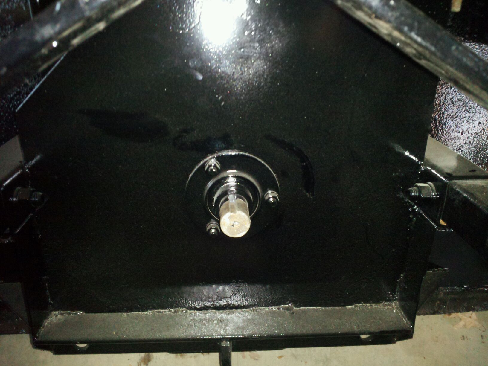

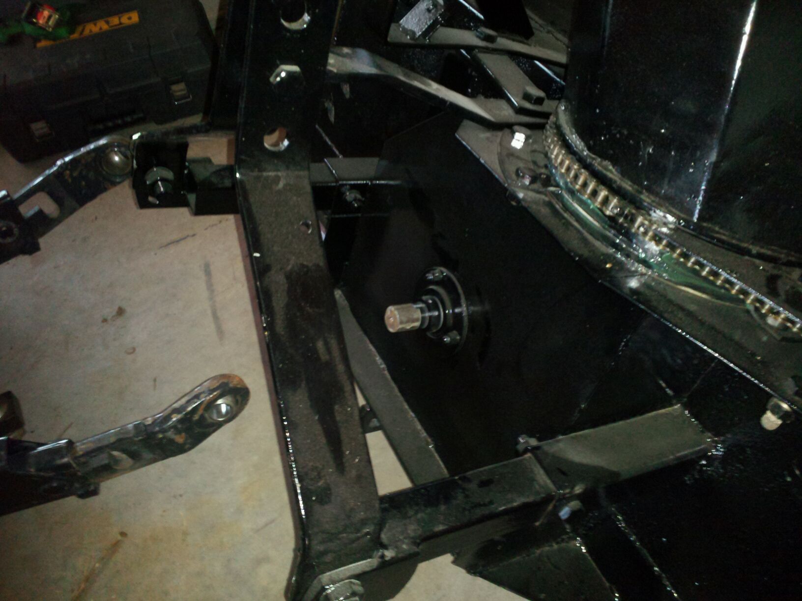

Just added more pics for clarification on what I need. Can I take the implement yoke off the current PTO and swap with a new one to modify?

looking at the pictures of the snowblower input shaft,
i can't see the 2nd keyway, is there one hidden on
the bottom not visible in the pic?
if not, you can probably get a single keyed yoke of
the right size.
yes, you can change yokes/crosses but it takes a little
time, and can be a little tricky for a novice.
did you try a little soaking or heat
to get the shaft freed up?

All I see in your latest pictures is what I believe to be the input shaft to the blower gear box. Where is the driveline shear coupling? It should go on the blower input shaft between it and the pto driveshaft. The blower input shaft has only one keyway and that keys the shear coupling to the input shaft. The other half of the shear coupling with two keys into the pto.
You need that shear coupling to protect the tractor in the blower eats a big rock, a branch, kid's bike, etc. There should be another shear coupling on the auger drive.

On your Bervac there are 3 shear bolts.
Your auger si split with the gear box in center.
Th 2 auger shear bolts (5/16" grade 5) are located near the outer ends.
Be sure to grease the augers (note zerk nipples for each side)
The fan shear bolt is a grade 5 1/4" bolt located on a tab that aligns with a tab on the shaft.
I have the exact same 60 inch blower mounted on my 20 HP Mitsubishi and it has served me very well for the last 6 years, and that in heavy at times snows.
Bervac is located in Drummondwille here in Quebec.
The only real design flaw that I found is the supports for the fan blades are of very thin material and they rot away as paint never reached them.
That I corrected by replacing with 1/4" X 2" flat carefully cloned (for balance) and welded to replace the originals.
As to the PTO half shaft U need, it is a very common shaft and U only need the tractor half. If I recall the shaft is 1" X 1 1/8" square type.
