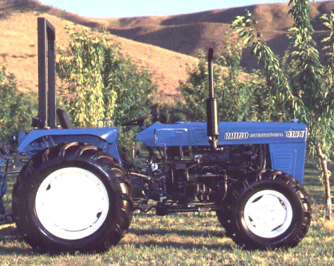

Would like to see some pics of the Benye, i found a picture on another site and it does appear to resemble the Rhino 3134 and 4134 -heres a link http://img1.wikia.nocookie.net/__cb...images/c/c6/Rhino_International_4134_MFWD.jpg

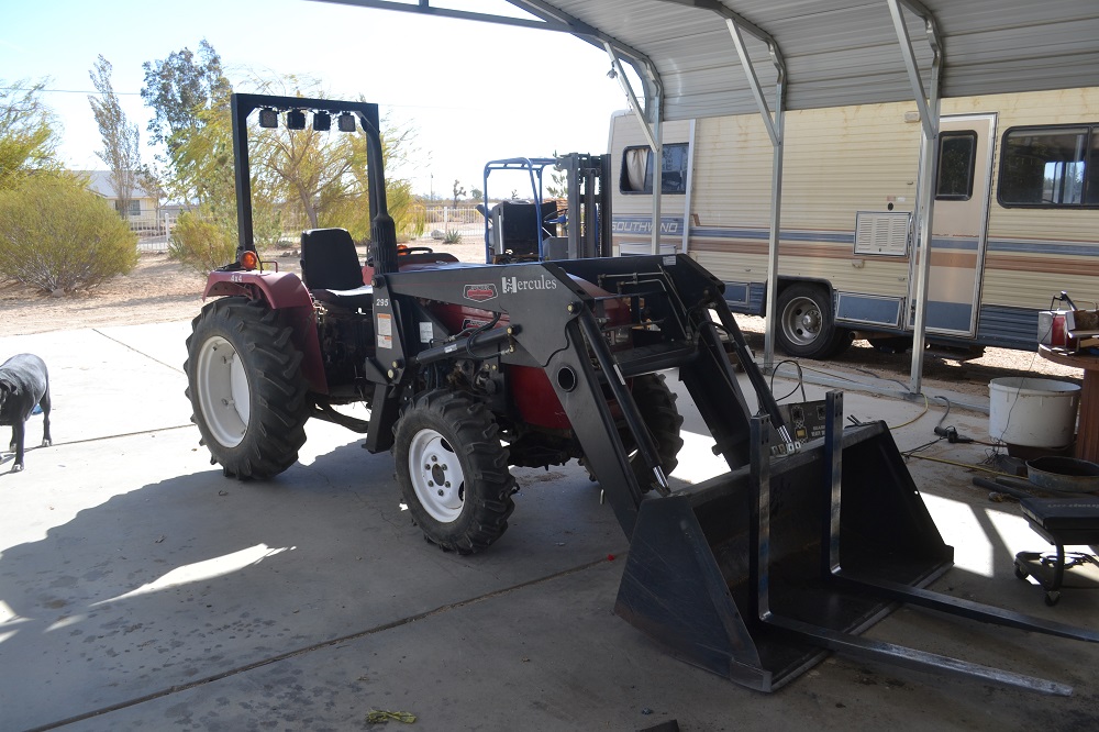

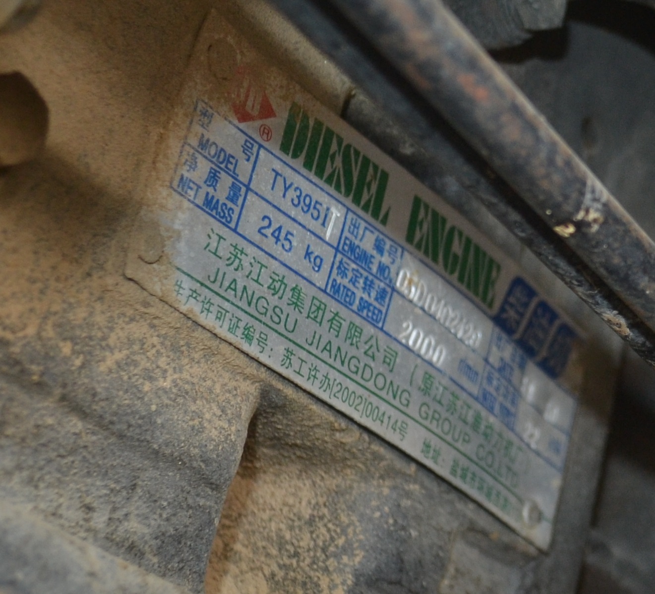

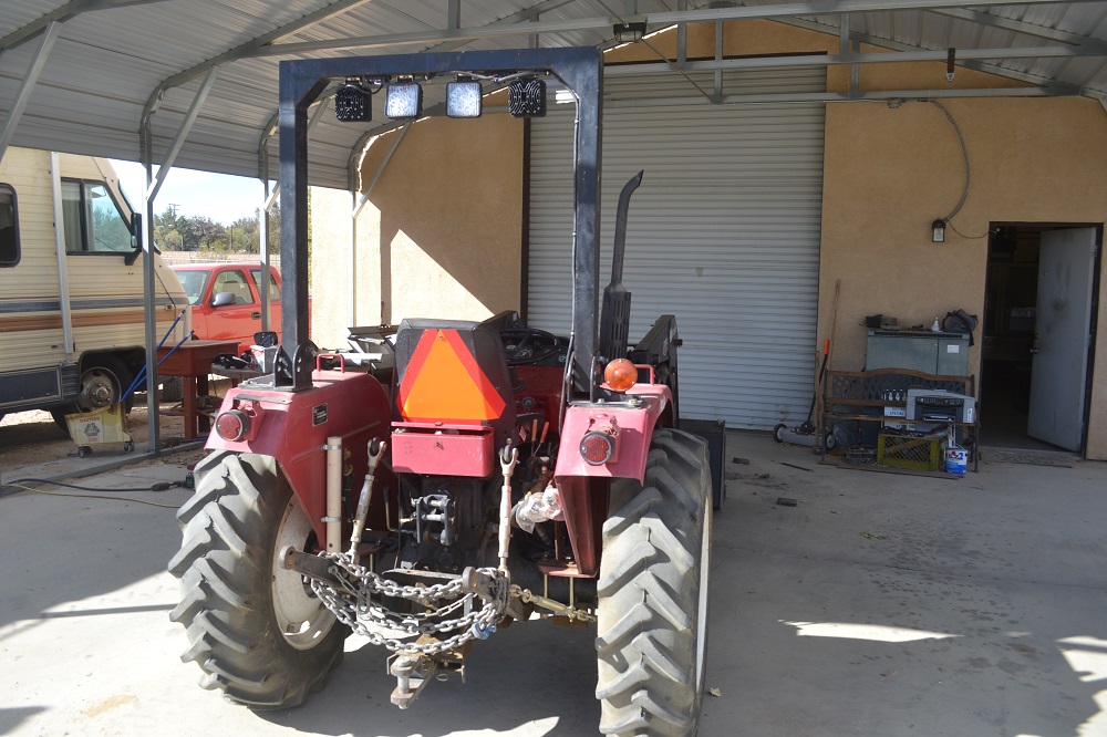

OK, Here is the engine tag, This should be some good stuff for finding info
Front View of Tractor
Rear View

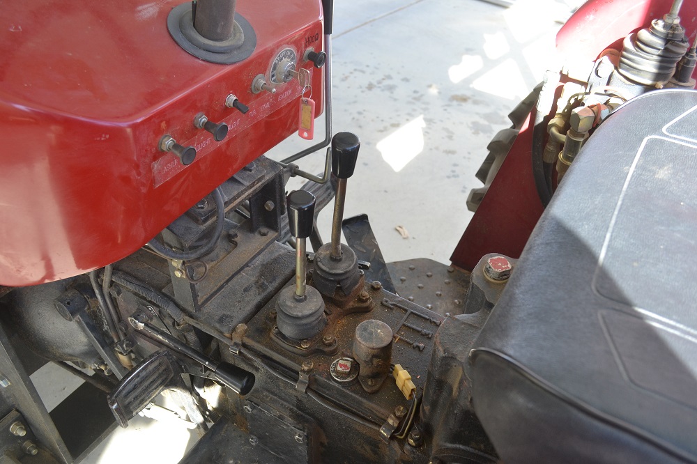

Gear set layout
Anybody recognize this thing?
Thanks in advance!
Wayne

Well Dan, I really cannot get a close enough view of the Rhino, So Im getting some clues
on using the number on the tag TY 3951 TY 395 or just plain 395, I just need a referance
to cross that number to something

/ Benye tractor info #15
Yeah- they're in Tennessee so need to call by 2 pm ? I think there are several 395 engines - the chinese like to use pretty generic engine id
Generally a 395 means the 3 is for 3 cylinders 95 is the bore in millimeters . My engine is a 495 so 4 cylinders and the same 95 mm bore, but as far as I know no common parts with say a 495 engine built by a different chinese company.
The little prefixes and suffixes? can make a big difference as well as the manufacturers name on the data plate.
I have also heard that there can be more than one manufacturer of an identically designed and spec-ed engine . Like the Willys Jeep and Ford built Jeep engines during ww2.
Just found this out of an old thread- 02-19-2013, 10:18 AM #16
Affordable Affordable is offline
Advertiser
Platinum Member
Join DateMar 2004Posts1,340LocationTexas
Default Re: Rhino International tractor
We have the engine parts for the TY290, Y380, Y385,TY395I, TY395E-3, TY395E-1, Y480, Y485, KM385, LL380,SL3105BT,SL3105ABT,490,Perkins 1004,plus prob. a few more that I did not mention.
looks like Affordable may also be able to help, at least with the engine since they list the TY 395I
