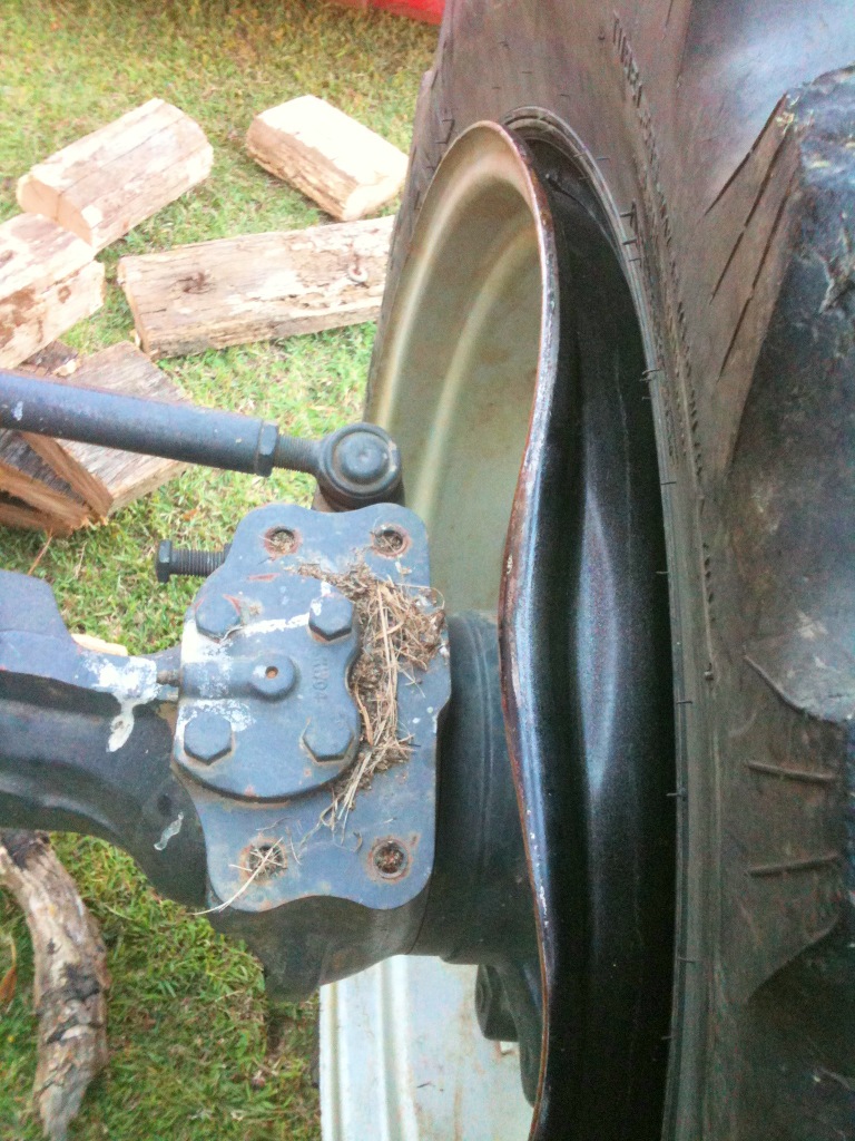

G'day,
I've somehow managed to dent the front RH rim on my Mahindra 5500 4wd this weekend. :ashamed:
Have tried to pump the tyre up, but it won't hold any pressure at all.
Wondering if anyone knows, can these be fixed (ie, panel beaten), or am I up for a new rim?

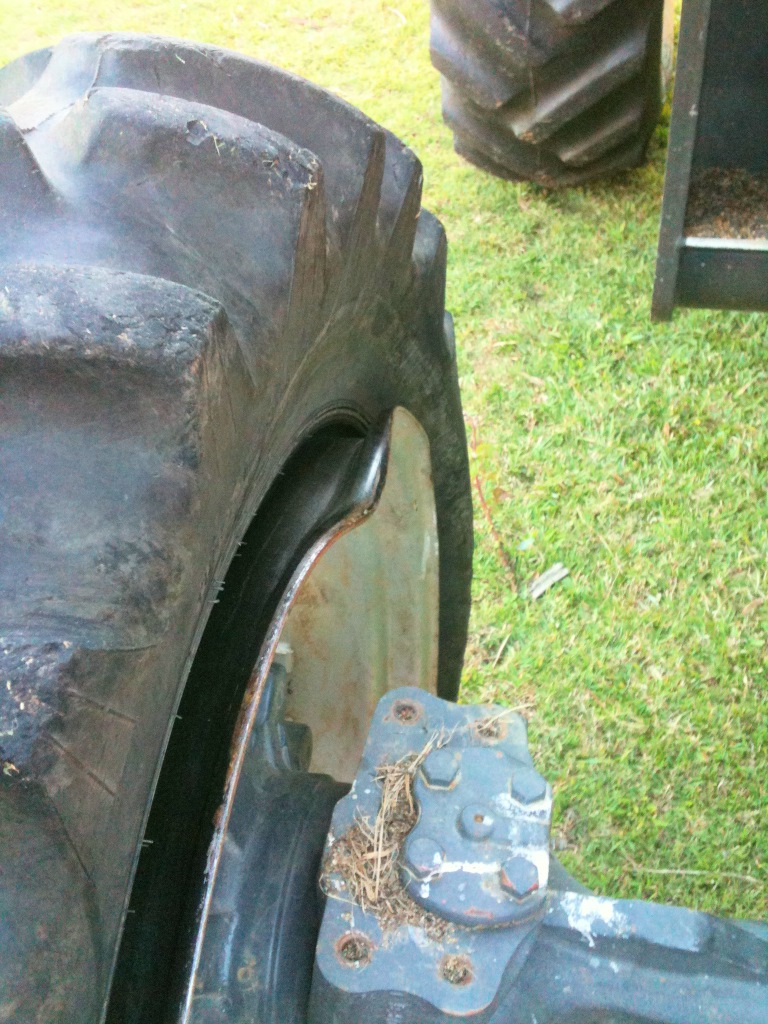

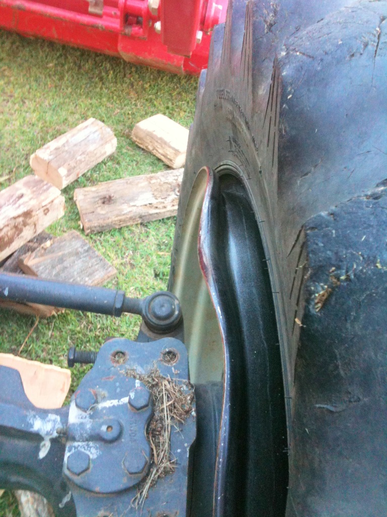

OK, so we got to work a bit late this morning, which gave me time to take some pics just after sunrise. :)
Thanks for the advice so far, and keep it coming!
(and yes, I'm still very :ashamed:)

/ Bent Wheel Rim? #8
That looks serious. But I would try a maul with some well placed blows.
The inner bend would be my main concern.
Might be able to get some success using a press.
Thanks for the pics.

Upon seeing the pictures, I strongly suggest you replace the wheel...especially if you have a loader on your tractor.

G'day go get the hammer out :thumbsup: that will knock back nearly spot on i would say if you think it is beyond you talk to a local tyre dealer and ask them if there is anyone in the area that will roll the rim for you, if they can't help talk to a local engineering shop. There is no reason that rim can't be repaired

If hammering back, be sure to use a spacer so as not to hit the lip of the rim. It will deform before you get the rest of the dent where it needs to be. Don't ask how I know.

Thanks for the input all, we gave it a few "gentle taps" with a sledgehammer, and a block of wood, and it appears to be good as new. Has held pressure for over a week no problems, haven't done much work with it (didn't get to play this weekend as one of my dogs got hit by a brown :( ), but will keep and eye on it and see how it holds up.
