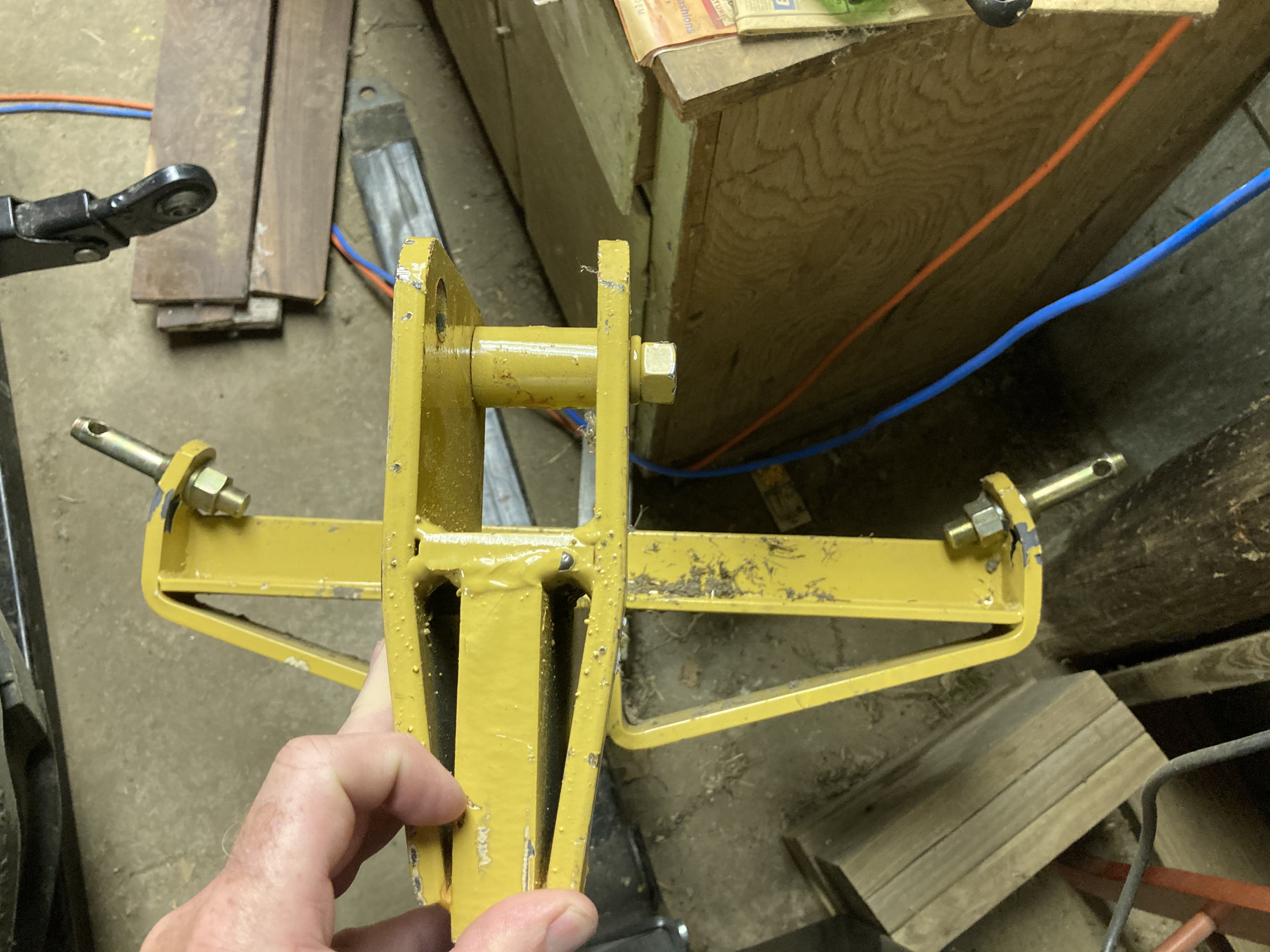

The other day I decided to go out and do some subsoiling to improve drainage and compaction. I didn稚 go very fast and didn稚 think I was being rough of the subsoiler but when I went to take it off I noticed I bent the subsoiler frame where the 3 point pins are. I知 not very knowledgeable about metal working so it was wondering what you guys think I should do. Try to heat it and beat it straight? Would a jack push them back straight or just leave it as is? Thanks.

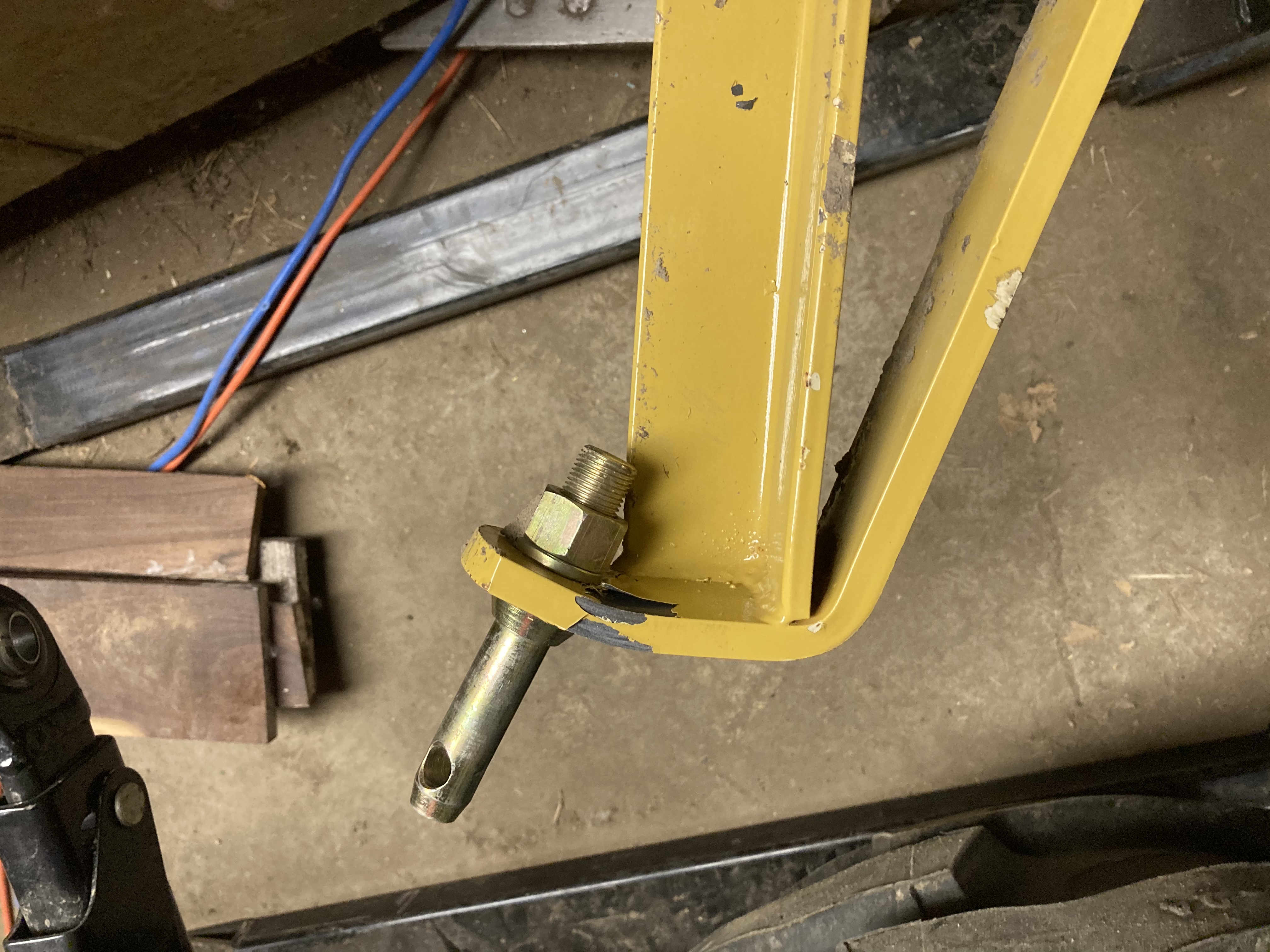

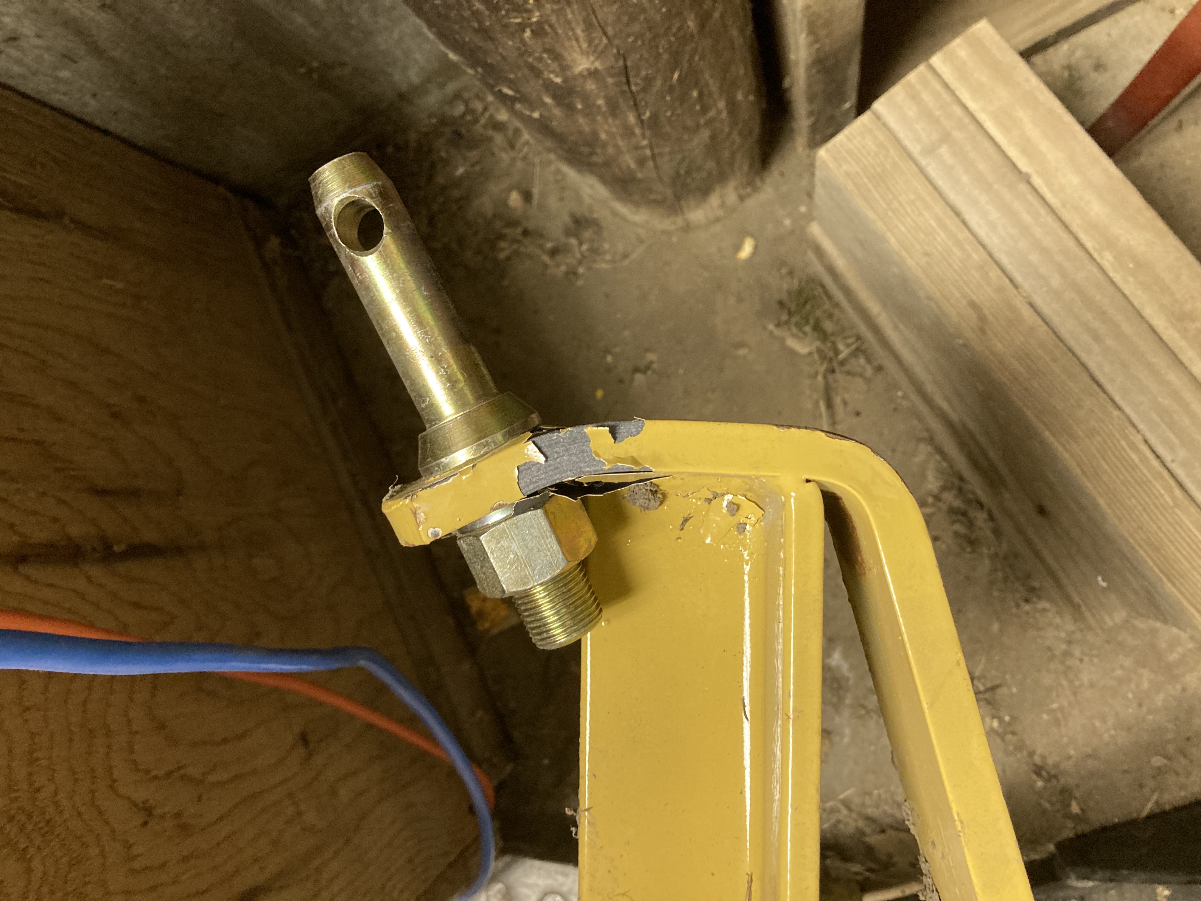

It’s the cheaper one I have. Guess I learned a lesson. Here are some pictures. C5AE83F2-6ADC-446C-8D65-36559BAFF09E.jpegE528944A-3F7F-405C-A4E8-180783FDF24D.jpeg816ED0A1-FA47-4E40-B3A8-A05889FA9940.jpegC5AE83F2-6ADC-446C-8D65-36559BAFF09E.jpegE528944A-3F7F-405C-A4E8-180783FDF24D.jpeg816ED0A1-FA47-4E40-B3A8-A05889FA9940.jpeg

Soft, or poorly hardened steel.
Remove the pins, and straighten the flange with a long pipe wrench.
/ Bent subsoiler #8
Take the straightening advice above then reinforce with a 2nd layer of steel on those ears. You might find the other weak spot(s) the next time you use it. There is a lower chance that you will find your tractor's weak spot by using this light weight tool.

Rather than bend,, (which will typically end up bruising your knuckles before you are done,,,)
I would cut those "ears" off and replace with "ears" that are twice as thick,,
OR, if the welding of such thick metal is out of your capability,,
fabricate a connection that uses double ears on both sides, with a pin going through,,
With double ears, the plates only need to be 2/3 as thick, and they will easily resist bending.
So, it kinda boils down to what steel you have laying around, and how thick of steel you can weld,,
By far, the double ears on both sides will be the best,,,
/ Bent subsoiler #11
Get the ears straight and add simple gusseting to box it in. Leave room for a socket for your nut.
/ Bent subsoiler #12
My guess would be a combination of cheaper import steel, over HP for the implement, and hitting some solid relatively roots. The metal is mow fatigued at both bends. Straighten it! Reinforce it! (You have 2 suggestions) I suggested do both if you plan to continue to use it.
Go behind the cross brace that comes around to form the bend portion and go out to create a slide in out pin holding frame.
Then from the current outside edge of the ear (after straightened) go from there to under the bottom of the cross brace.
Doing both will create a very strong pin joint (assuming you can weld these new pieces in solid).
Good luck on your repair!

Thank you so much for all the help. Wish I could say I fixed it but not yet. I did get the pins out and tried bending with my pipe wrench but I could bend the ears. I don’t have a pipe big enough to fit over my pipe wrench handle. It looks to me that even if I get them bent back they will need some additional support. The ears are 1/2 steel and that’s beyond my very limited welding ability.
For now I guess it’s use as is or find a shop to cut the ears and weld new support on. Thanks again!
/ Bent subsoiler #15
That probably would have broken the draft arm mounts off a lesser tractor. A 3-pound hand sledge will probably straighten those tabs out. I'm not sure I'd beef that up. You want something to give besides your tractor. Go slower so you can "feel the drag" and/or go to depth in two passes.
