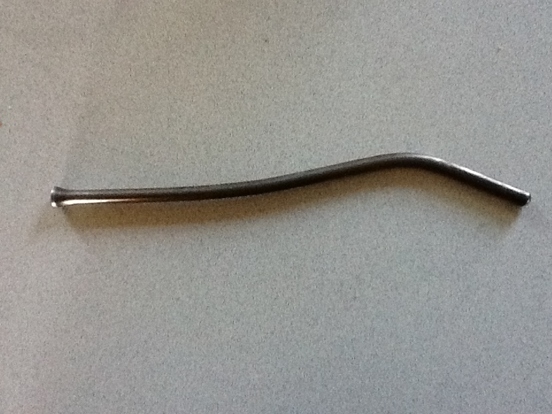

My Ford 2000 gas 3 cylinder stated running really rough - after investigation I found # 2 cylinder had no compression. I took off the valve cover and discovered it has a bent push rod. I can tell the bend is well down toward the tappet, but have not pulled out the push rod. The push rod rotates slightly and is loose. Can I replace the rod and start the engine, or is there potential damage to the tappet? ...any suggestions?

My experience with bent pushrods is that they are usually caused by a valve thats stuck in the gude and that usually occurs on engines that have been sitting for quite some time. As the pushrod pushes the rocker up, the valve does not move and something has to give. That something is the push rod buckling under the load. If the push rod isn't too badly bent you can starighten in and reuse it but before you crank the engine again spray something like brake cleaner, Liquid Wrench, ATF, etc down the guides to help them release the valve stems. Make sure the valves are free before you try to start up again.

OK, I have pulled out the push rod and it is bent at the bottom next to the tappet. Upon Jerry's advice inspection of the valves revealed one in totally seized. I sprayed it with penetrating oil and was able to tap it down and it will not budge upwards. So, now it is " off with her head ". I will need to do a little research, but i am hoping I will not have to remove too much of the front end of the engine. Any Ford 2000 input is welcome. While it is off I can rerun the fuel lines, install a new fuel pump and maybe even install a new radiator. Will post pics...

I would try to get the valve to move back up with the spring plate first. Do you have access to a slide hammer? Try to get it moving and get some penetrating oil down the stem. It moved down, it could move back.
I'm going on the idea that it was running on the other barrels all the time since you got it and the valve had been stuck a long time and could have originally stuck from lack of running for a long period. If you can get it moving again and put a little top oil in your fuel, you might dodge the bullet. I've had a similar situation with a car engine once and once it was moving again, never had another episode. I'd try that first. That's if you're not out there pulling the head right now.
On edit, it looks like the lift on that valve is now farther than normal. I would not crank that engine, except with the plugs out, and then, very carefully by hand until the valve is clear of the piston. If the valve is not clear, the piston might start it moving back up. Go easy. I'd try pulling it up with a slide hammer. I have made one for a job before. It's not too hard to do if you have a lot of junk laying around.

looks like the rocker was rolled over, after removing the bent pushrod, so he had access to the valve. The valve was pushed too deep in the guide manually and is now stuck "way open", probably by carbon deposits on the stem

Correct patches - on these fords you can move the rocker arm out of the way once the rocker adjustment is loosened...or in my case the push rod bent and was not even touching the rocker arm.

Tcartwri - I bumped it down with a hammer. When I removed the valve cover all were basically level.

I have a Milwaukee optical scope and will look around through the spark plug hole to see if I can see any damage up on the valve head itself or on the head of the piston. Still looking to hear from any Ford guys on how much of an ordeal the head removal is, if any. If it's not too big of a pain I would rather tear it all off and have all of the valves checked out - I have a guy who has rebuilt several heads on some of my cars....many of which had seized valves. Mind you all of these car engines were in cars that had been idle for many, many years. Tomorrow I will grab a small gear puller and make a small slide hammer to hopefully move the valve back up.

My guess is that that valve stem is also bent.
Heck, head jobs on little gas engines are no big deal, just pull it and do a valve job while you are in there.
I wouldn't want to keep pushing/pulling that valve up and down, just take the head off, remove valve spring(s), tap it through. Roll it on a block with the valve head hanging over the edge to see how much it is bent, etc.
