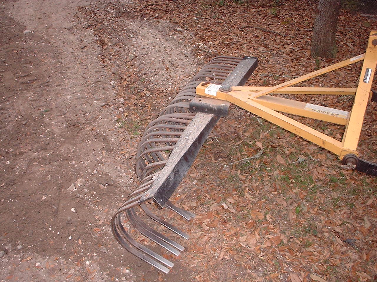

On the last swipe of the day, I backed into a small tree and bent my rake. If I remove all the tines and take this to a heavy equipment shop, could it possibly be bent back?

I try heat large hammer/pipe wrench for bending,but if number tines are damage might be wise as you suggested.

Ouch! Might take appart and put in a press. I have worked on angle like that before and get close to orig. specs. with a 20 ton hydraulic shop press. (You know, the ones that use the bottle jacks.) They work great to straigten out lower link arms, bent A frame members, and pressing in u-joint crosses!

I second the press. Everything I have ever heated bends back.

Or consider buying a piece of angle iron, and drill the holes to make a new piece. Local welder may be able to blow off the top bracket and weld it back on your new angle. Just another option you can toss around.

I second the new piece of angle iron approach. Bending etc will get it close but never quite the same -- JMHO

I straighten angle iron cold all the time. Get yourself a couple of big old Stillson (monkey) wrenches and a couple lengths of pipe for cheater handles. Those wrenches will take a solid grab on the web and you can work one against the other or just one against the piece held in a solid vise. You'll probably need to overbend by about 10% to accommodate the "springback" effect but you can do it. Better to do it cold than hot since you're not softening the steel that way. The re-bending will actually work harden it a bit and make it tougher some times. With some care, you may not even have to remove more than one or two tines.

I removed all the tines and took it to our local heavy machinery shop. They put it in a press.
Cost $25....but it's good as new.
