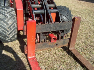

My Pt-1445 is an older one with only 1200 lbs lift. I probably could increase that with new larger hyd cyl. The set up that I put togather probably weighs about 175 lbs. I don't think I will ever bend them. Don't even try and buy new forks, about $300. Used ones for about $35 or $40 bucks. It will even take one of those carpet poles. or hay forks. One can make lots of equipment to hang on those fork rails. I made an engine puller out of one of the forks, and each of the forks have a one inch hole for a 2 in ball to move trailers. I was even thinking of putting a mini-hoe on the end of one of the forks. Seems like it would work. The little square receiver in the middle is for heavy weight towing . You could probably dig taters /forums/images/graemlins/grin.gif with forks tilted down.

<font color="blue"> Did it take allot of heat in a large area before you could bend it? Looks like sore arm coming up. </font>
Well, Paul. You've seen me in person. I'm not an imposing figure by any means. So, my advice to you is this:
First, it helps if you get angry at the forks /forums/images/graemlins/wink.gif /forums/images/graemlins/tongue.gif /forums/images/graemlins/grin.gif
But seriously, it wasn't like I was the village black smith or anything. It only takes a few whacks here and there to get it looking straight again. I put the heat on the area that I viewed from the side as the deformed area. It was about a foot long curve. So I did about an inch wide area at a time. Heat across the fork with the little torch for a few minutes, then give it a few really hard whacks and put the heat right back on it to keep it warm while I inspected it. Heat a little further down the fork, whack it a couple hits and heat some more. Surprisingly, it only takes a few wacks in key areas to get it corrected. The key was to keep the heat on it once it is heated up. The large area of the forks is a great heat sink, so it will cool rapidly and you will have to heat it up all over again. I doubt I used more than 1/4 of the little propane bottle and you can get those at the hardware store for just a couple of dollars. Very economical fix. And if you don't have one of the little torches yet, it is a good excuse to buy a very handy tool for under $20.00. And I wasn't sore afterwards at all. Just make sure your sledge hammer has a good handle, make sure you have a safe area to rest the torch while you hammer and wear ear plugs. Safety glasses, too, just in case something chips.

The bent fork was the right one and it was bent down. I heated the metal close to the plate and then rotated the fork down into the cement floor applying pressure on the right fork with the tractor weight. Then took a 20lb sledge and hit it from the top. Came pretty close to level.
Thanks to everyone for their advice, was easier than I thought.
