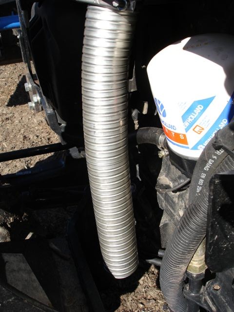

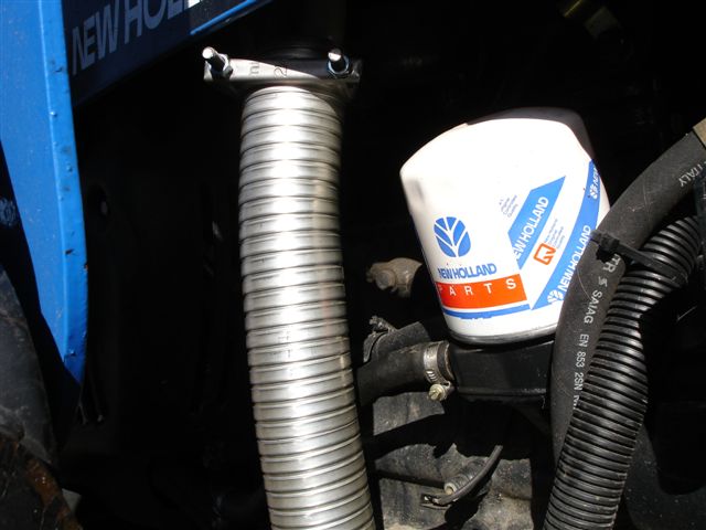

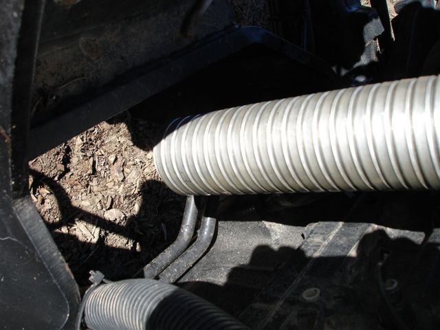

Well, after all the excellent advice here, I removed the bent exhaust and atttached a 18 inch flexible exhaust pipe. I am happy to report that the tractor runs fine. The exhaust is "clear" (no obvious smoke or particulates) and although the pipe gets hot, the exhaust is remarkably cool at the tip. After running it for an hour on a cool day (40 degrees) none of the adjacent parts get warm (the oil filter does, but that is to be expected). If the flexible pipe was 6 inches longer, it would clear the frame completely and might even be a permanent solution :D . Maybe some nice black exhaust paint and no one would ever notice?

Bob,
One of the most annoying thing on my CUT is that the exhaust pipe pointed down just behind the front tires. When it's dry and dusty outside, the exhaust would be like a fan blowing down, which caused the dust to fly up. It got so bad that I stuck a crow bar into the end of the tail pipe and just pulled as hard as I could to turn it out.
It's either soft metal or it was hot enough to bend, because I was able to put enough turn into the pipe to have it exit the side.
I would never own a tractor that sent it's exhaust straight down, but from the looks of your setup, you can fix it pretty easy when things dry up and get dusty.

Chrome :D ! Sounds nice. Maybe hang some nice nice on the dash while I am at it with the chrome pipes :). One friend described my flex pipe solution as "ghetto". I will dry fit the new pipe next week and see what happens. IF all goes as planned, I will have the bent pipe fixed and then have a spare I will never need since I will not reuse the 4 inch extension and therefore never bend another exhaust pipe.
