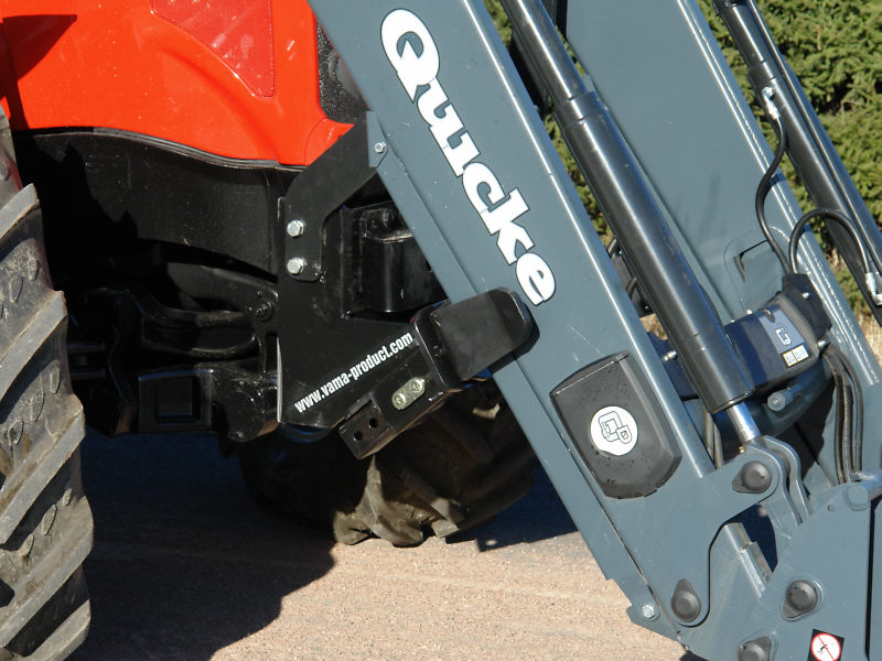

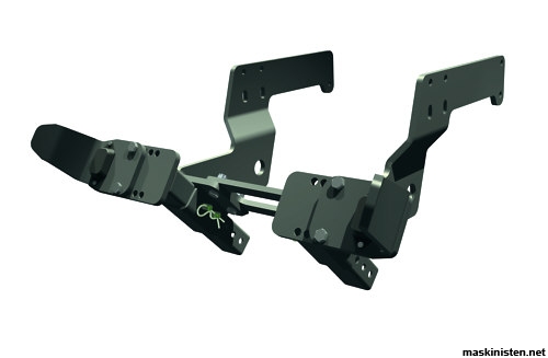

I'm with the Finn. Commercial snow clearing here in Scandinavia is done at much higher speeds than when you just clear some driveways, and the side forces can be huge when you hit a curb or a frozen ice berm. All smaller machines use subframes or steel beams from the hitch all the way under the tractor. It also puts the force low where it should be. On bigger tractors it's still rare (except wheel loaders) but it does exist. The biggest manufacturer of FELs, Aaloe-Trima says you absolutely must use the special side supports in that case.
Here are some pictures of these supports, both commercial and home made:
Snöblad på frontlastare. Bilder på plog-/lastarstöd? :: Maskinisten
Plough support
BR,
/Marcus

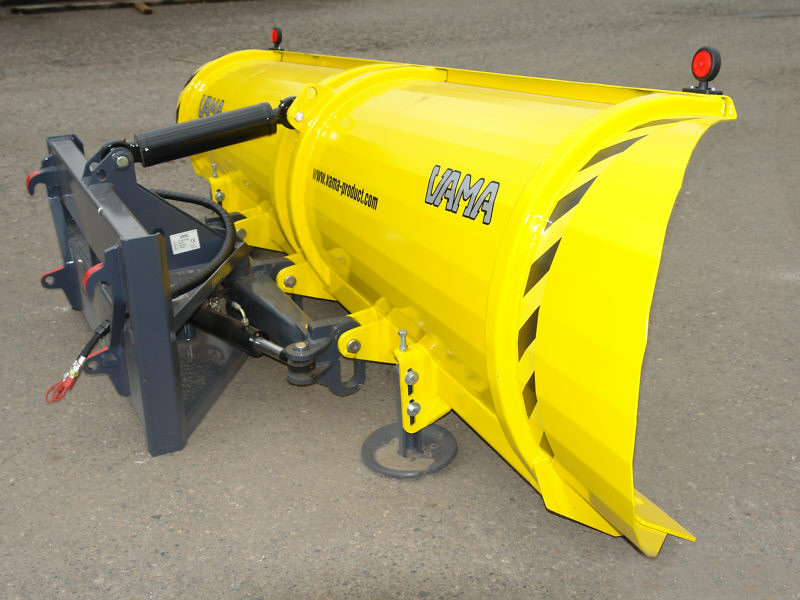

It does look like it would provide lateral support, but it seems that it would only accomplish that if the FEL was all the way down. If one operates by riding the stick and constantly changing elevations, as soon as you leave the "pocket" the support is gone. Here are some more photos:
http://www.vamaproduct.com/fi/images/stories/auraustuki/Vama_auraustuki_1.jpg
http://www.vamaproduct.com/fi/images/stories/auraustuki/Vama_auraustuki_2.jpg
http://www.vamaproduct.com/fi/images/stories/auraustuki/Vama_auraustuki_5.jpg
http://www.vamaproduct.com/fi/images/stories/auraustuki/Vama_auraustuki_8.jpg
http://www.vamaproduct.com/fi/images/stories/auraustuki/Vama_auraustuki_6.jpg
As an aside, I really like the the apparent strength of their straight snow plow attachment system.

That is a strong setup. I see that the plow is free to float about five inches in those slotted push pin holes and can trip the whole blade against that center top shock absorber and that angle of attack comes from the dump on the loader hitch. I wonder if there is any relief in the angle piston?
What would the advantages of that be compared to floating the plow? Unless I'm going very slow or doing something special, like carefully pushing snow out over a grass surface, my experience is that it's impossible to adjust in time anyway.

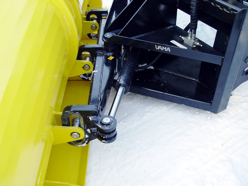

Snow ploughs
says : " Two 2-way cylinders equipped with relief valves"
Also note how close to the machine these plows are mounted with the use of "side-mounted" angling pistons.
/Marcus

/ Bent cracked loader arms #48
/Marcus
I rarely operate faster than 3mph, and the areas I work are unchanging; I know the roads sufficiently well enough to anticipate every (and there are many) obstruction. Like I said, these roads are like goat paths in terms of their smoothness. Floating would have the blade tripping every 5 feet.
