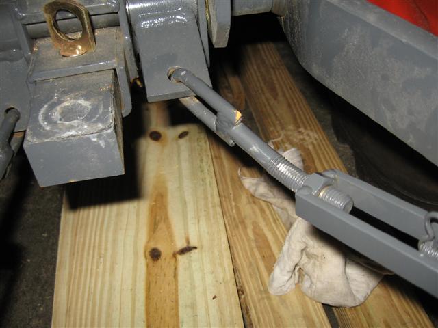

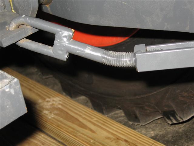

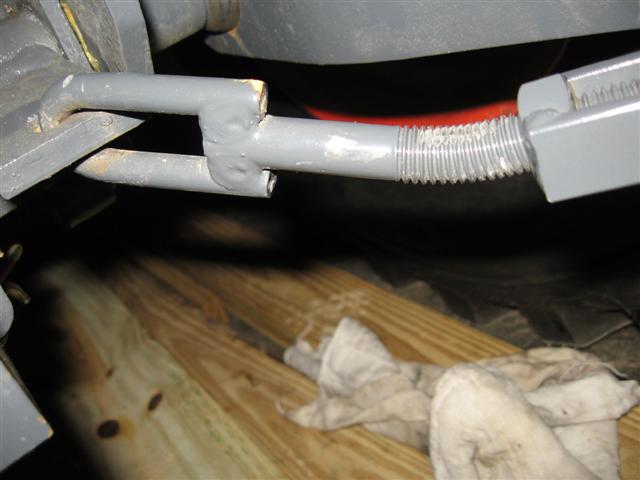

After a day of pulling logs and brush and raking over a few washouts on the road I noticed I had bent the upper half of my right check chain. I had a big clevis attached to my drawbar and think it must have swung wide and got over the check chain before I brought up the 3 pt arms but this is only a guess. Is it a problem? How, if possible, can I bend it back? Should I get it replaced?

I'd try to bend it back...nothing to lose, it isn't gonna be right like it is, if you can fix it- great, if not well you need a new one anyhow...
/ Bent check chain #4
Mine on my 4150 have always had issues, but I've never found a heavy duty replacement. I'd bend it back for now, chances are it will never bother. Keep it lubed with anti-seize as well, they tend to get sticky after a while.
/ Bent check chain #5
it may have cracks in the bottom of the threads and bending it again may only worsen any cracks
so if its a safty issue replace it
it looks like something easy to make or have made

if its a self contained unit then metric wouldnt be necessary, in that case a large turnbuckle could be adaped
i have a welder and cutting outfit so my first thought is to make it myself
if they are cheaply avaliable then thats the way to go
i buy stuff when its cheaper and less time consuming, im not wedded to the i have to make it myself, too much to do
mcmaster.com has left hand threaded rod and nuts
a nut could be put at both ends on the shackle and the turn buckle that way if you bend it again just replace the threaded rod

For now, I too would just bend it back and use it till it breaks completely.
You can always order the replacement for when that happens again.

I would agree with those that say bend it back and see how it goes. I've bent a few of those and straightened them out with out a hitch. Take a torch heat it up and slowly straighten it in a vise. It will be close to good as new, From experience I have yet to actually replace one on a large machine, unless of course I snapped it in half while trying to straighten it. :)

Check chain straightened! I fix computers and the last stop today was at a machine shop. After replacing computer part I asked owner if he could straighten a threaded rod for me. He said it should not be a problem and we went over to a table vice/material holder and he took a look at the check chain and asked if it was from a Kubota. He then told me about his B3030 and I told him about my B2620.............He straightened the rod and ran a die over it to clean up the threads. Thanks George Abbott of Abbott Machine Shop in Conway, NH and thanks to everyone for their suggestions.
