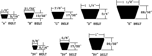

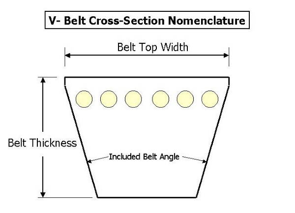

You also need to match the width and thickness:
