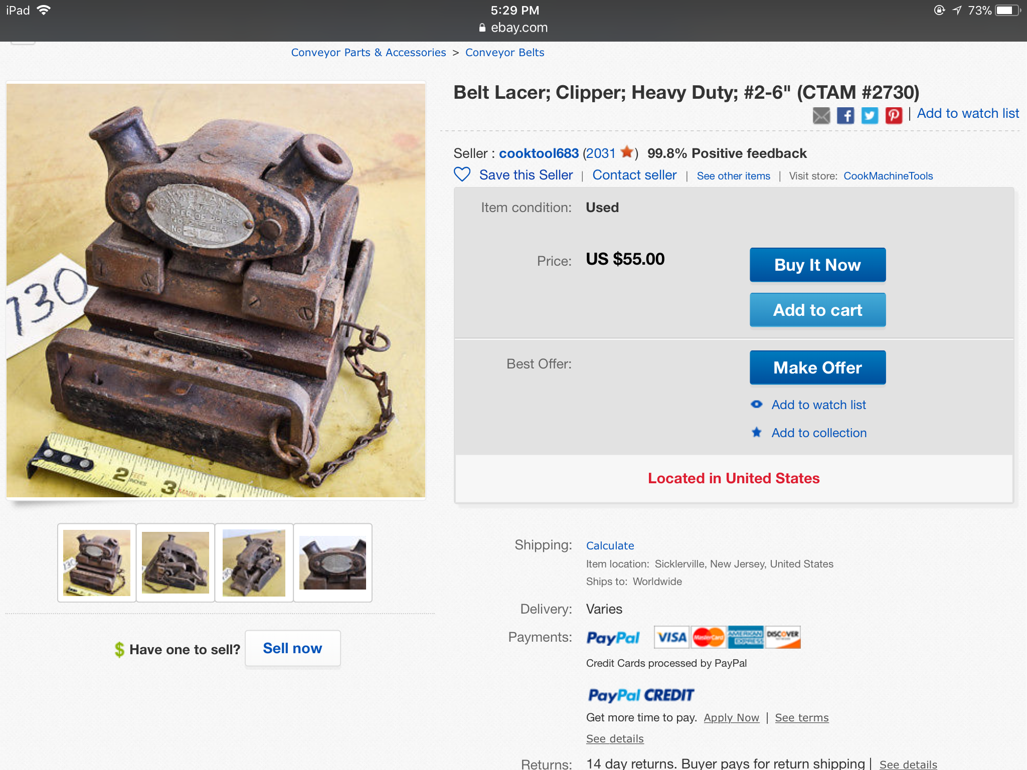

Get on ebay, and check out the older Clipper belt lacers. Much better than the type you use in a vise. For the money you spend on a vise type, for a few more dollars, you can get one of the older ones, and make the lacing job so much easier. I can't recall the name of the one I bought 2 years ago, but it isn't a Clipper. Apparently everyone was looking for a "Clipper belt lacer". I just searched for belt lacer, and found this one. I had to re-splice two belts this Spring on my Deere. Other than prepping the belt, splicing was a snap. This one is only wide enough to do 5" belts, but not that big of a deal to move over, put more lacing in the grooves, and do the rest. I got this one for $45, and as easy as it made the splice job, consider it paid for itself on the first job.

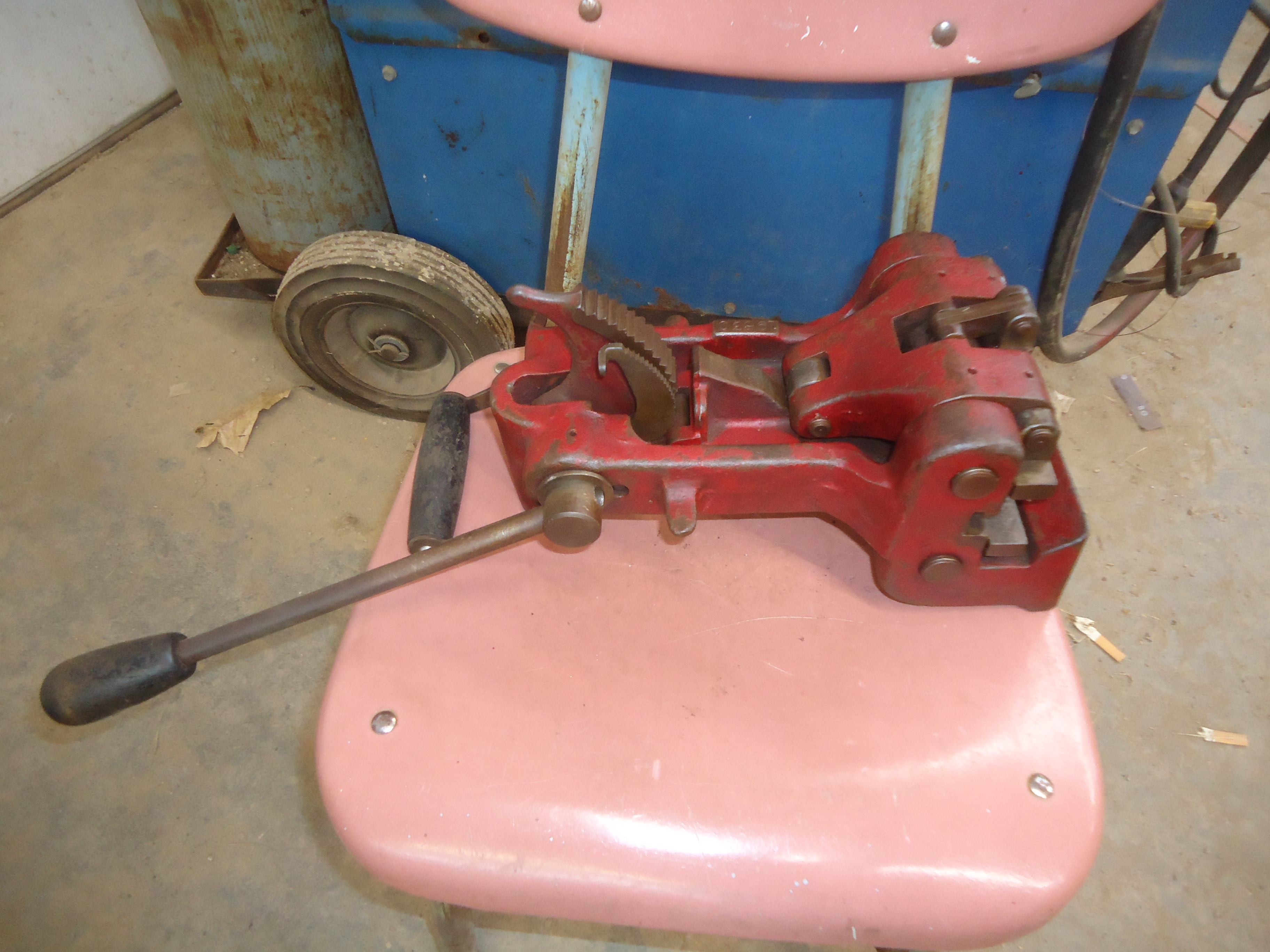

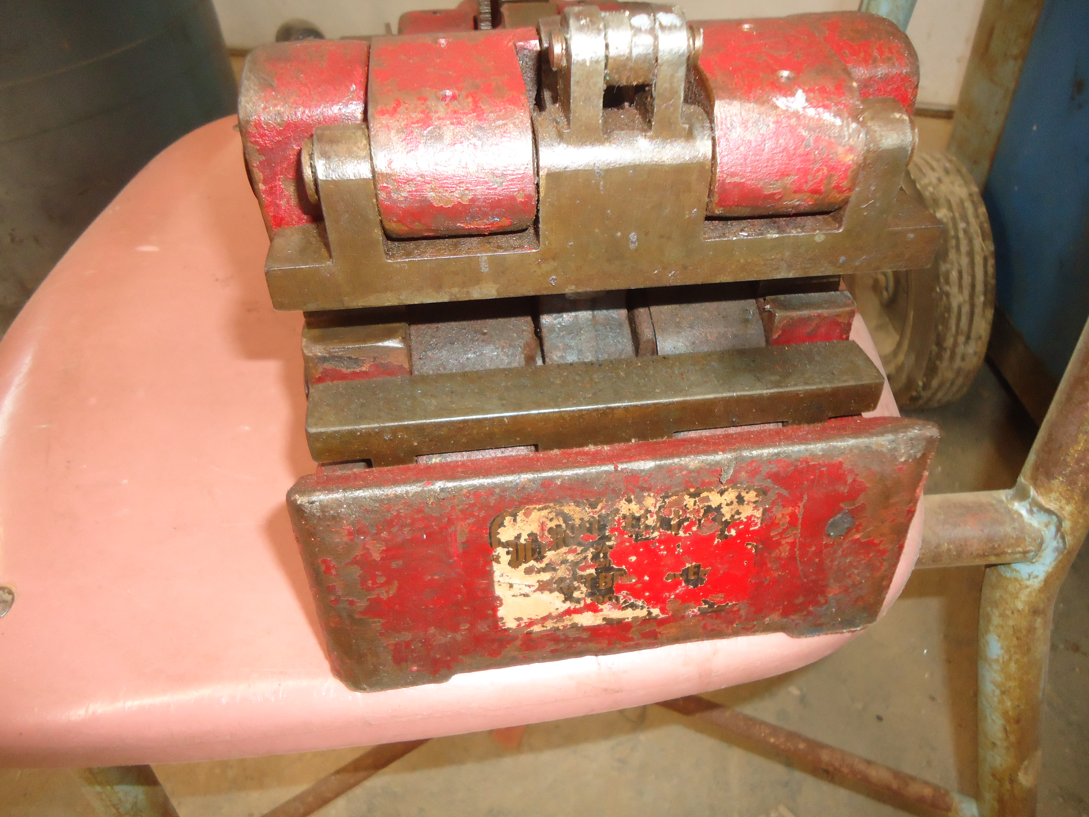

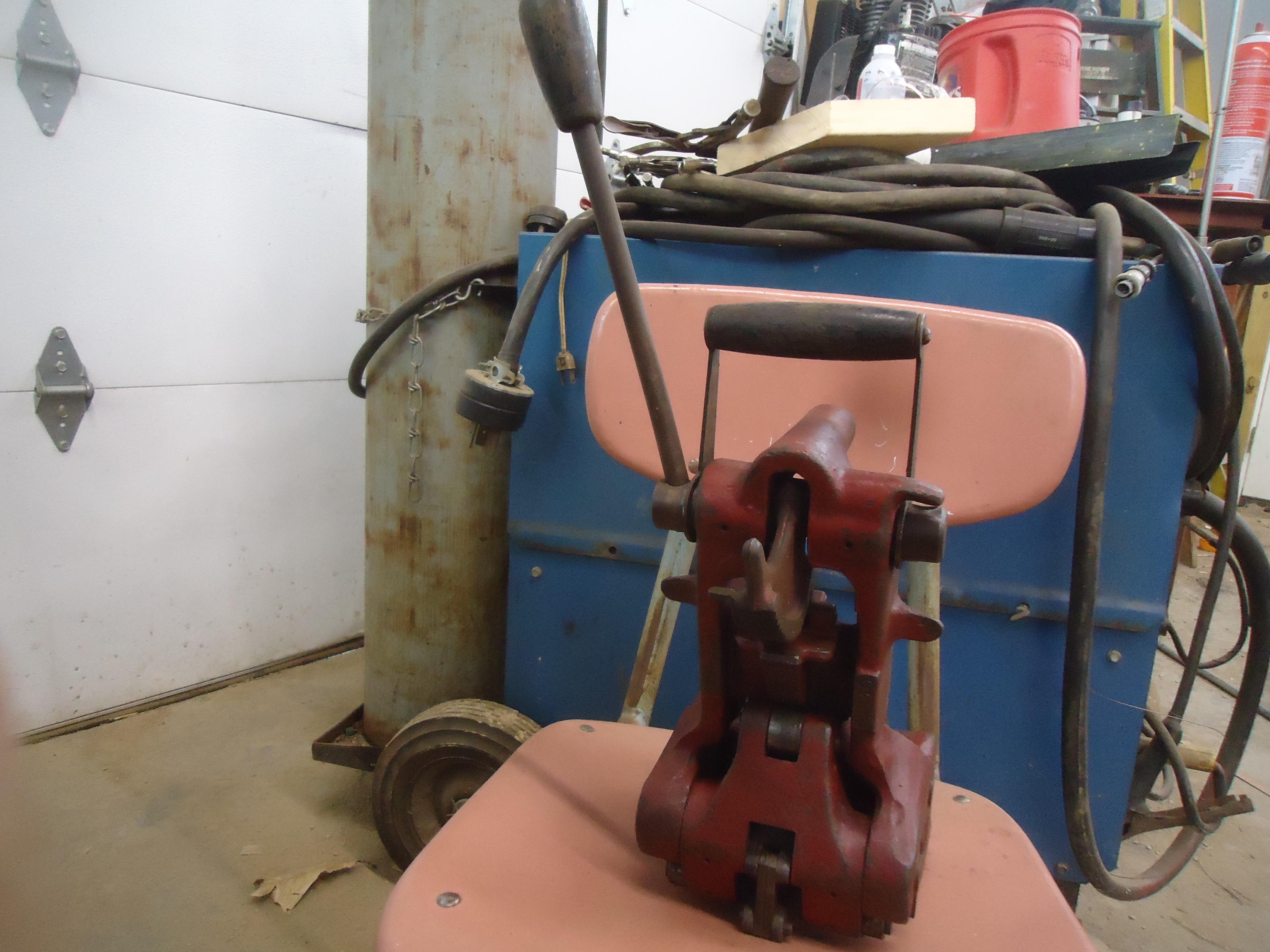

Mine's more of a portable unit. I liked it, because I figured I could take it to the field if necessary. You carry it as it stands, then lay it down to lace belts. Mine sorta' looked like that one in the sellers pics. They didn't want to clean and oil it, with the way shipping is anymore., with chemicals. I took a few pics of it today, and as you can see, it cleaned up pretty good. I was wrong on the width, the jaws are 6" wide, so my belts must be 7". Hard to keep track of things around here.
And, this one is a Detroit Belt Lacer. I looked it up on line, and seems this one was made in the 50's.
If shipping isn't too bad, and you can make some handles for it, that's not a bad price.
