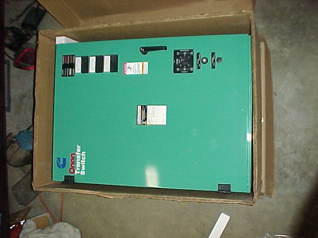

the serious side of this discussion is the hooking up to the house, always have an electrician install a transfer switch for you, the gentran type switches could be installed by a handy man. dont make the inconvenience of a power outage turn into a catastrophe of a home fire, or an electrocuted lineman.
