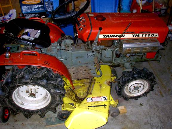

I'm in the process of putting a 48" JD mower deck (from an LT or LX 185 I'm told) under my YM1110D. The deck fit, but the front tires were going to rub the deck, so I decided to move the front axle forward 5". Attached is a photo of the deck with the tractor in the background.

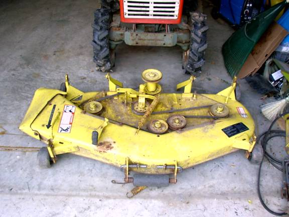

Here's a photo of the deck under the tractor with the axle in the original position.

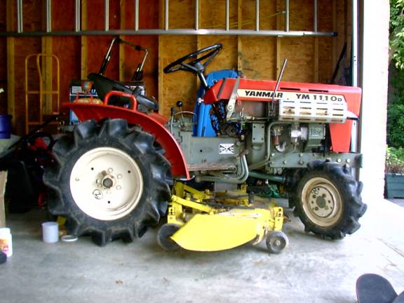

Here's a photo of the deck under the tractor after I mounted the axle forward 5" from the original position.

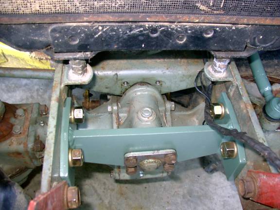

The last one (for now) is a close-up shot of the axle mounting. I used existing holes in the side rails of the front bumper. I also had to lengthen the driveshaft, driveshaft cover (which you can see in the third picture), and the steering linkage (which I didn't show here).

I have been wanting to try this on one of my little tractors. I remember you talking about doing a (the) conversion a while ago...turned out very nice. Did you remake the FWD support or is it original with new hardware and repainted?

The original mount is a sort of upside-down "U" shaped piece welded between the rails of the front bumper. I didn't cut it out or in any way modify the rails or the mount. I just moved the axle in front of the front part of the mount and fabricated a mount to go in front of the axle. So the axle pivot pin goes through my new bracket, through the axle, and then through the front part of the original bracket. This moves the axle forward exactly 5". I did cut the steering linkage, front driveshaft, and driveshaft cover to lengthen them. I had pieces welded in each of these three pieces to make them longer.

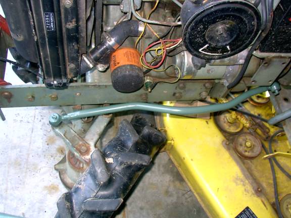

I attached a photo of the lengthened steering linkage to this post.

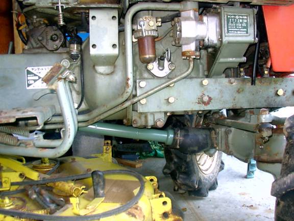

I lengthened the driveshaft, driveshaft cover, and steering linkage. Here's a photo of the driveshaft cover.

Here's a photo of the lengthened steering linkage. I'm embarrased to say that I haven't even started the tractor since making these modifications. I have no idea how this will effect the steering except that I know I won't be able to turn as tightly.
