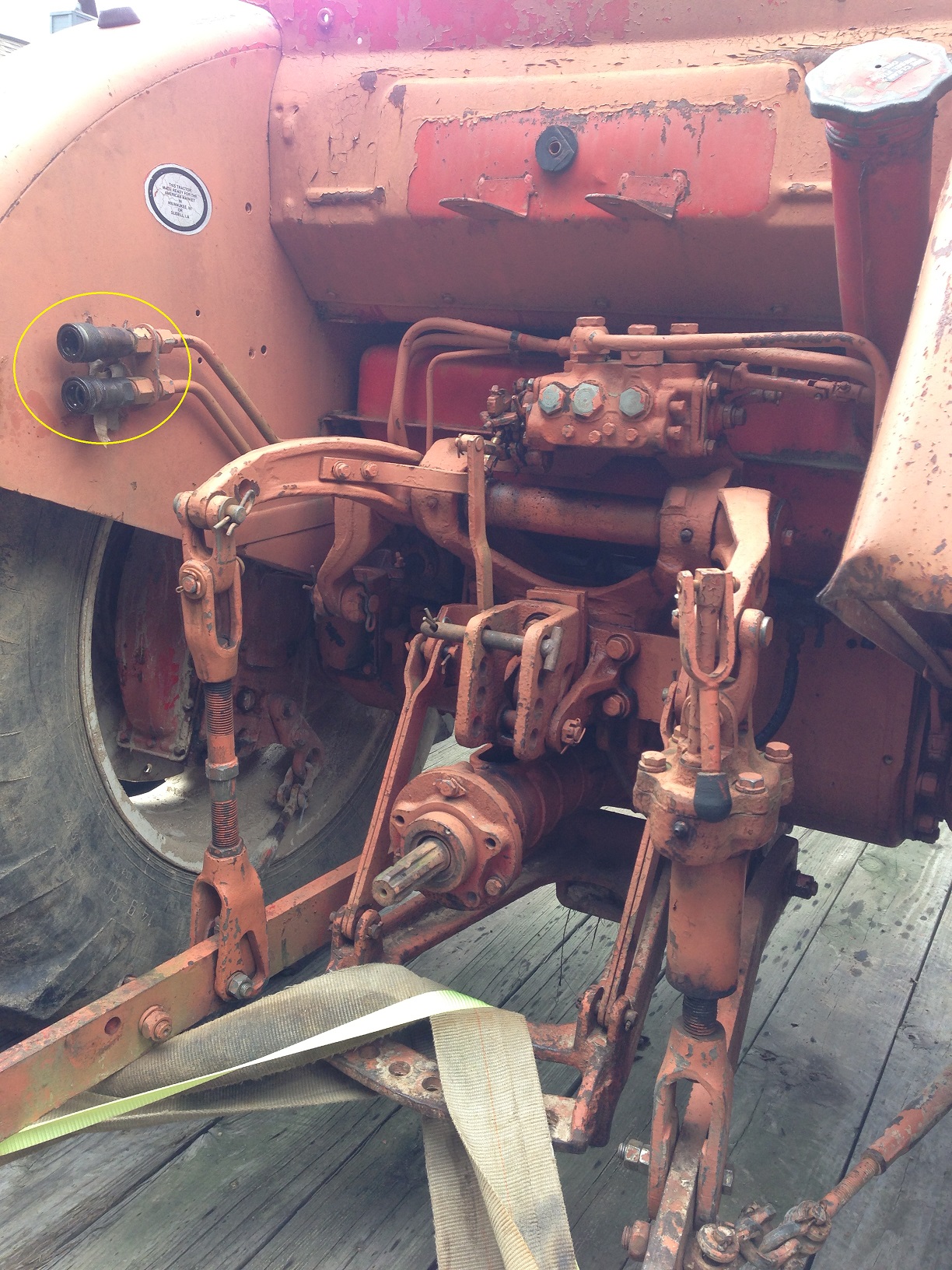

I'm purchasing a hydraulic toplink for my Belarus 400A tractor. I need to know the hydraulic connections prior to ordering. Does anyone know if these factory connections are 3/8" NPTF or SAE 8? I've included a picture to aid in an answer.

While the 2" dia unit will work for you, I highly recommend that you go with a 2 1/2" unit for your size tractor.

why would you recommend 2-1/2" diameter?

With the size-weight of your tractor, if you do any work in reverse, such as box blading, rear blade work etc, you can very easily bend the 1 3/16" dia rod that that unit has. :(
