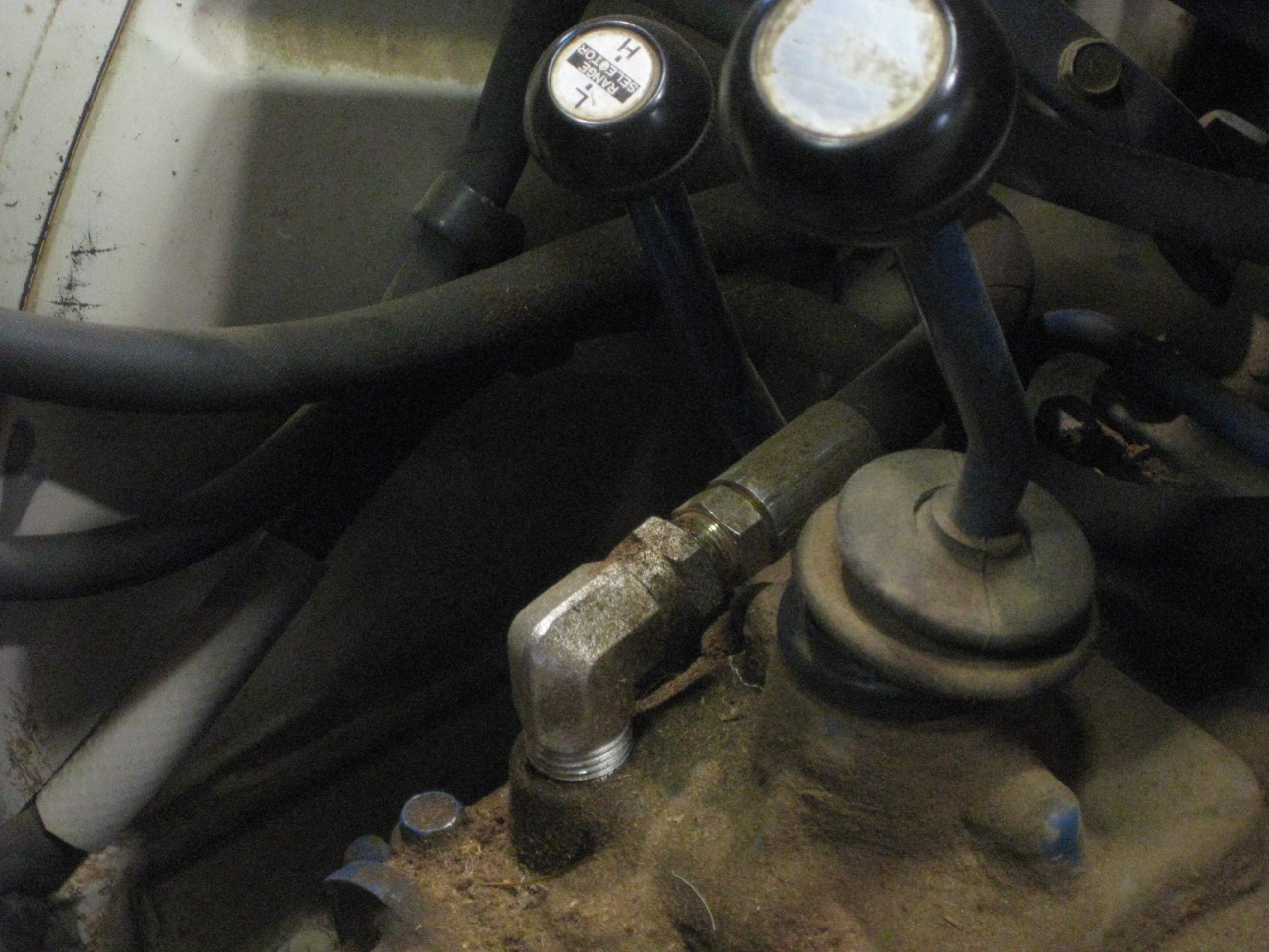

When you use Power Beyond sleeve the vlave requires another drain line to tank. The normal drain line is now supply oil to a valve down stream (3 pt). From teh tank fitting port (should be marked T) on the valve run it back to transmission case, possibly use the fill port or could Tee it into the inlet of the hydraulic gear pump if that has external plumbing.

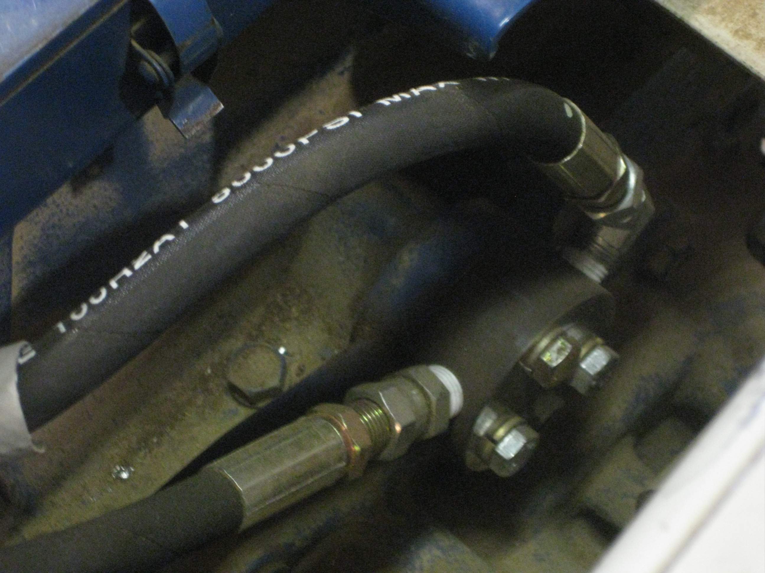

Check this thread, the OP posted up about his resolution which closely mimics the system used by my Blackhawk loader.
While it's not super clear, this picture shows how it was done.

Thanks, I'll see if maybe the fill port can be tapped and a fitting installed.

I tapped the fill hole for the transmission and installed a fitting for the return line from the valve. I'm going to change the transmission oil today and install the bucket. Had to swith a couple of lines around and need to reposition some but it is about ready to go. If you just cut the pressure line aren't you running system pressure through the return? I wasn't sure if that would work for long so I went the power beyond route. The block I made does the same thing only you don't have to cut the line, it just routes the fluid to the loader valve first and then back to the 3 pt. I'll try and post a picture later. Thanks.

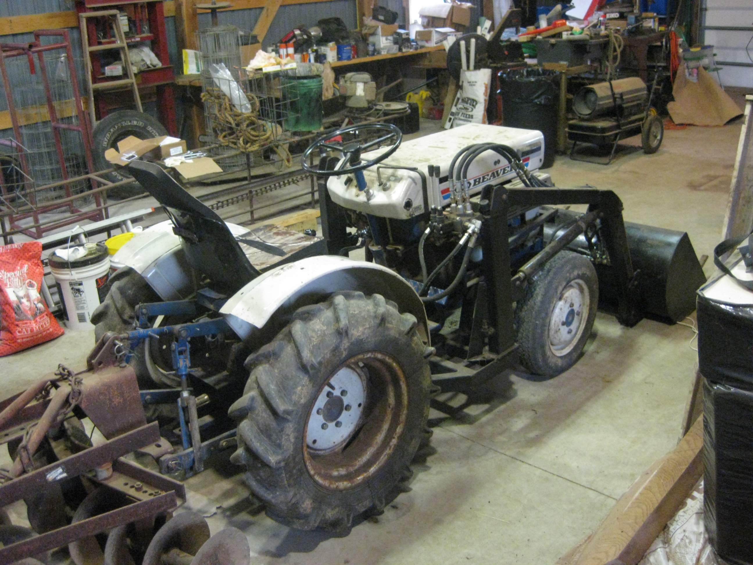

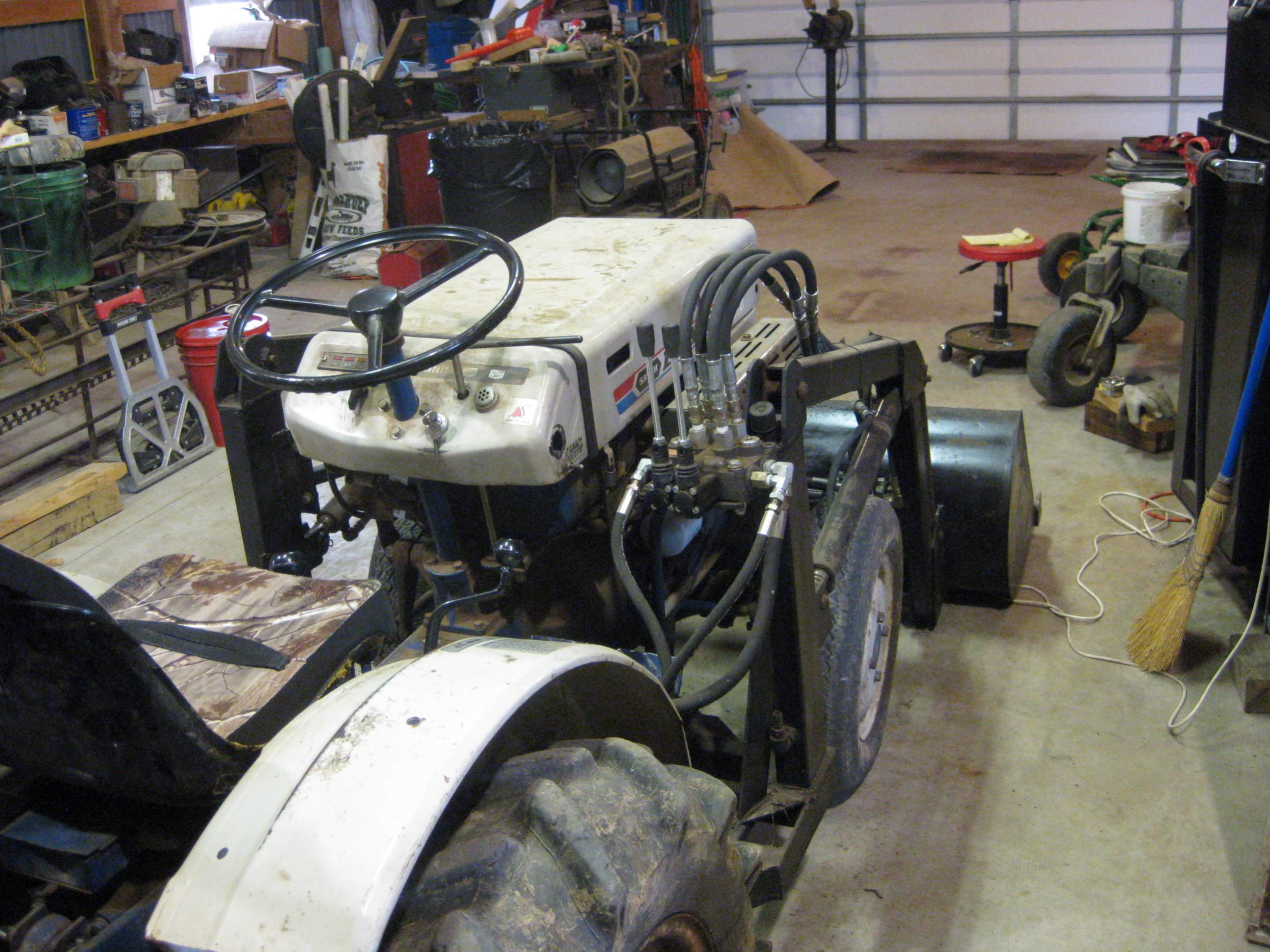

I finally got some pictures of the loader. Now if I can figure out how to put them on here.IMG_3759.jpgIMG_3761.jpgIMG_3764.jpgIMG_3765.jpgIMG_3762.jpg

BRNT, nice job.
I recently picked up an S370 for myself, it appears we have the same tractor. I'm hesitant to put a FEL on mine as I'm worried the little axles up front might snap and then I'd be up that infamous creek without said paddle. Any comments about how it works, how it feels, and how strong the tractor is with the FEL? Could you post the cost for the entire build? What brand of FEL did you start with and what parts did you have to make? I'll apologize if there is another thread alluding to all of this, and if there is, you can just point me to it.
/ Beaver loader
#11
I have seen pictures of several of them with loaders on them. If I were using it every day I might worry about the axels but most of the time it will sit in the garage. It is kind of like four wheel drive. You don't need it very often but when you do there is no substitute. I have about $1500 tied up in the build. It works really well. I cleaned the barn out about a month ago and it worked great. Sure beats a shovel and wheel barrow. The loader was a Johnson. I'm not sure what it was suppose to fit. I had to mgf. the front mounts and the block for the hydraulics. I also had all of the lines manufactured. After I got it mounted up I discovered that the uprights were to far back on the frame so I had to cut them off and move them forward after welding in some new bracing for them to sit on. I also made a brace to go from the uprights to the front of the tractor to add some stability and keep the uprights from trying to work back and forth. You don't want to try and pick a load up very high without some sort of ballast on the back. I was moving some gravel today and nearly tipped it over. I had taken the disc off and didn't put the grader box back on. I may have to make a ballast box in the future. I hope this has helped you out.
