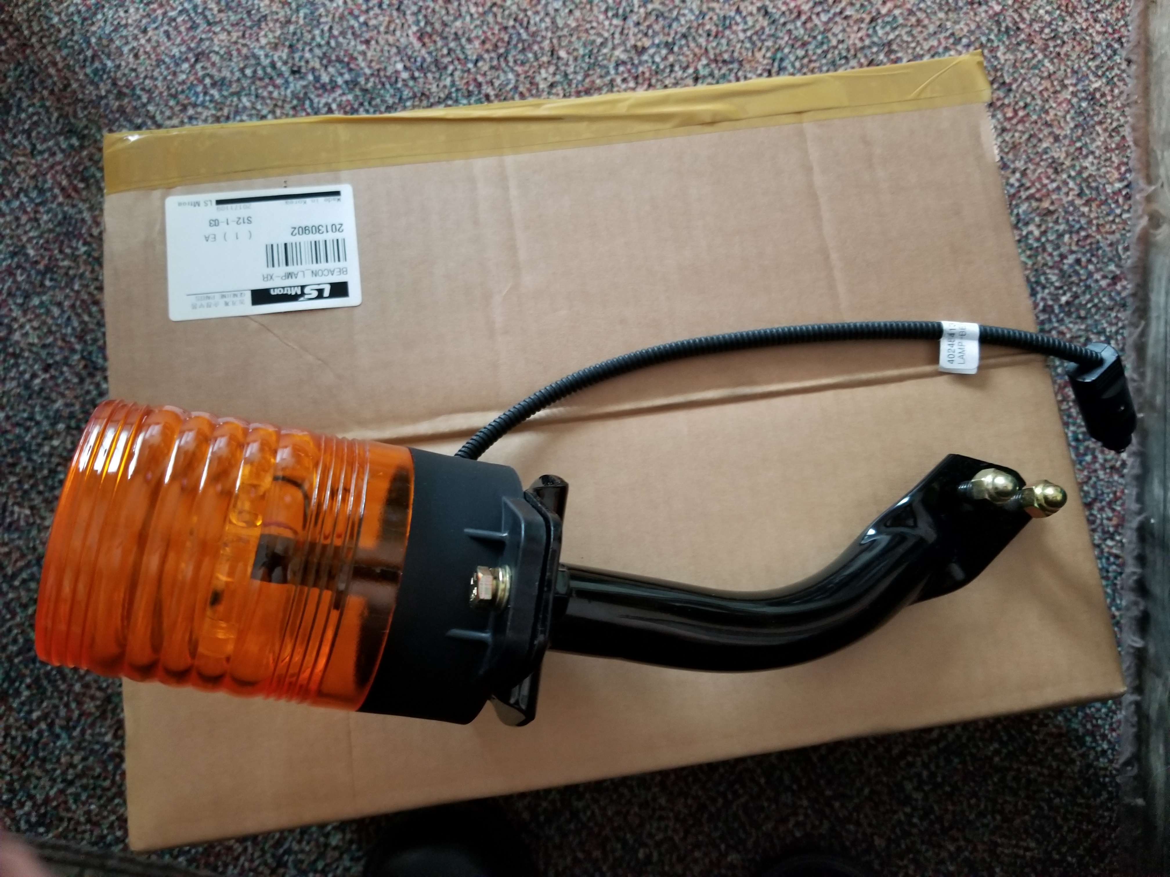

Bracket is why I did and it’s prewired. I’m in a busy highway blowing snow and I don’t want some ambulance chasing lawyer saying he couldn’t see me.
Thanks. That makes perfect sense. The mounting arm looks pretty skookum and much nicer than anything I could cobble together.

I didn't buy the factory strobes because they look like they would stick up too far and easily get caught on tree branches snapping them off. I also want to be seen when out by or on the road so I bought the low profile magnetic strobe and only had to fab a metal bracket to the cab roof to stick it on. I fed the wire in through the back right window and plug into the cig lighter plug. I haven't seen any posts from anyone that has broken a factory strobe yet but can see it happening.

When I get back home Tuesday I’ll take some pictures. Like was stated previously it only sticks above the roof about a inch. I also mounted strobes under my front cab lights to be seen from front visibly.

Bracket is why I did and it痴 prewired. I知 in a busy highway blowing snow and I don稚 want some ambulance chasing lawyer saying he couldn稚 see me.
For those interested, my dealer has just the mount for the light for $25. Then just add a less expensive light.
For those getting the plug, your going to want a 90 degree low profile one otherwise you won't be able to open your rear side window. (At least on the 3135)

Truth be told the light is garbage but the way the mount is built unless you find a light with same footprint it’s not going to mount without modifications.
