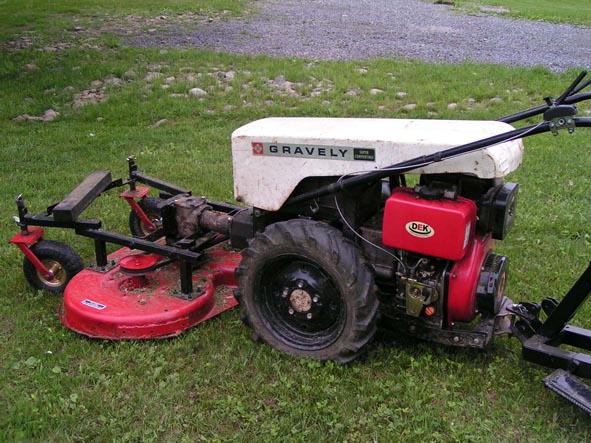

Hi .For mowing or snowblowing Gravely are a lot better than any BCS or Grillo Because Gravely PTO are LIVE and with two speeds one for each gear.
Transmission with planetary and bands as automatic give a true shuttle you can go front and reverse with no clutch. You can go in first gear then go in second with no clutch and no stop.
BCS and Grillo are a lot better for gardening. more speeds adjustable wheels handlebar can move on side. And now are more versatile because more implements and parts available.

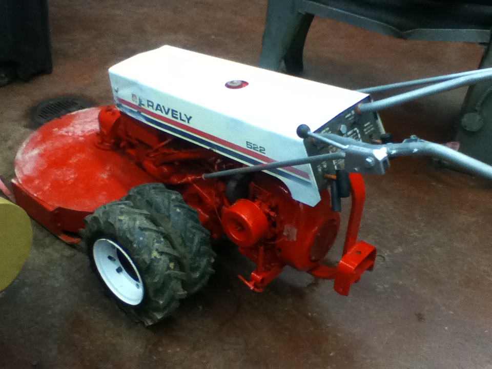

Heres my Gravely 522 that I'm going to overhaul the engine. I ordered the engine kit on ebay last week.
