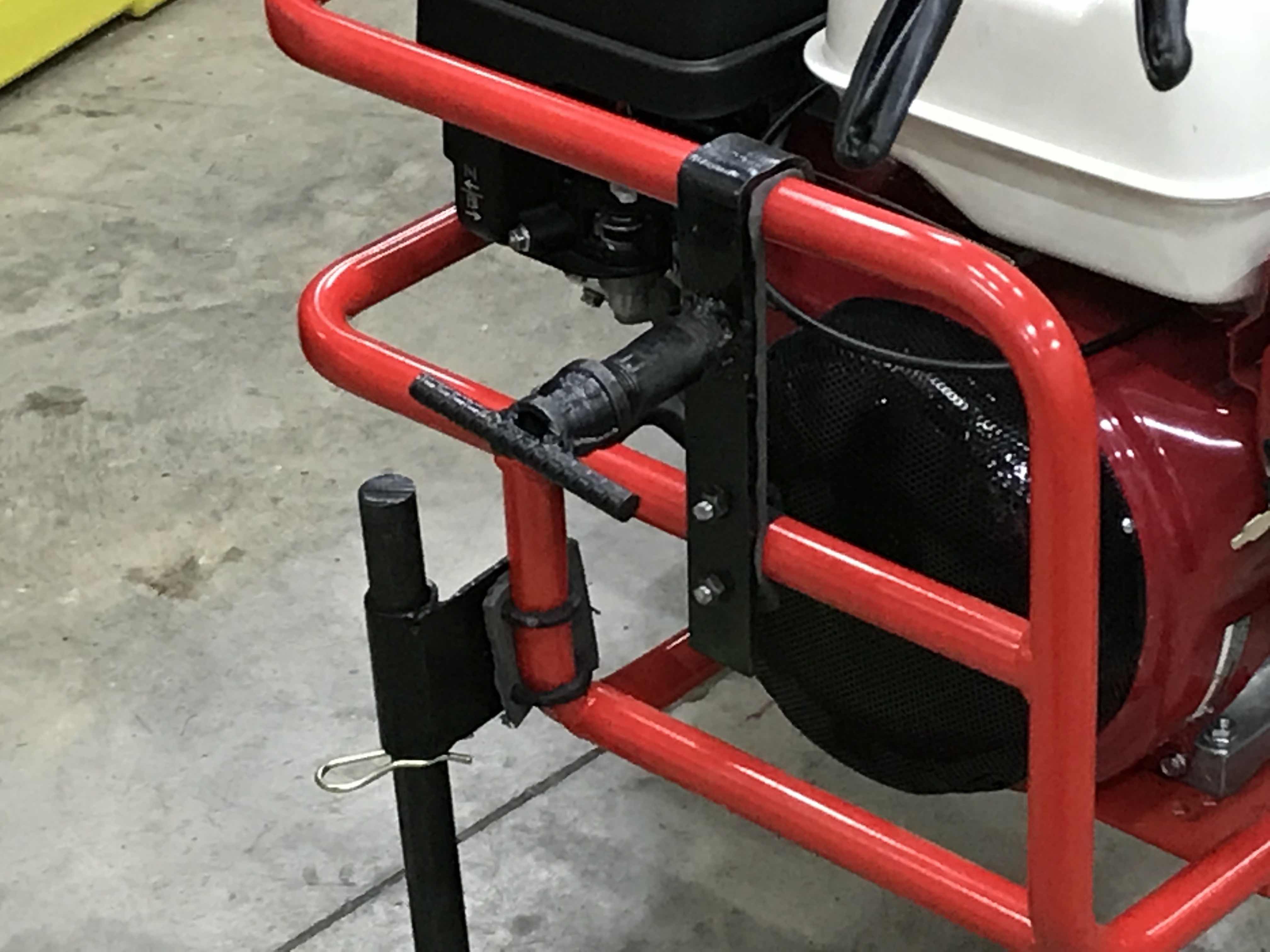

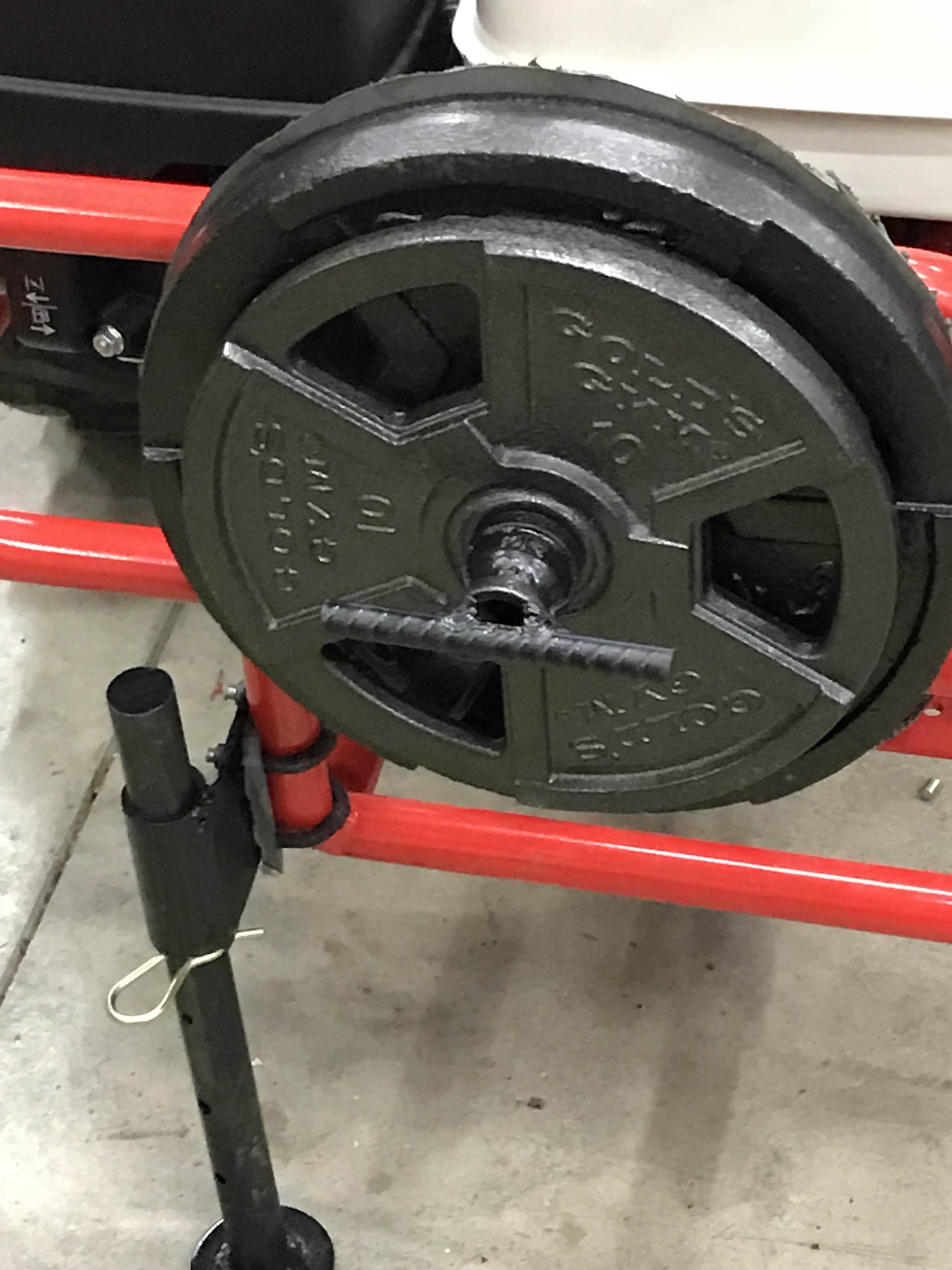

/ BCS 853 ordered! #7
I needed to add some weight to my machine as well. I just made a bracket and welded a threaded pipe on it then used a pipe cap with a bar welded on it to hold the weights on. Cost next to nothing and works pretty good for a quick adjustable system (you will find you want to weight each attachment slightly differently to get the right balance)

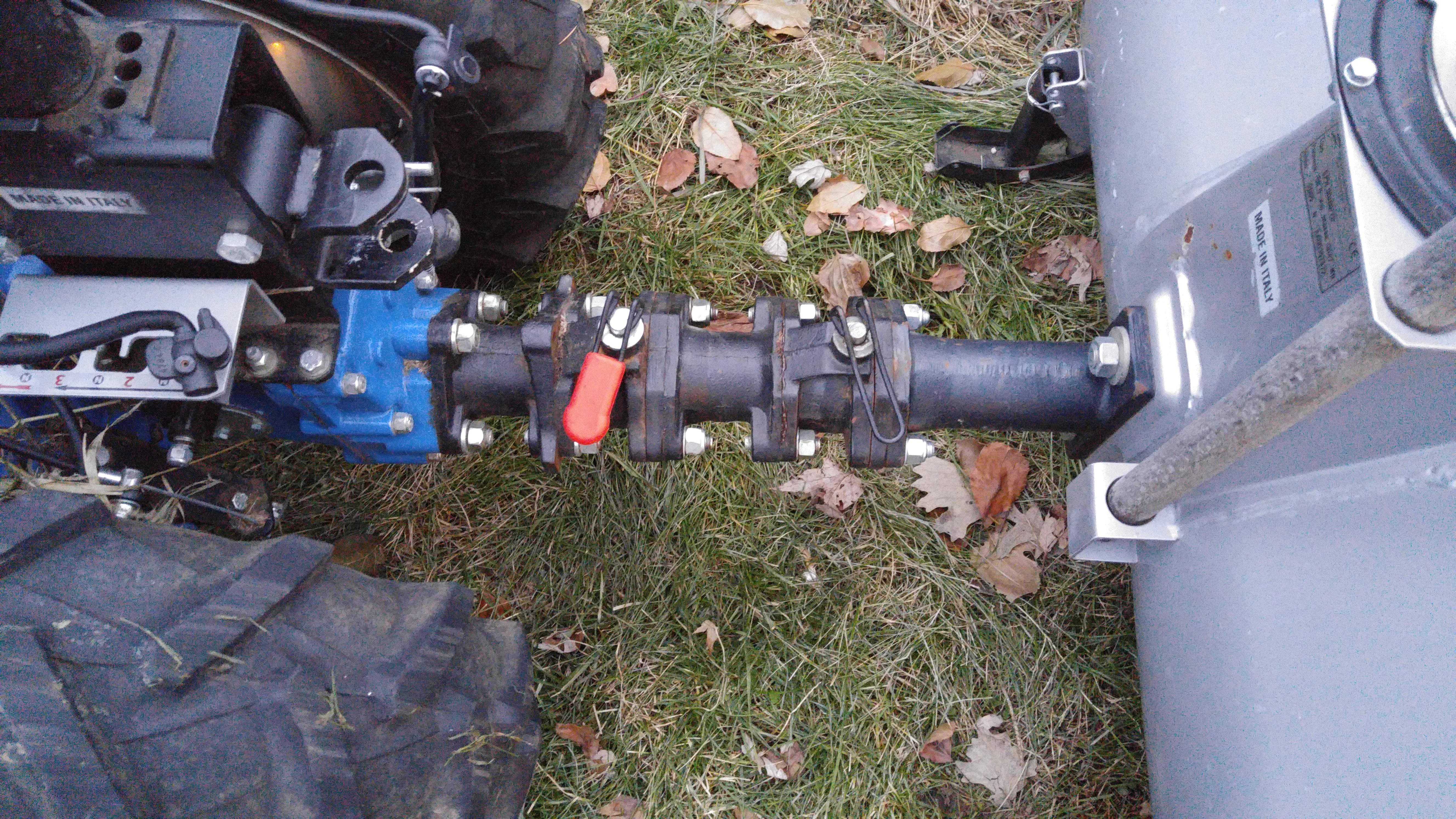

/ BCS 853 ordered! #8
I like your weight adapter, as well as the kick stand, but I need rear weights. The 948 has stock weights just behind the engine, so it is very front heavy. The 34" tiller requires a 3" extension to be balanced, bolted to the extension (there's no 3-bolt quick hitch). I've added a quick coupling onto the extension to use my other implements, but it is too front heavy. I went to use my snow thrower, and added a second 3" extension with both male and female quick hitches, and it was just to the point where the snow thrower would stay on the ground. I'm going to try j-bolting some weight to the tow hitch.
/ BCS 853 ordered! #9
I couldn't figure out how to send the pic when I posted the previous message. The snow thrower is pretty much neutral with this much extension. I don't want to take the weights off from behind the engine if I don't have to. Joel @ Earth Tools told me the 750 had the weights redesigned and they're not as much of a PIA.
/ BCS 853 ordered! #10
Wow, sure looks like a lot of torque on those cast flanges. Does BCS recommend that much of an extension?
/ BCS 853 ordered! #11
I haven't used it in that manner. I was trying to see how much I needed to get the snow thrower down from the clouds.
/ BCS 853 ordered!
#12
I would not use it in that manner. The further the leverage point from the axle pivot you get, the less added weight is needed to counterbalance implement. I have seen some YouTube 2 wheel tractor videos with long extensions built onto opposite ends from implement to accept weights, but they only had like 20 lbs on it due to effective leverage. You could fab some thing like that up. Also, if you need the implements closer to the ground, shorter tires may be best solution.
That's nice. Ive been thinking about doing something similar on my 853. It seems like it would help with the stump grinder attachment that I have(very heavy).
/ BCS 853 ordered! #15
Thanks - really helps me get the right balance for the different implements and makes them much easier to use or transport.
