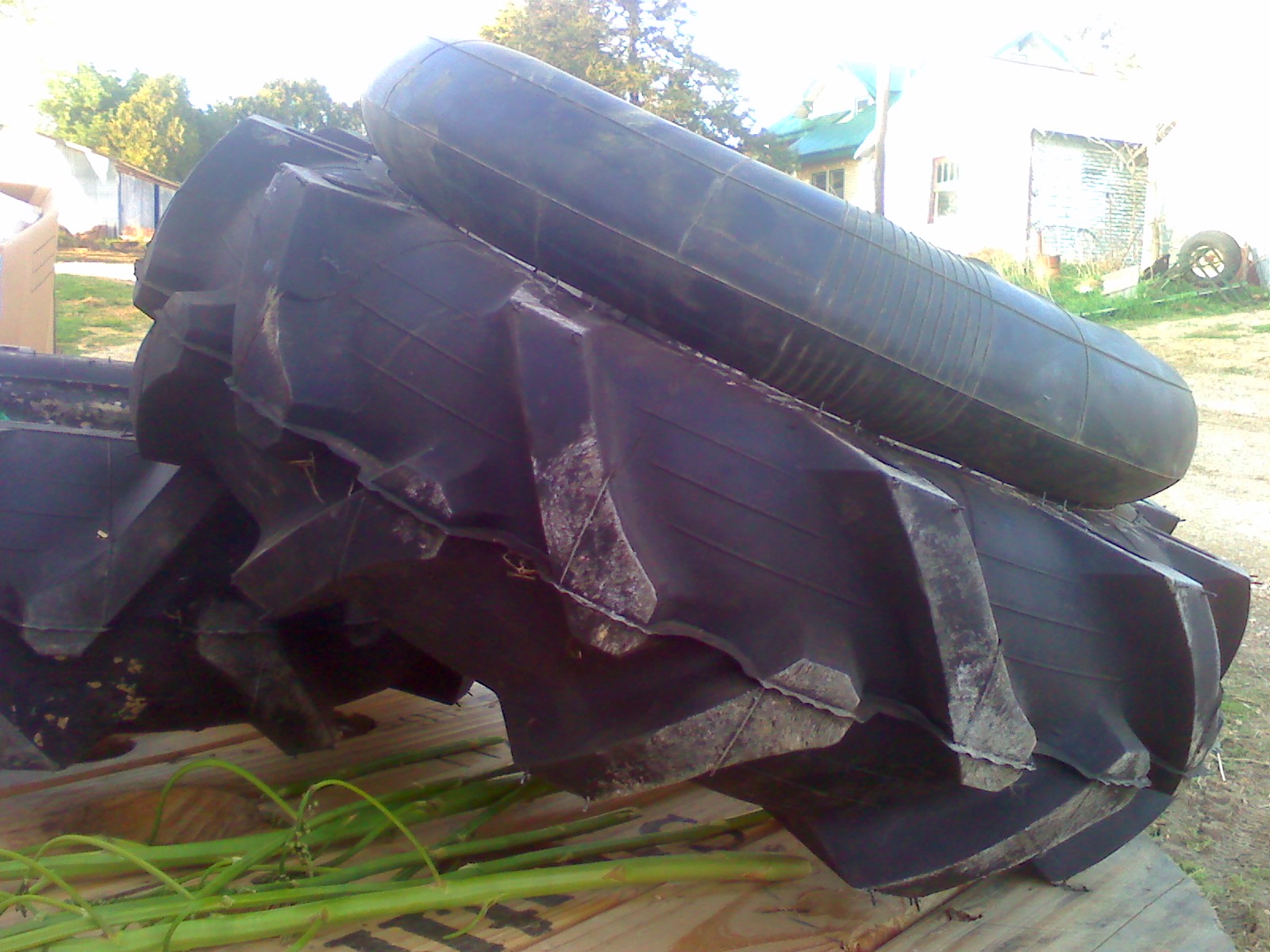

Here's pics of the tube you'll get. Yeah, it's that small...

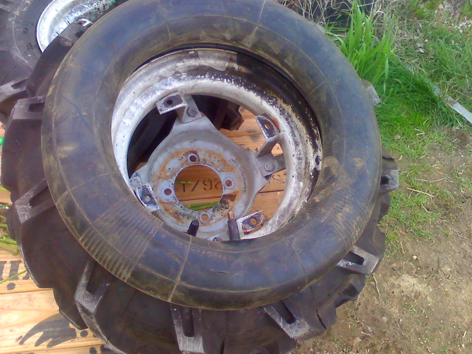

The other pic shows a set of BCS tires I just made tubeless. The valve stem did NOT like the hole in the rim. It's drilled too close to the innermost part and it doesn't have much of a chance to seat. If you wiggle the stem, you can hear air escaping, but no air escapes if you leave it alone. I slimed the insides of the tire and especially the stem and it seems to have helped. We'll see how it goes.
The reason the rims look bad is they went through a fire, along with the 735 that they were on. The Acme engine was completely cooked in the fire, as were the tires and most of the cables. I pulled the Acme, mounted Kohler Magnum, changed the fluids, mounted different tires (4-10s), and had a running machine again. These tires will now go back on it. I also have an Acme Diesel that will go on it very soon. BCS and Grillo tractors sure are tough!
