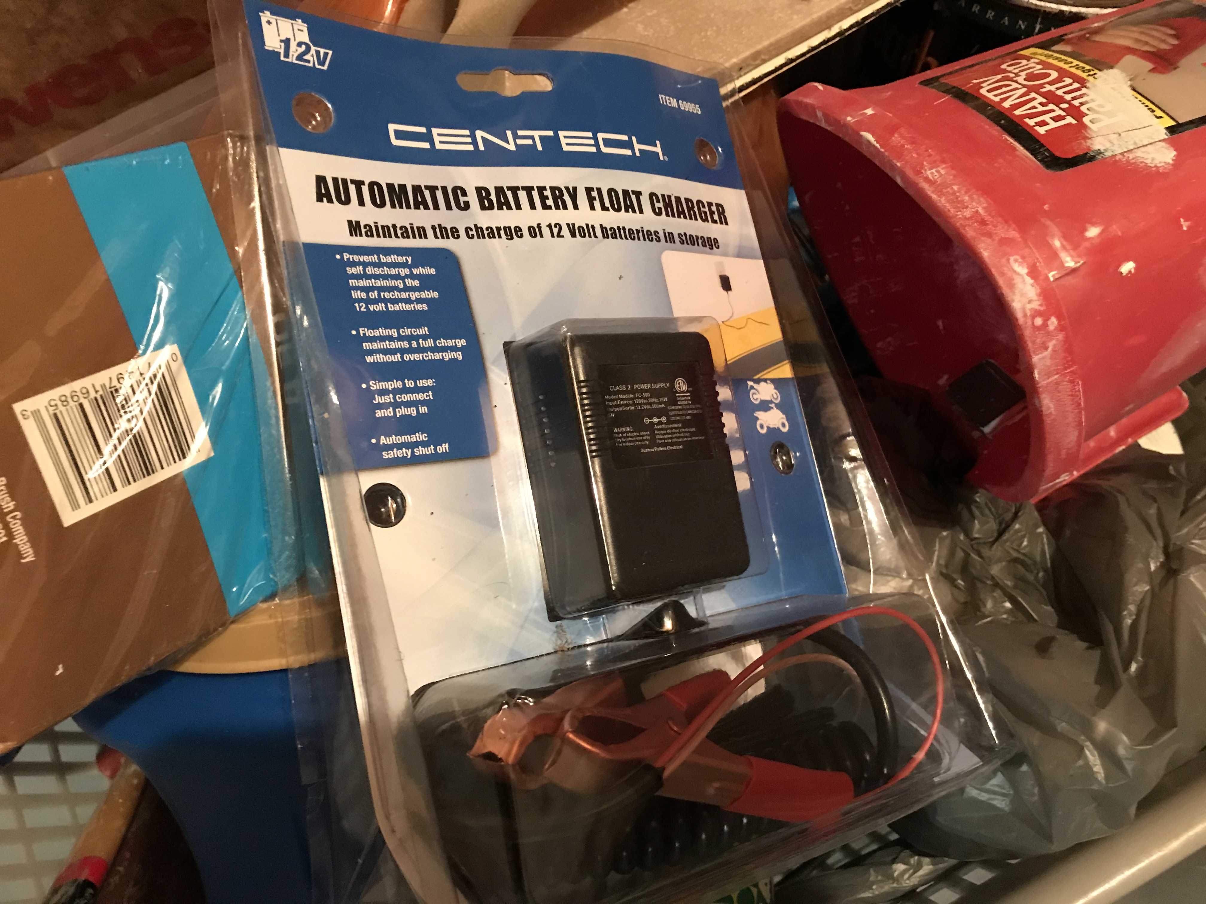

I have a solution.
Send it to me!
I looked at it tonight nestled there in a basket with some painting stuff. A Harbor Freight unit. My guess is that I picked it up for a small plating or electrolysis cleaning experiment that never happened. It was probably a coupon special at half off the $9.99 price, so the postage would cost more than the charger:) I could mail you five bucks and you could watch for a HF sale?

/ Battery Tenders #123
Actually the $5 HF charger is what I put on the tractor described above (where the Battery Minder had died) overnight. 10 minutes after detaching it I measured over 13 volts, so reading it several hours later will hopefully show its fully charged.
I learned a couple of batteries back that you can't leave these on all winter. It cooked out enough water to damage that battery. I suppose a week would be harmless. But after using this cheapest charger for a while, check the water level.
Thanks,..... but no thanks!
I misunderstood what you have.
Plus, I was kidding about "send it to me".
I don't buy, or use, electrical stuff from HF

1. You're welcome
2. Didn't try to misrepresent it
3. I was kidding about sending it
4. As evidenced by the picture, I did buy something electrical at HF. However, judging from how long it's been languishing in the original package, it doesn't look like I use their stuff either
