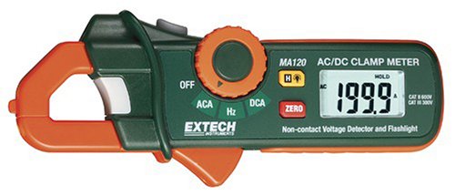

One of the tools I find very handy when working on anything electrical, Home or on vehicles.. simple amp clamp, shows charging amps of an Alt by clamping on Positive battery cable or alternator "+" cable. This and a digital volt meter tells you a lot of information about the electrical system. MA120 is only rated for 200 amps AC or DC, and it is small enough to get into tight places, much smaller than the big 400 amp style.
Bought mine from amazon... about 75.00
Amazon.com: Extech MA120 200 Ampere AC/DC Mini Clamp on Current Detector: Home Improvement
